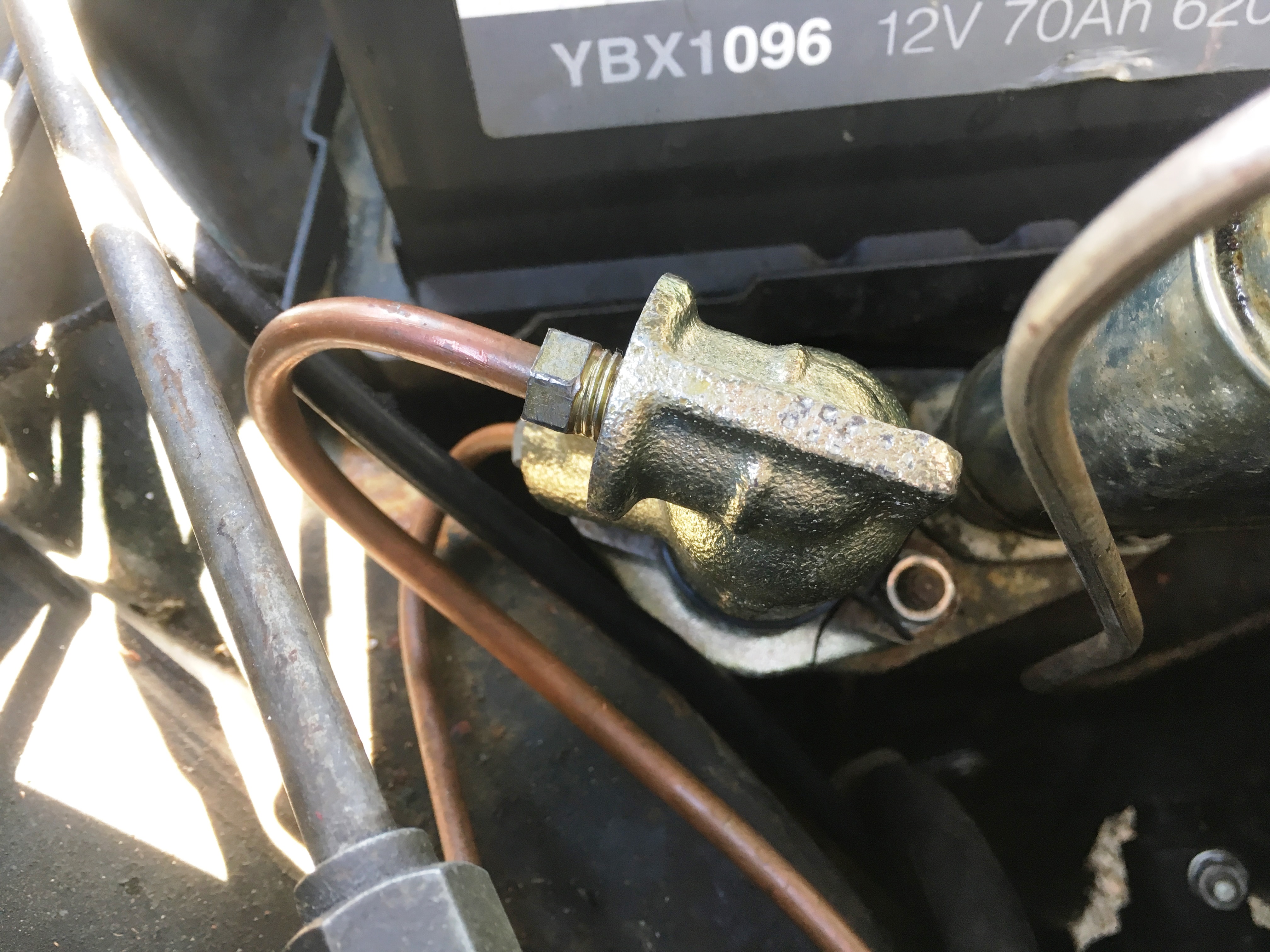

Had a certain Mk2 arrive a week ago for a service, and checkup.
From what I can see the car was restored I am guessing in the 90's and upgraded from a 240 to a 340 but with wide bumpers.
Whoever did the restoration did not do a bad job in fact, the car is a little of a Frankenstein as it has the 240 carbs, 340 engine, Mk2 bumpers, 3.8 Mk2 air filter, later brake servo with built in air valve, XJ6 power steering conversion etc., but everything works and it is a reasonable driver.
Sleddy reported some issues with the brakes, I had initially mentally ruled out the master cylinder as it was new, but on further investigation found that the body of the master cylinder is cracked, the cylinder actually moves sideways when the brake is applied as it is only held by one bolt, and there is a distinct jump in the pedal which seems to be something binding within the master cylinder. It looks like the cylinder was broken when it was fitted, probably didn't sit square, was bolted up hard and viola!
This will need replacing and then further testing of the barking system to ensure it is all up to scratch.

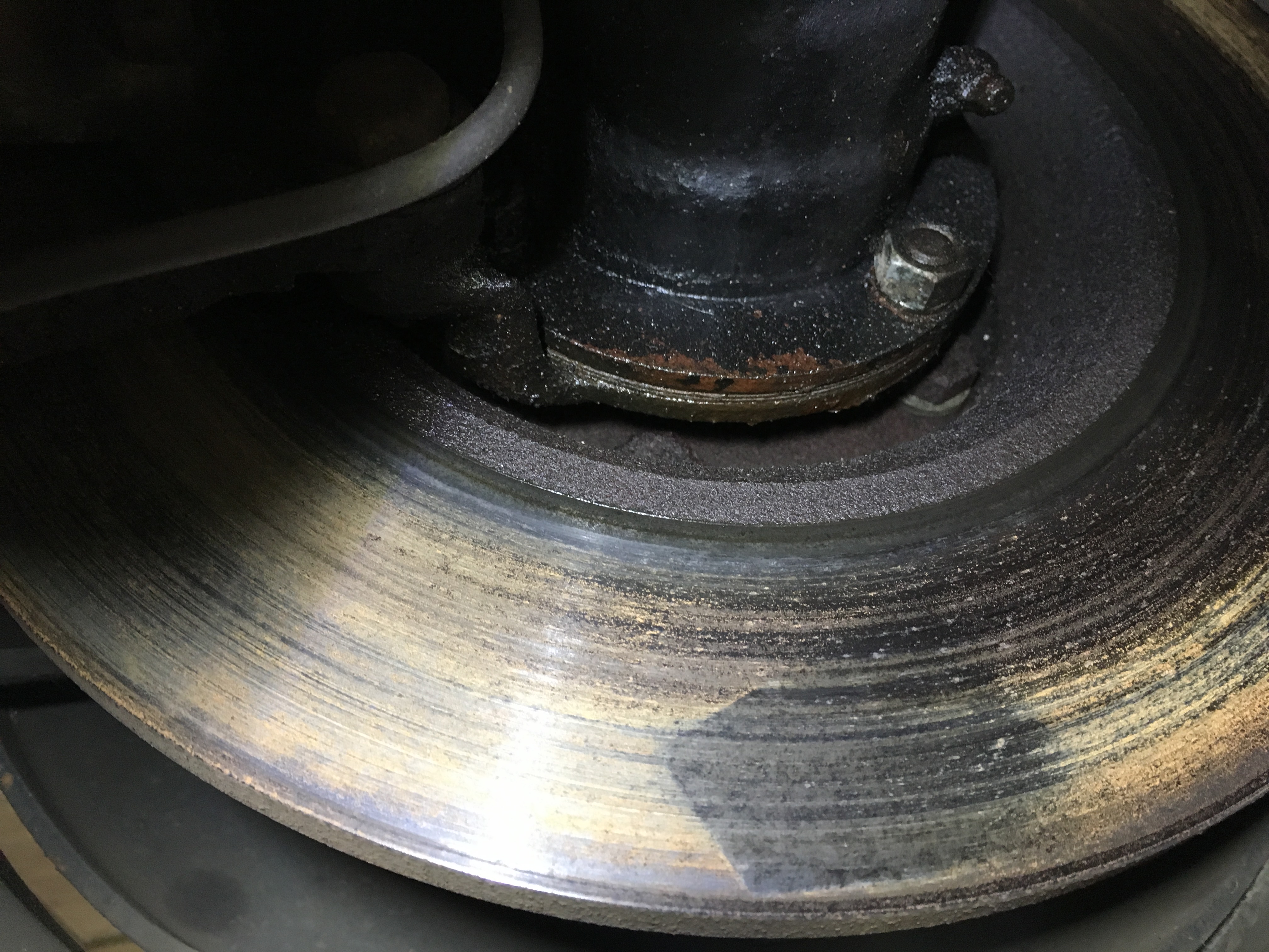

The London garage had apparently recommended/quoted to upgrade the brakes to 4 pot, not sure this is required !! See pics.

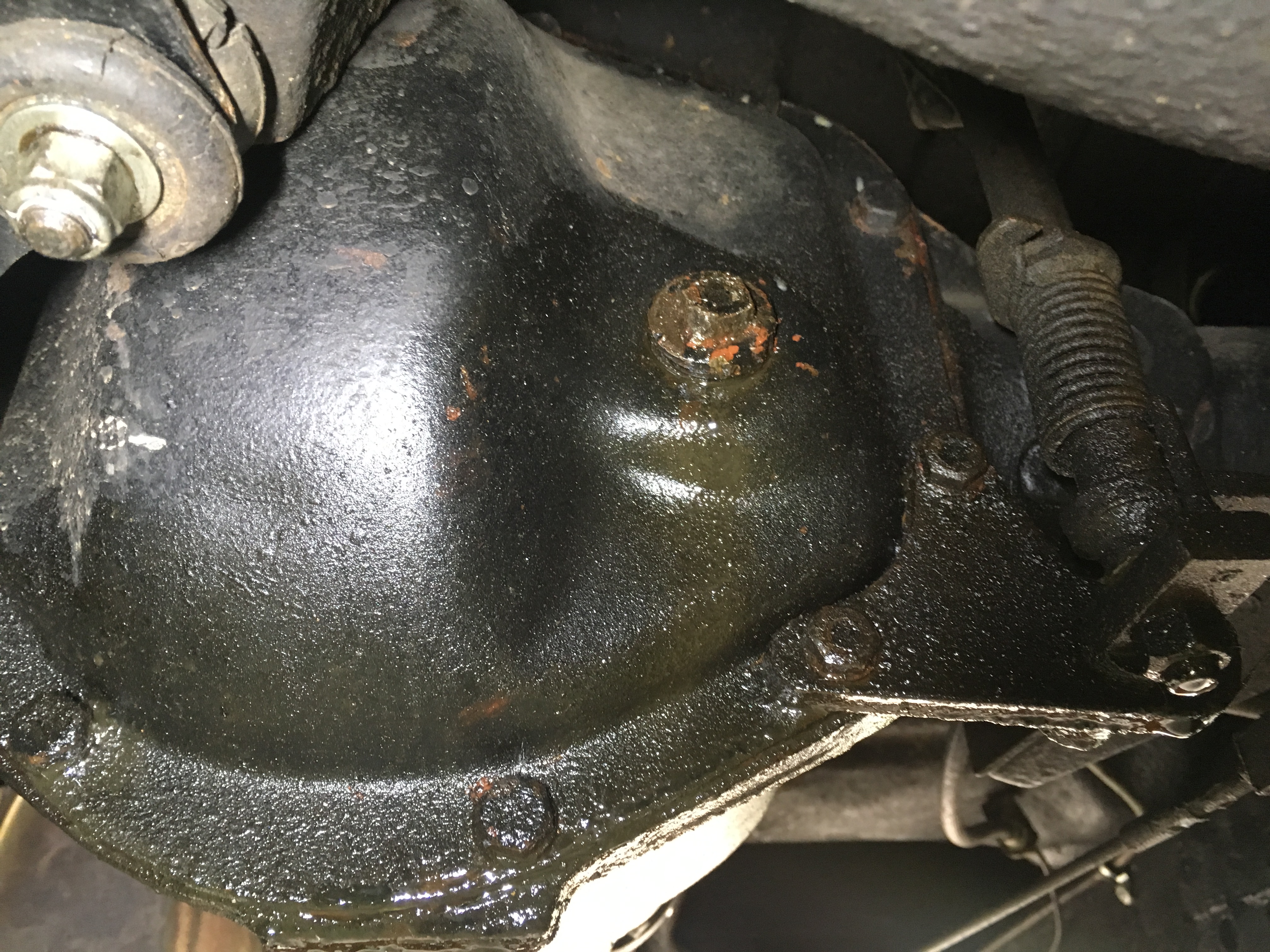

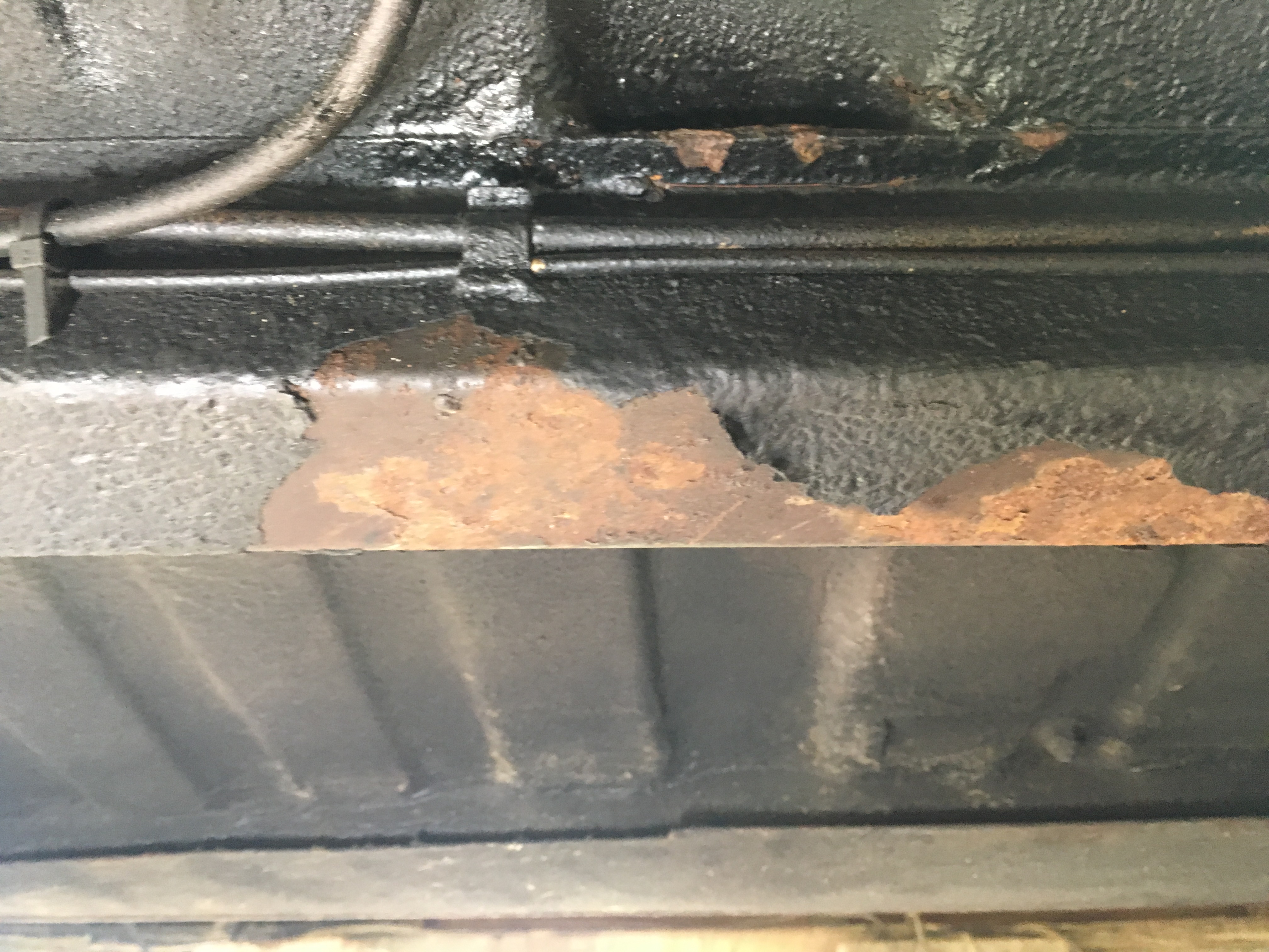

Rear hub seals are leaking, as is the diff filler as you will see from the pictures. There is also some early corrosion which will be addressed to keep this in check. The Cills have had over cills fitted and all the access holes have been welded up / covered over, so these will be opened and a boroscope inserted to check the condition of the cill internally.
Putting repair cills over the existing is not something I would advocate as this can cause greater issues along the way, hopefully there will be nothing horrible inside the cills, and this can be monitored with corrosion protection to stop the rust bugs getting hold.

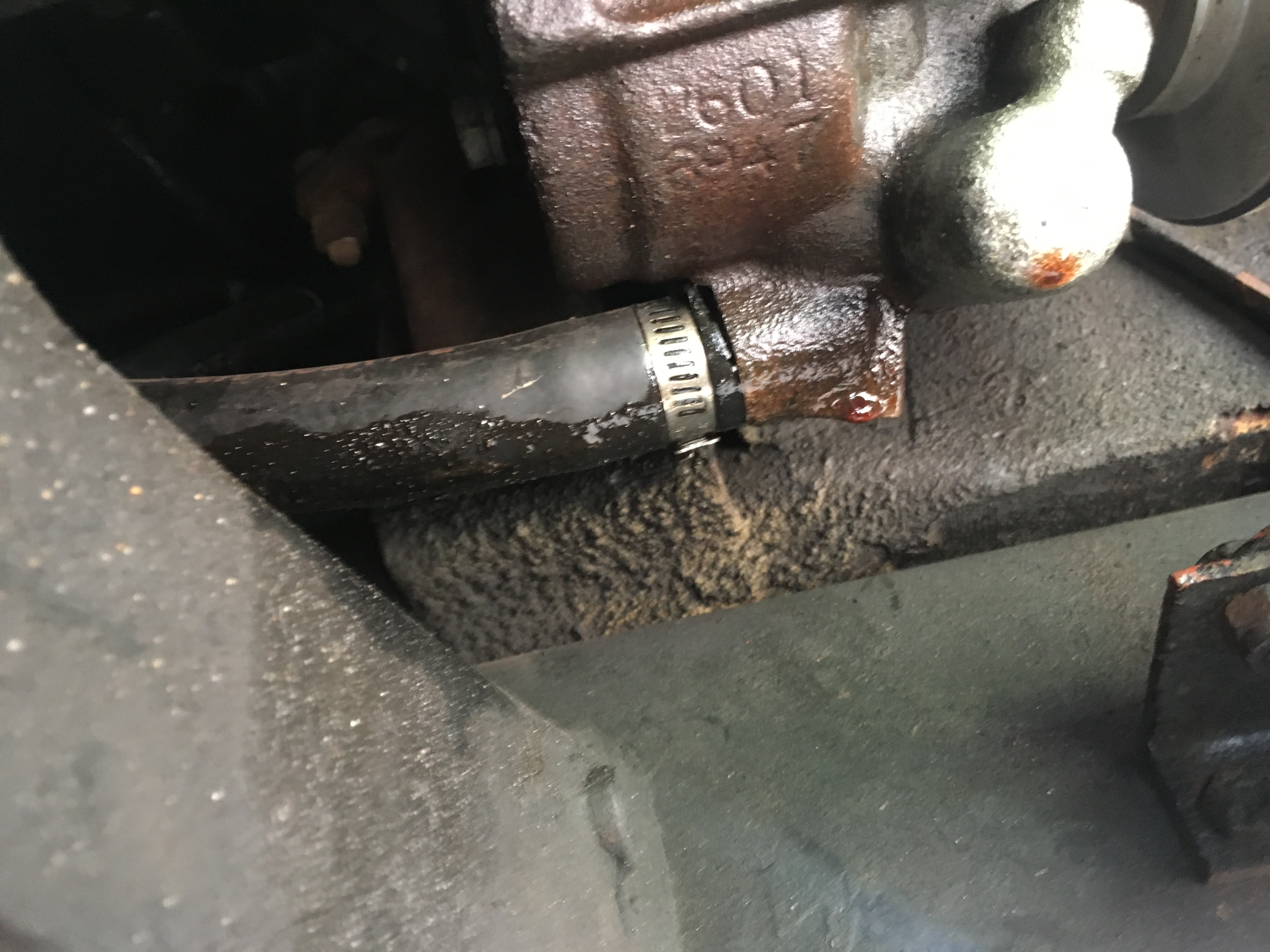

There is a small leak on the power steering pump probably due to a low quality hose clamp, so this will be addressed.

Many thanks Jon for the very detailed reply. There's clearly a serious issue with that master cylinder. However, from memory this has been replaced a couple of times already; on each occasion it only goes part way to fixing the brakes. I'm beginning to wonder if the problem may lie in Frankenjag's unusual history ie a mismatch or time lapse between some of its braking components. Looking forward to your prognosis.
Old Jun 9, 2018 | 12:00 PM
TilleyJon's Avatar
Joined: Jun 2016
Posts: 1,656
Likes: 438
From: Bath UK
I will thoroughly look through the braking system and see if I can understand why the master cylinders have been failing, there may be a parts mismatch, I will see if there are any differences in the 240 / 340 pedal box, but I doubt that, maybe it's the wrong master cylinder ?
Many questions, hopefully I will come up with the answers too.
Old Jun 9, 2018 | 12:20 PM
TilleyJon's Avatar
Joined: Jun 2016
Posts: 1,656
Likes: 438
From: Bath UK
Just cross referenced the parts books, and the 240 and 340 share the same pedal housing and master cylinders, but have realised that the spacer is missing, that maybe why the cylinder does not sit correctly, and the cylinder may well be bottoming out at full pedal travel or earlier and damaging the master cylinder.
I will fit a new spacer with the new cylinder and see how it starts to fair from there.
