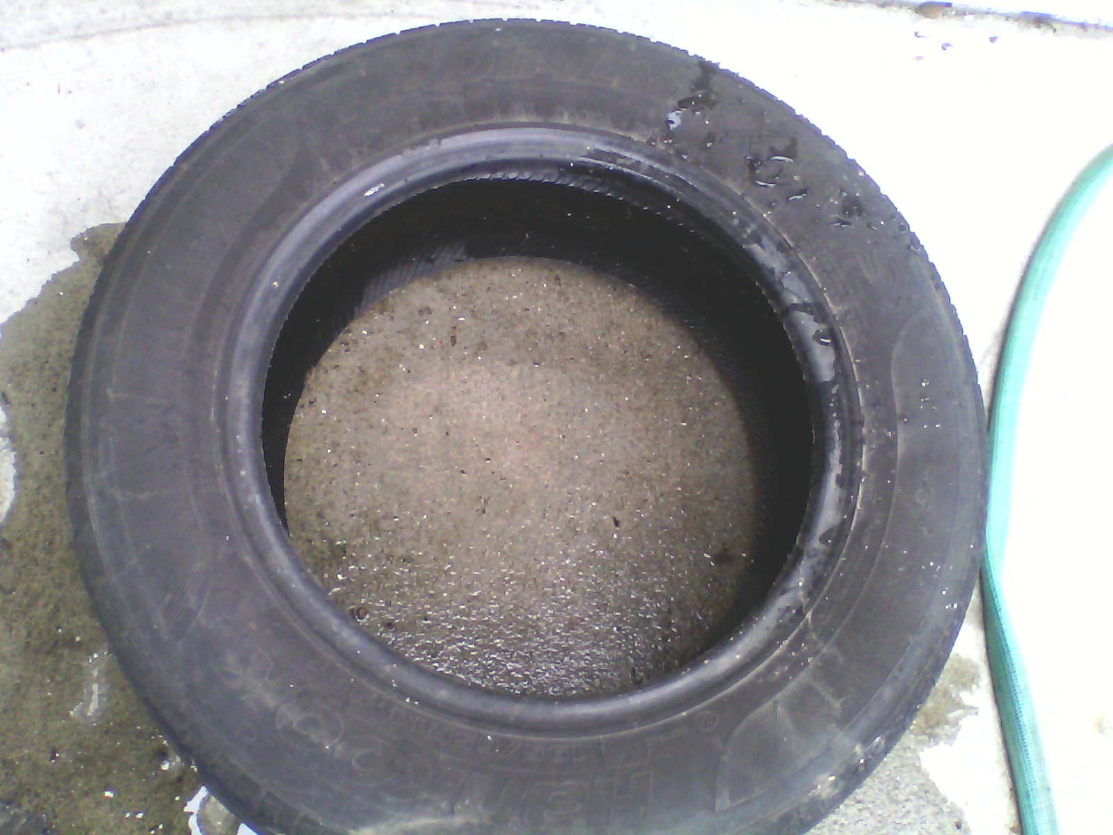

Redundant, I know. But I do enjoy experimenting and seeing what results may be had.
Hence, Part Two.

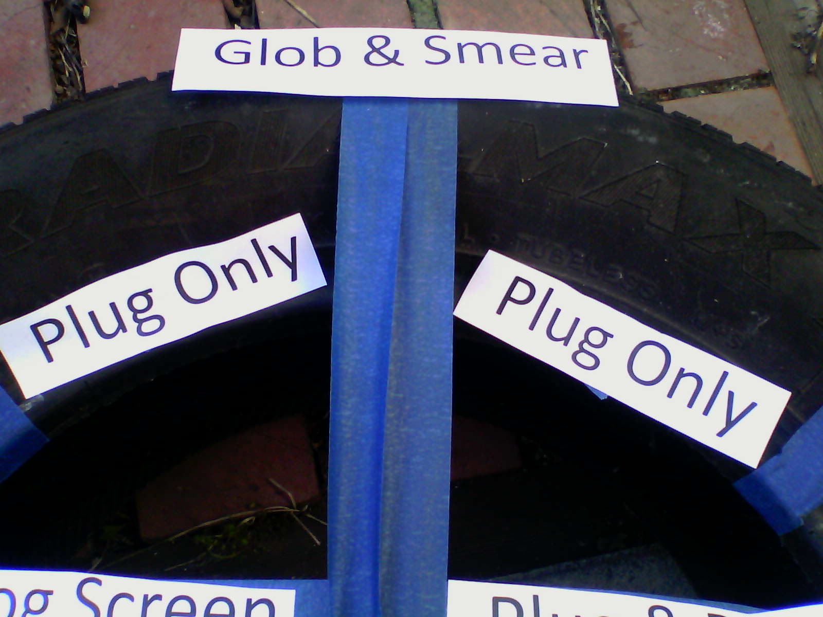

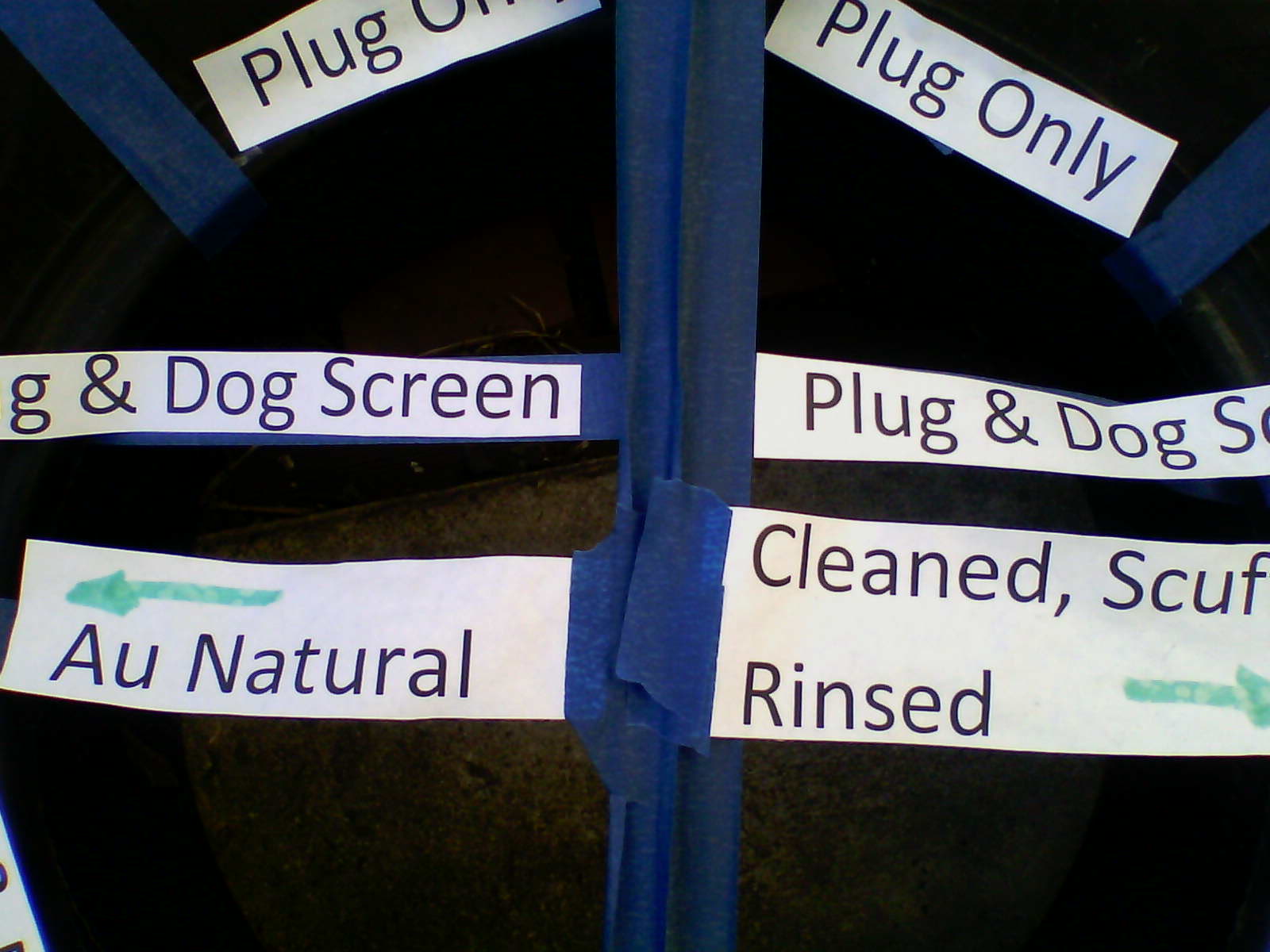

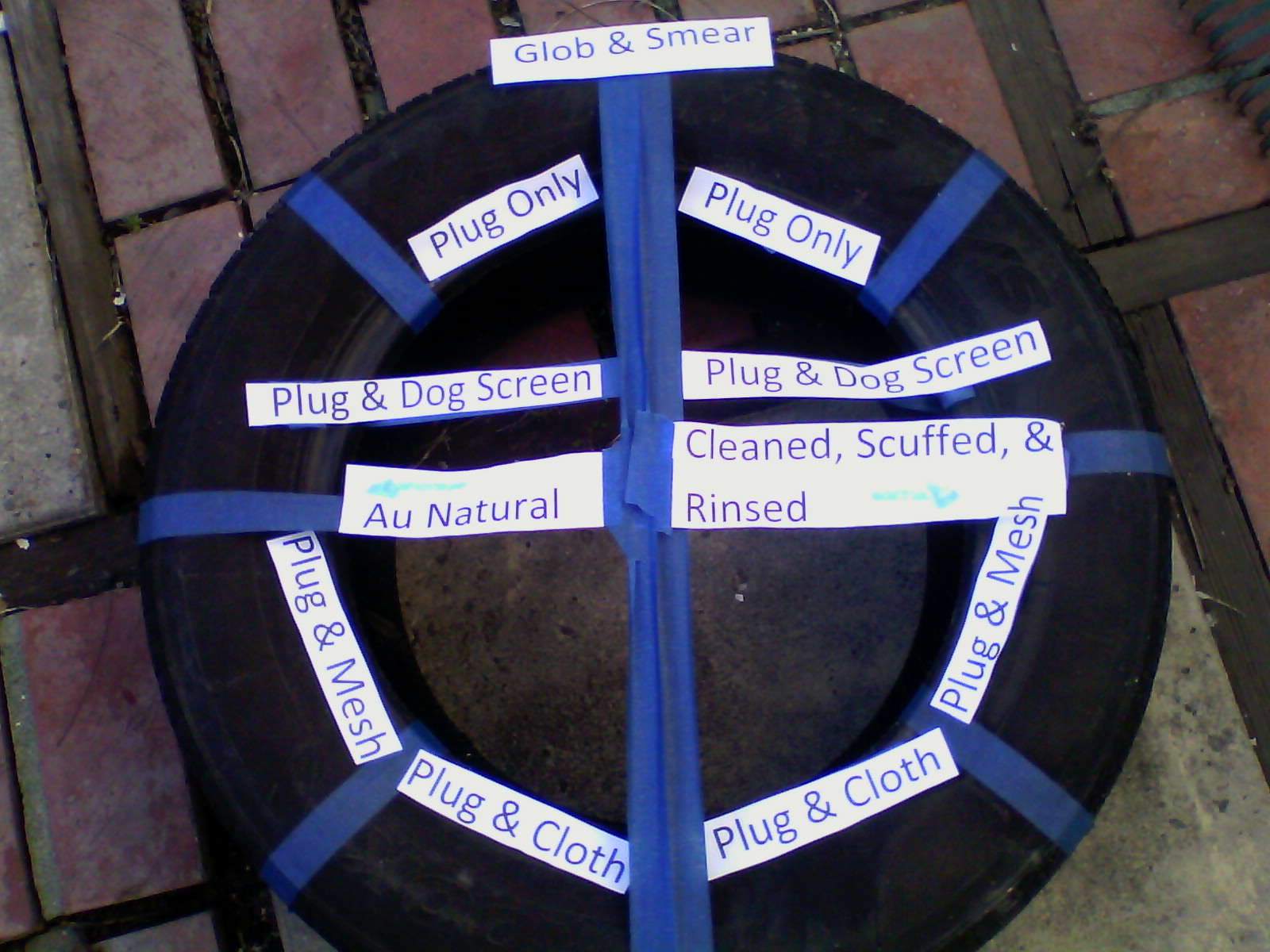

So I got an old tire that was laying about.
The tire was divided into two sides: Au Natural and Clean/Scuffed/Rinsed.
In an emergency, one probably won't be able to clean with soap, dry, scuff, wipe, and rinse a tire.
( Variable Note: the tire was a bit dusty and had some brake power on the sidewalls. But the tire did NOT have road grim on it consistent with a tire in daily use.)
Next, each side was sub-divided into sections: Plug Only, Plug & Dog Screen, Plug & Cloth, Plug & Fiberglass Mesh.
The DogScreen comes from the hardware store and is used on screen doors to inhibit dogs from plowing thru the screendoor and/or scratching thru the normal, thin metal mesh.
The Cloth and the Fiberglass came from extra roofing material I had available.
All are flexible, durable, and will not tear with out great, great effort.

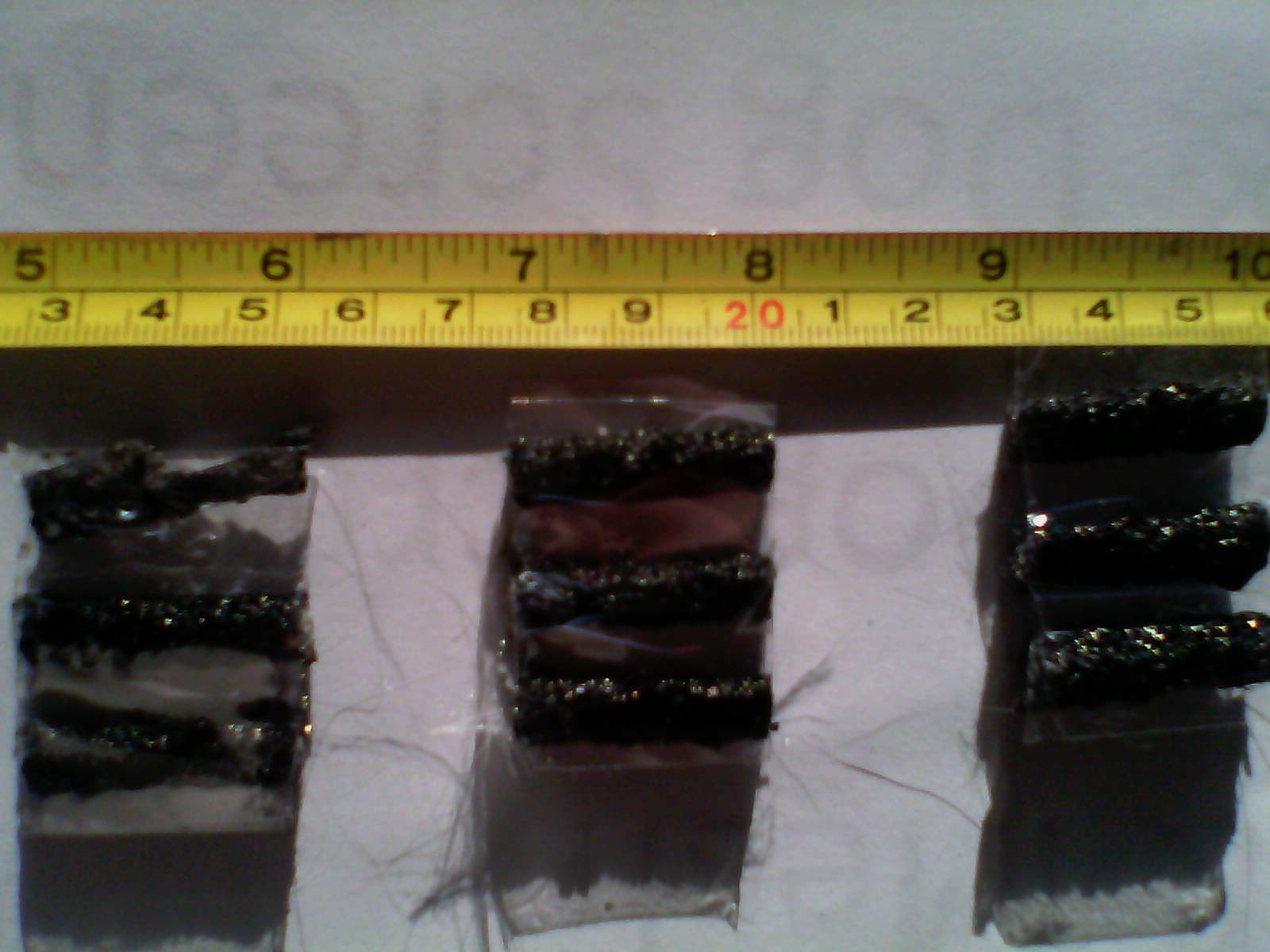

I finally finished this part two experiment, and the results were rather encouraging....
In addition to just the JB Plastic bonder alone, three other materials were used for reinforcement with the plug pieces: a fiberglass, a cloth for roofing, and screendoor mesh.
First, eight one inch plugs were coated with the plastic bonder, and inserted into the eight separated gashes mad in the tire.
All the different material pieces were cut into segments of two inches by one inch and placed over the plugs with a cof the plastic bonder.
The fiberglass almost disintegrated completely with the plastic bonder coating, This covered the entire plug and
