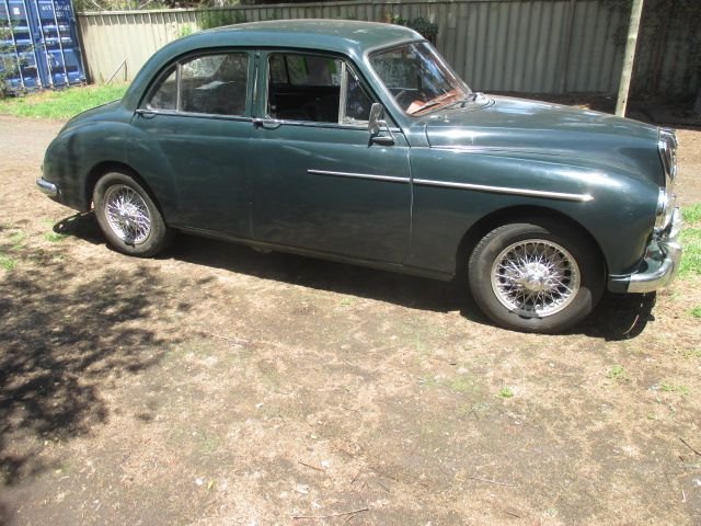

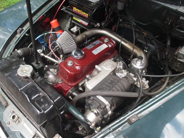

Re: the Magnette,
Peter, it's even better than as described. I forgot to include in the text that I also fitted a Moss Motors Eaton supercharger! (FIXED!)
Whilst I do have a 3.9 banjo diff on the shelf I kept the original 4.55 unit because I used the Ford Type 9 gearbox from a European Sierra that had the optional low ratio 1st gear and I was interested in acceleration rather than long legs.
I swear to God when I get into 5th gear it feels just like a Jag!
Pre war, MG made delightful sporting saloons eg the VA etc. Post war we got the MGY & then the Magnette- hardly soul-stirring drives.
