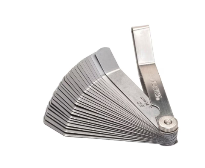

I find this type makes things much easier when measuring.
