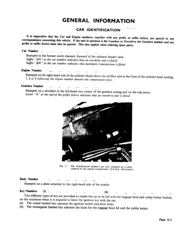

Here's the relevant extract from the Service Manual:
The VIN system wasn't in place in the Mk2 era. The Chassis Plate is stamped with:
1. Chassis No
2. Body No
3. Engine No
4. Gearbox No
