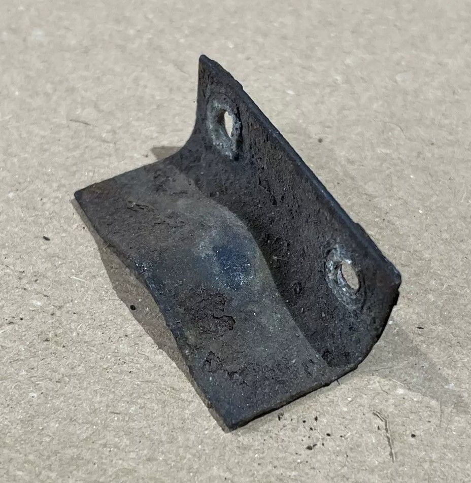

They are in the right place. The link below is the angle piece that goes over them. You can see some holes near the bigger ones for the screws that attach the angle to the bottom of the door. As it all rusts so quickly, I'm inclined to make my own angle pieces from aluminium sheet.

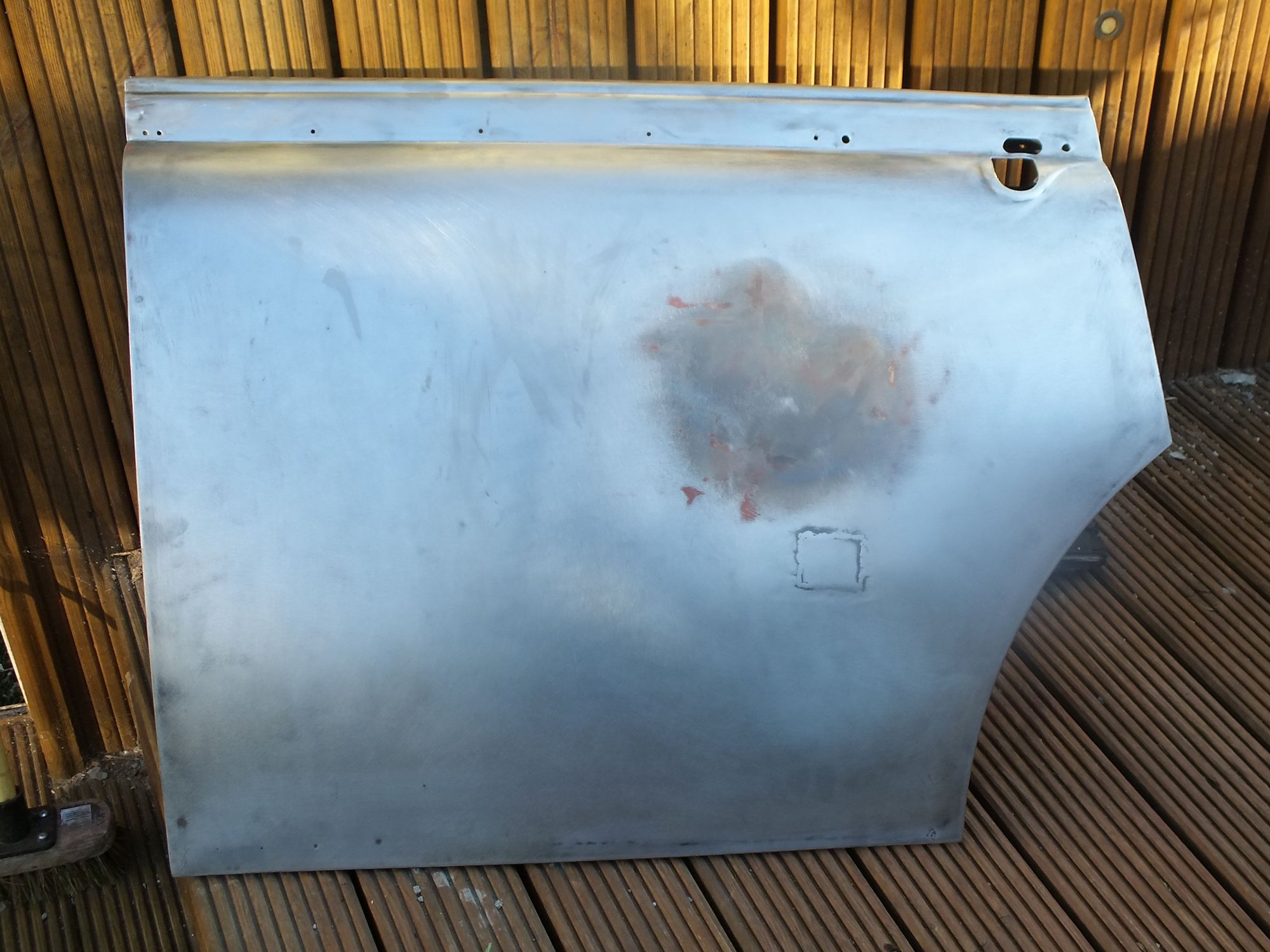

Totally agree with the rust spot in the rear door and I wish I had thought of the waxoyl soaked pad. My rear doors had the rust spot and the previous restorer (a Jaguar specialist who employed Monkeys to do the welding) had repaired the spot by welding in a patch. Problem was welding the patch in distorted the door skin and left a large dent. I could push this out to get the door flat but any pressure on the skin and the dent popped back in. We solved the problem by lining the inside of the door with a layer of glass fibre which gave the skin it's strength back so it remained flat. The alternative was to fit a new door skin which involved a lot of work.
This is the rear door in question showing the small square weld repair and the brown patch which is the dent.

Attached photos of Jag MK2 door with drain holes : I guess this is the inititial design to address this infiltration issue .
