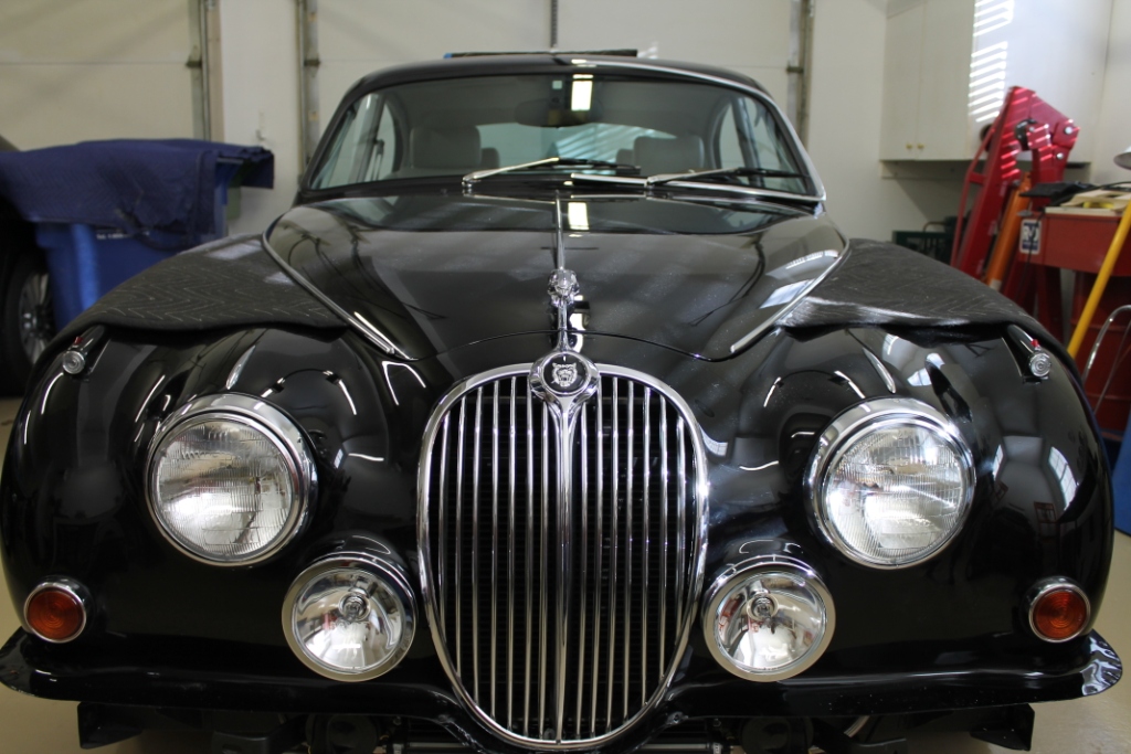

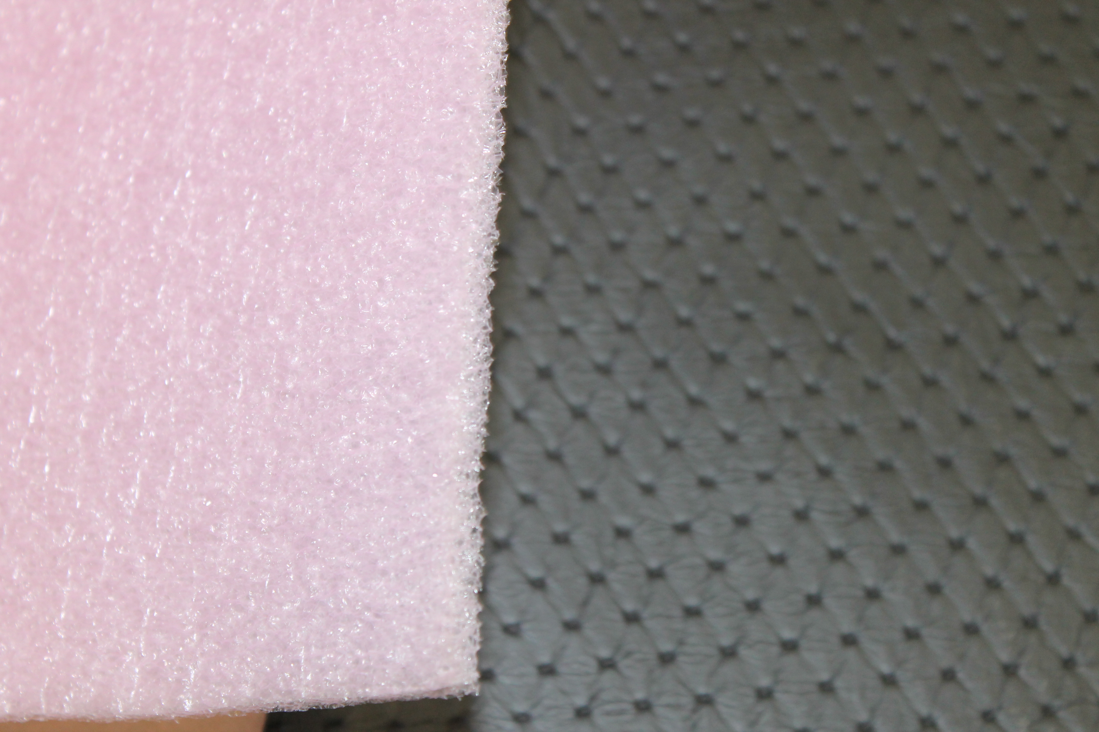

We buttoned up the front lights last weekend. Installed cheap sealed beam headlamps to get the beast through state inspection, after which we'll go with something that actually lights the road. If anyone has opinions on the best technology I'd love the feedback - HID, LED - not sure what's available in the 7" single lamp style or what's the best. I'd also like to install LED daytime running light bulbs in the driving lights - does anyone know if these are available to fit a halogen (H4 I think) socket?

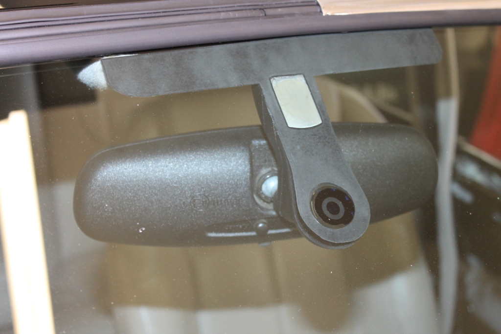

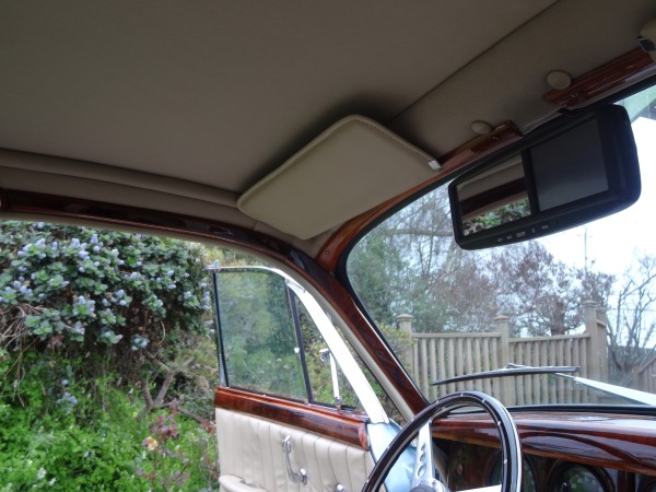

Also open for thoughts on what to do about the rear view mirror mount - looks pretty bad from the outside. I blacked out the mirror and rain sensor mount areas except for where the mount glues to the glass - assuming any paint on the inside would defeat the metal to glass bond. I believe modern windshields apply the blackout area between the glass layers which isn't an option here.

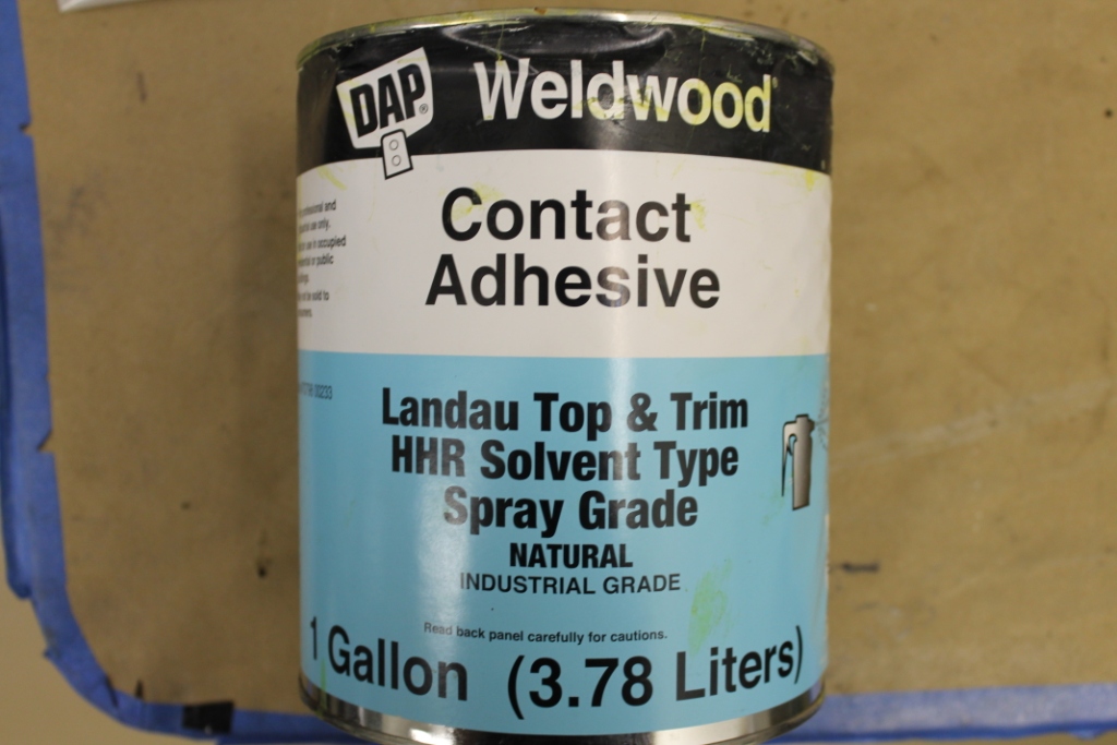

I used a 1/4" closed cell polyurethane foam and found a nice perforated vinyl for the bonnet and boot lid insulation panels. This is a simple project as there's no need to sew the edges since they tuck into the framework - just be sure to use an appropriate adhesive to withstand the heat. Until next time - and Happy New Year.

Doug, you could use something like this for the mirror, http://www.ebay.co.uk/itm/Perforated...r=520893034039
I have something similar on a van I have that is stock from the manufacturers and it is definitely on the inside as you can feel the texture.
Or you could use a very dark tint film, the high performance type can have the mirror glued on top of the film.
You could shape it leaving the rain sensor hole and mount the mirror with a black glue pad, or they do clear pads which would stick to the windscreen through the perforations.
Great job, the insulation looks great, where did you find that vinyl, it look perfect.

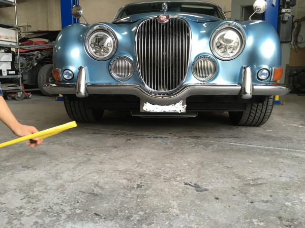

I think the 7" LED Vision X https://www.headlightrevolution.com/...-low-high-halo
is the best headlight around. It is made of very high quality glass not cheap plastic, has a lifetime warranty and provides incredible light that makes it easy to drive through windy roads at night. I highly recommend them and to buy their relay option as that allows all 5 elements to be on during high beam mode.
What I did for the rear mirror was use the Escort aftermarket rearview camera/GPS mirror that glues to the windshield. It is a bit heavy so you have to be careful when adjusting it. It works great and gives me the modern convenience of rear view camera that is displayed on one half of the mirror and the option to switch that to GPS as well. It looks like it came with the car.

I took a look at those lights, they look great, the B#####r is they are not suitable for the Europe market, it looks like the European market has polycarb lenses.

Originally Posted by TilleyJon
Primaz,
They make E-MARK and ADR models so that they are street legal for the global market.
I saw that, but they say they are polycarb lenses not glass, I can't find any with glass lenses Alan, I maybe going mad !

Enquiring minds want to know. What is the source for the vinyl and is it a high temp variant? Which high temp adhesive did you use?
? Could be me as I assumed they were glass but maybe they are not? They are great quality and the best light I have seen in a 7" round; plus they are LED so they reduce the draw on the lame Lucas wiring

Thanks for the good tips on the mirror mount, Jon. I like the idea of using the perforated vinyl as a mask (not sure about gluing over/through it) - think I'll combine this with a black glue pad (didn't know they existed). Now, how the heck do I get that button off the glass?!
Primaz, those headlamps look sweet - I'll put them on my parts list for when the wife's not looking. I already have a gps in the dash and the XJR mirror has an integrated sensor for automatic headlight control so we'll stick with that one.
Lin and John, here's the contact cement I used. I have a can of 3M high temp adhesive I originally purchased for the insulation panels, but after using this stuff for the headliner and carpet installs I decided to stick with it. Adhesives can be difficult to spray because of their viscosity but this is a breeze to apply. Just shoot both surfaces, let it set up for 10 minutes and join. Adhesion is instant and permanent so there is no room for error, but the bond is amazing and strengthens with repeated heat cycles if the literature is to be believed. There are dozens of vinyl suppliers on ebay - just search perforated marine vinyl and choose a heavy weight material (20+ oz). The marine fabric is waterproof and intended for direct sun exposure so I used that assuming it would help with the heat exposure. I'm more concerned about the effect of all the hydrocarbon gases on the vinyl over time, especially if you're running an old motor with that big breather. I guess time will tell.

what did you use for a spray gun ? and how did you clean it after ?

Thanks for the good tips on the mirror mount, Jon. I like the idea of using the perforated vinyl as a mask (not sure about gluing over/through it) - think I'll combine this with a black glue pad (didn't know they existed). .
Doug, you could use this by 3M it is 4" Sq, you could cut to shape and it would give you a large bond area which would easily stick through the perforations, it is very thin so would not get any mirror vibration either.
It looks like you have quite a large flat area on that mirror, so you could cover most of that with the black pad and have plenty of grip.
BLACK - 0.15mm Thick - 3M Double Sided Acrylic Tape Pad Square - Model: 9448 A | eBay
This one has free international shipping http://www.ebay.com/itm/BLACK-0-15mm...wAAOSwAuZX0~mK

We got the rear view mirror installed with a more acceptable result. Jon, I went with a vinyl mesh which does a nice job of masking the area. For the mounting plate I found a black glass-etching primer that's used to repair the frit that's manufactured into modern windshields for the urethane bonding. It did a nice job of hiding the metal mount - just hope the bond holds over time.

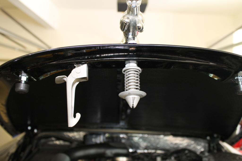

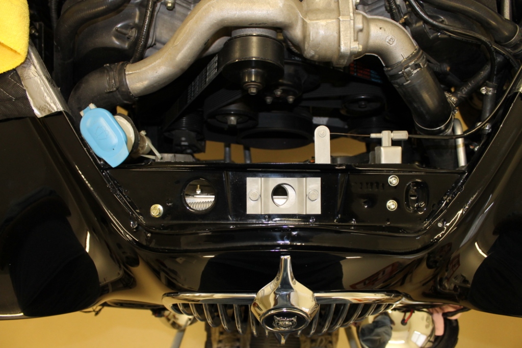

Heads up Clyde - when I framed the nose for the new radiator mount I failed to leave clearance for the bonnet latch release arm which extends forward toward the grill. Rather than cutting and welding around all that fresh paint I simply rotated the mechanism 180 degrees which points the lever rearward. Looks like crap hanging out there but there's plenty of clearance and one benefit - it puts the release knob on the driver's side.
Heads up again Clyde - I never noticed this until mounting the bonnet (hopefully) for the last time - the rear of the bonnet drops/dips into the engine compartment a few inches when fully raised. Be sure to leave sufficient clearance here when fitting components near the firewall. I have about 1/8" to spare to the vapor recovery system purge valve - hey, we do get lucky sometimes.

Attached Thumbnails XJR Mark 2-bonnet-latch.jpg   XJR Mark 2-bonnet-hardware.jpg   XJR Mark 2-bonnet-clearance.jpg   XJR Mark 2-mirror-frit.jpg   XJR Mark 2-rear-view-mirror.jpg
