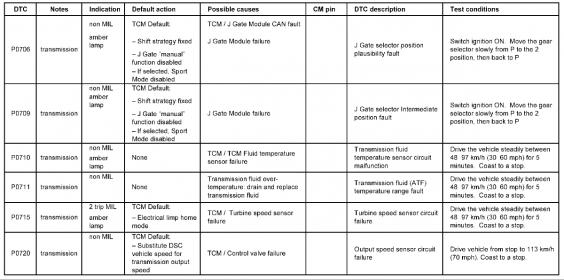

Hello Jaguar friends! I have a 2005 S-type that hesitates before shifting in to 4th gear. The diagnostic code is PO-720 and we are having difficulty fixing this. The trans is a ZF 6HP26. Any info you could share with me would be greatly appreciated! Thank-You! JagGirl

hmmm, dosen't sound good
