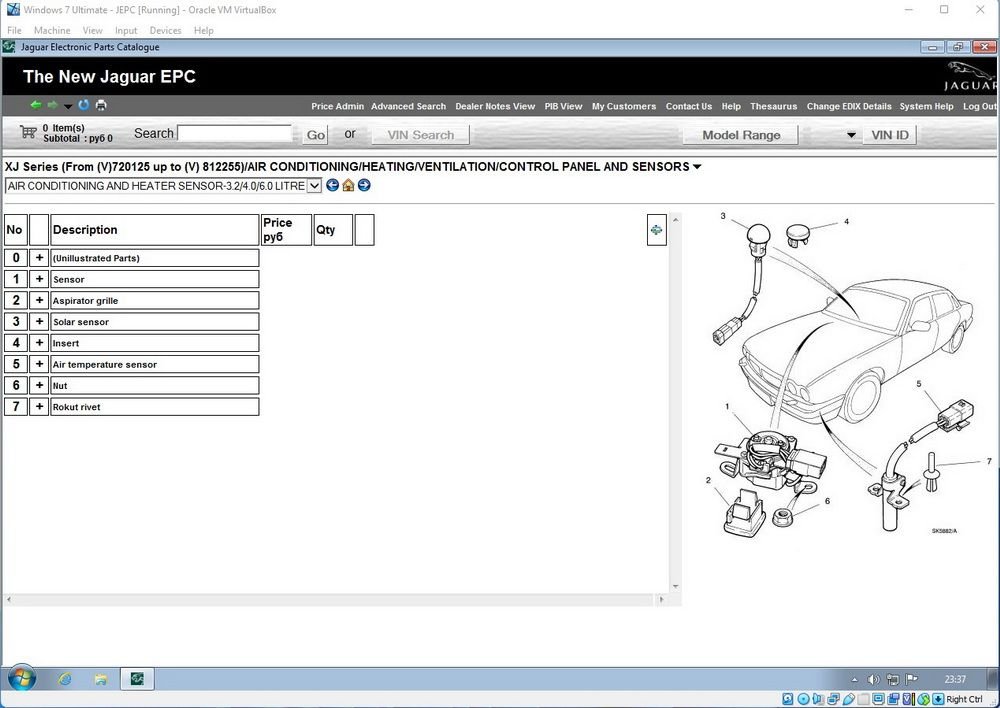

Old Jan 29, 2022 | 05:48 PM
Likes: 17,009
Kade,
You should be able to feel the pump working - it vibrates gently.
There's three temperature sensors involved (see items 1, 3 and 5):
If you have replaced the servo motors, I'd begin to suspect the control module (item 2):
