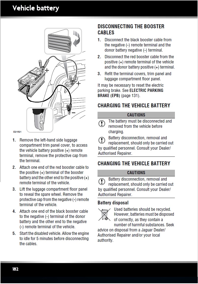

I have a 2013 XKR-S, I have found the positive terminal on the left side rear trunk, where is the negative terminal? Please help.
Old Mar 28, 2017 | 05:15 PM
Welcome to the forum Gilstan,
Follow this link XK / XKR ( X150 ) - Jaguar Forums - Jaguar Enthusiasts Forum to the XK/XKR forum for help, advice and information.

There is no cap on the negative terminal just a post/screw exposed where the spare tire would be. I assume that if I hook the positive to the jumper cable the exposed post where the spare would be would be a good ground even if it Is not the negative?
