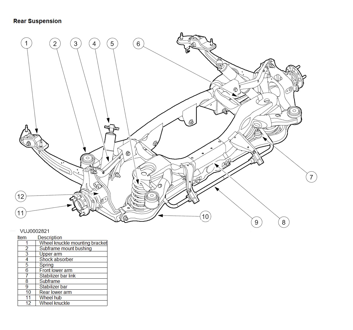

Hi everyone. So I'm new to Jaguars, but am a big fan of them. So I'm building a model T hot rod and I was offered a 2002 X-type rear end. I just have to pull it out, but I've little mechanical experience do far.
I've looked, but I can't find any step by step info on how to remove this from the car. If you know of any good videos or other online instructions on how to do this. I'd be very appreciative. Thanks.

It could be easier to see from the diagram than it does when you're lying under the vehicle.
To remove the complete assembly, it looks like 2 shock absorber top bolts, 4 knuckle mounting bracket fixings and 4 mounting bush bolts.

Graham, thanks for the info. This helps greatly.
