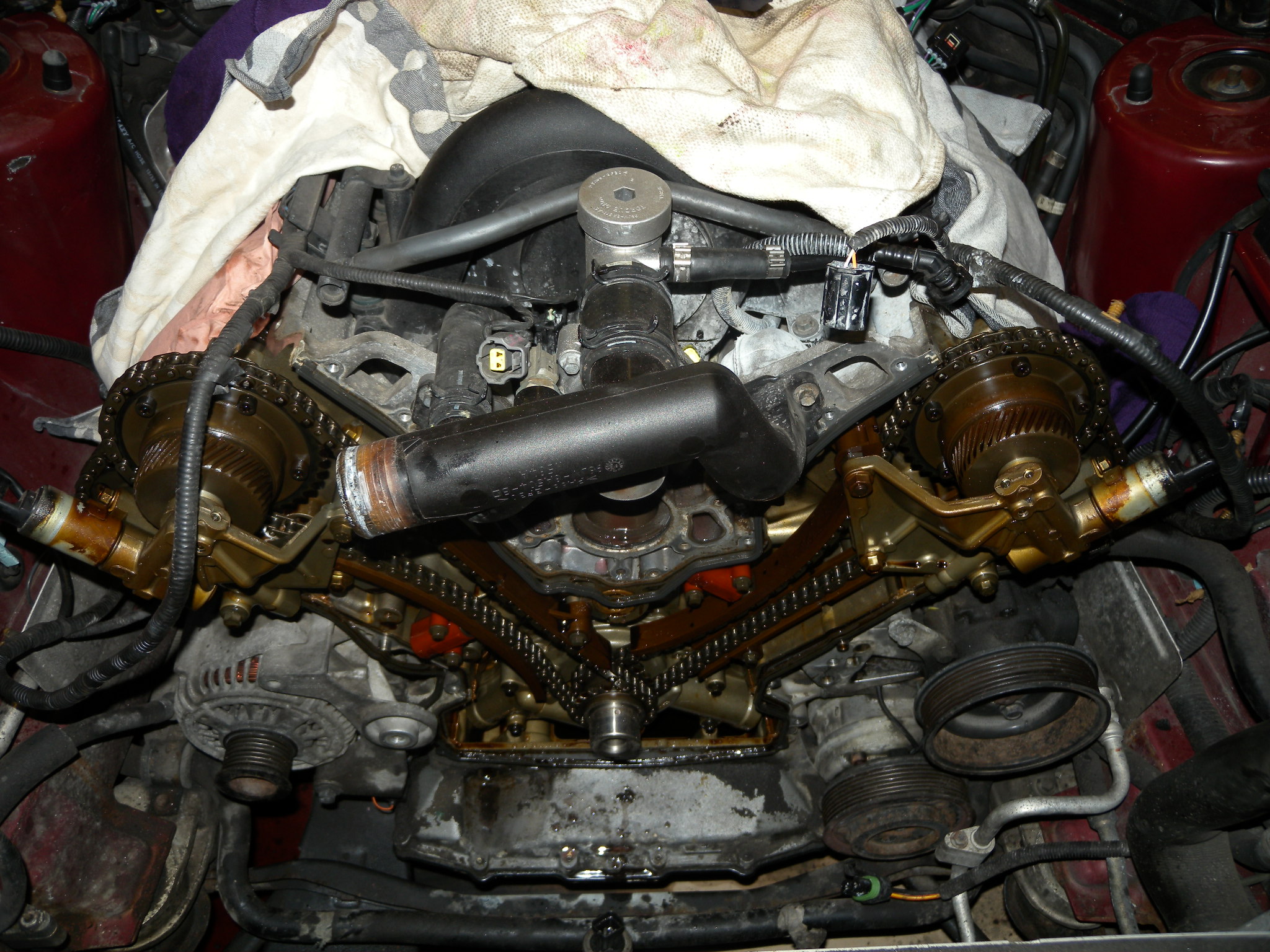

Success - and also good to find you caught a potential serious failure of the plastic tensioners in time.

Yes, I am in France with the XK8. Did the job with dad in law near Troyes - he has been a Jaguar fanatic for 30 years, still is, with a great deal of mecanical experience and tons of tools accumulated over the years (and a ramp!). I have learned a lot over these few days working with him in the engine bay. That has certainly helped in demystifying the car.
I am now in Strasbourg with my own family. Weather is rainy but will improve soon so I can hopefully take the roof off. My boys have enjoyed the whole trip with me so far. Who said that the back seats were not usable in the XK8 - for people under 10 years old they are ! :-)
No issues so far, no leaks whatsoever. The engine is very sweet as it should and what a pleasure to rev it now without this worry in the back of your mind !

Pics hereafter !
