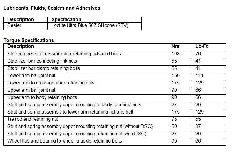

I recently signed up as a new member. I am trying to download JTIS from a forum page but can`t seem to find that access. One of the members told me that being so new I might not have access to that yet. I am trying to complete a suspension rebuild on my 2000 s type and need the torque specs. Can someone tell me how I can get full access to download JTIS ?

To get over your immediate problem, here are the suspension torque specs from JTIS for the 2000MY S-Type:
(click on the images to enlarge them)
