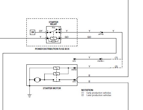

Here is a diagram of the wiring inside of a starter. When you turn the key the pull-in and hold-in windings get power. The pull-in winding gets its ground throught the armature of the starter. When the connector plate makes contact inside of the solenoid; the pull-in winding loses its ground as the power is now flowing to the armature. The hold-in winding keeps the starter engaged until the key is turned back to run.
If the pull-in winding doesn't get ground through the armature (bad spot) then the plate won't make contact inside of the solenoid and the starter won't spin.
