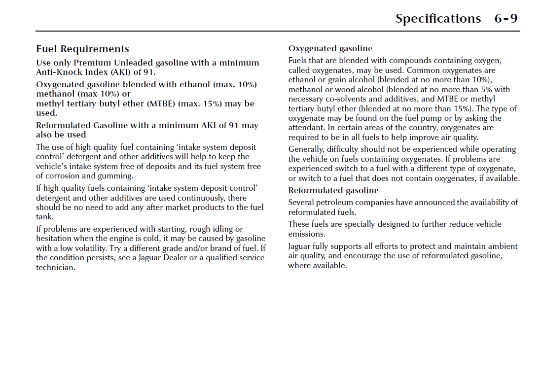

If so, see the section on 'Oxygenated Gasoline' is this extract from the XJ8/XJR Vehicle Care Handbook (click on the image to enlarge it):

Jaguar build different engine management specifications for different markets and these are tailored to local fuel availability. If the models you are considering were originally supplied to the Far East, you should be OK.
