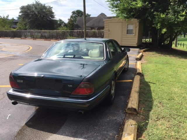

I finally found a 1996 xjr on craigslist for $1200obo runs and drives. I gave them a call and inquired. He said it cranked up a couple a weeks again but it had been sitting and may need a jump. So i decided to take a chance I told the guy I would come up there and get it. 15hrs a way on a hope and a prayer.
I get there and am looking over the car and it looks decent for 20 year old car that has been passed around the neighborhood a few dozen times. It had over 221,000mi missing the ac and supercharger belts, the front springs were broke, 4 flat tires, and wouldn't start after a few attempts. But finally we did get it to start after I tightened up the battery cables. As promised it did run and drive and not much more.

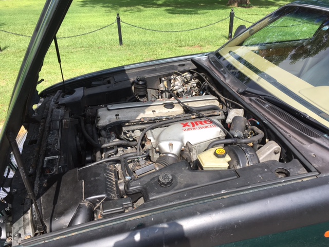

The first thing I did was replace the belts and air filter. I just used a cheap 6 rib belt that I measured there in the parts store parking lot because they didn't sell the actual belt. I do recommend it in a a jam, but not as a permanent solution due to the fiber core. To my great relief there was no problems like i thought there would be.
I had them run the codes for the check engine light and they gave me a mountain of codes mostly in the way of missing issues. So i started with the spark plugs. Reading on this forum I used the recommended champion plugs.
The engine light came back on shortly after despite running better. So I had them reread the codes and it came back a faulty fuel injector on number 2. So i pulled all the injectors out and cleaned them. They all looked pretty decent so i got everything put back together and now it runs pretty rough and gas mileage has dramatically reduced. I went back and had the codes reset, and it continues to run poorly, but the light hasn't popped up so it has to be something I did maybe a vacuum line idk.
