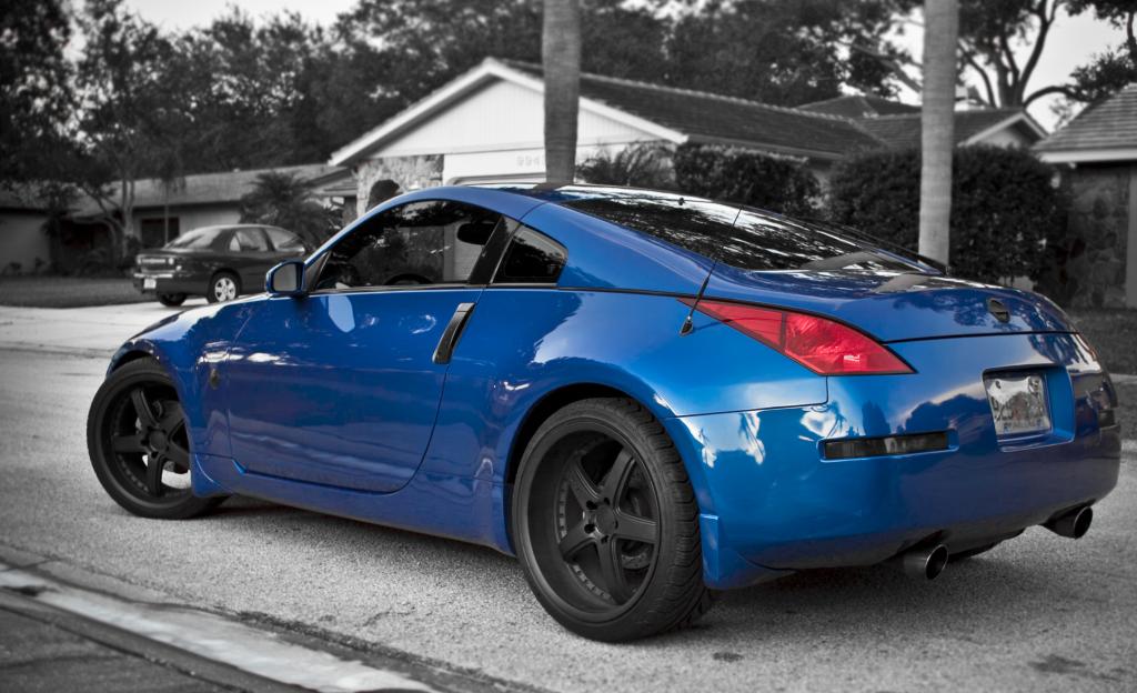

Here is an older picture of the Z

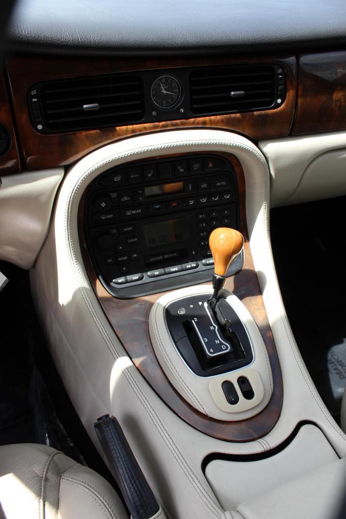

Welcome to the forum ElderGooseYdG,
looking through the pics:

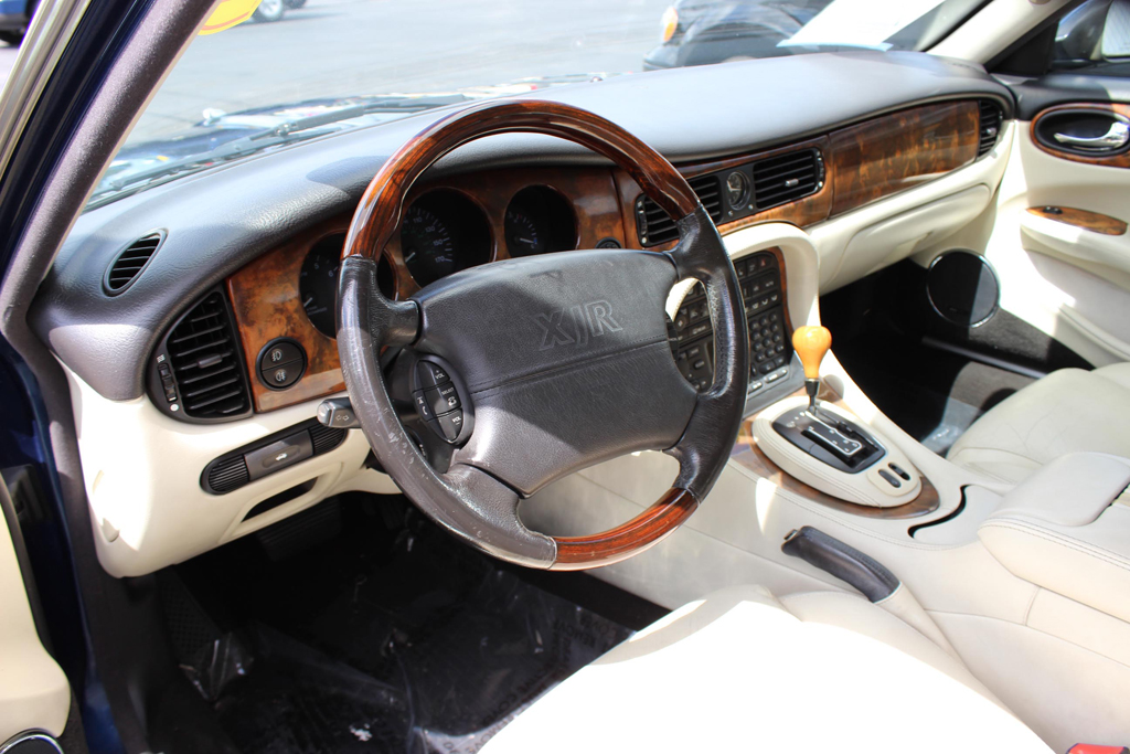

1. transmission selector cracked
2. sport switch broken
3. ashtray may be broken - lid not closed properly

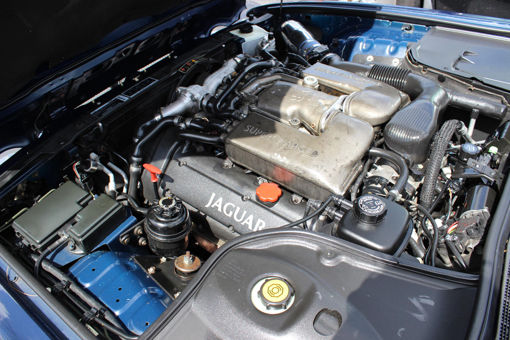

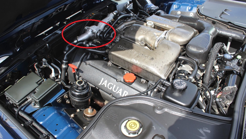

4. engine bay - evidence of recent cooling system work

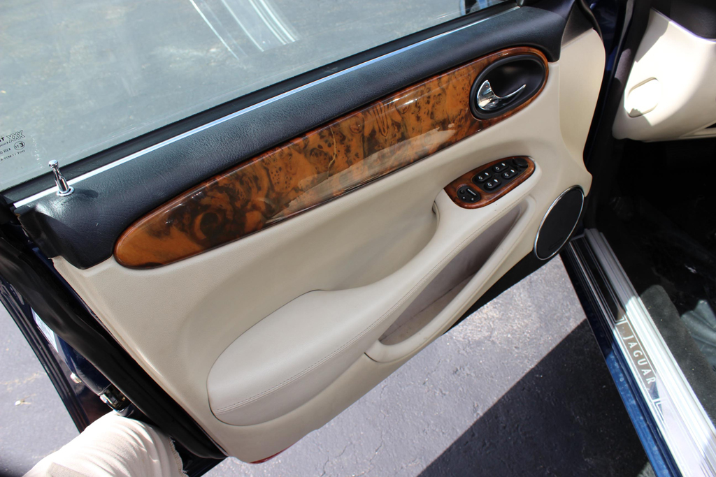

5. driver's door veneer - is that a crack?

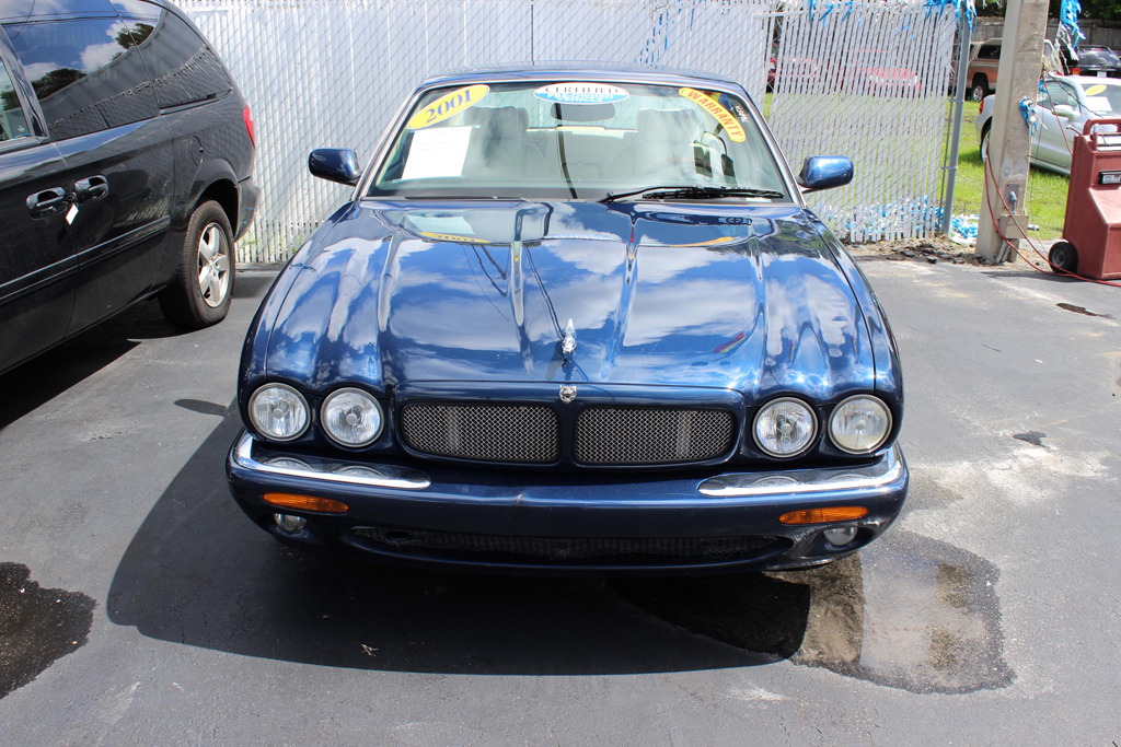

6. front bumper - is that a split top left of centre?

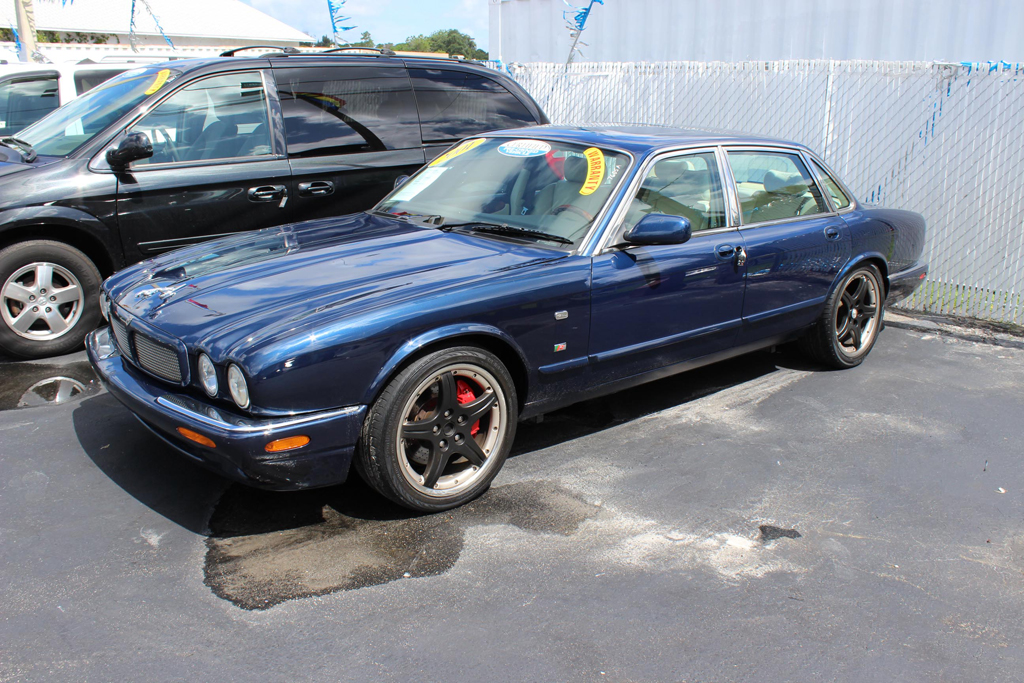

7. LH side - does the paint match between doors and wings? Looks as if it may have been part resprayed or this could just be the pic

Thanks for the quick reply!
Transmission selector IS cracked.
The sport switch isn't broken, just the button cap missing.
Ashtray lid is off its track or possibly broken.
The driver veneer does have a crack, and the bumper does have some warping I guess it could be called, not cracked though.
As for the evidence of cooling system work can you elaborate a little?
As far as I can see in person the paint looks alright...of course anything is possible it is more than likely the lighting of the photo.

Originally Posted by ElderGooseYdG
........... As for the evidence of cooling system work can you elaborate a little? ................
See the area circled in red:
The Thermostat Cover and Outlet Pipe are bright aluminium as if they have been replaced or recently cleaned. The rubber hoses and hose clips look new.
Not a problem but you should ask why it was done. If the engine had been overheated owing to a sticking Thermostat, this can do serious damage.

Got it. Cleaning is likely since the only mechanical repair in our computer system shows Replace Rear Axle. The guys do detail motors so I'd venture to guess that its the dressing they use for that (I hate the fact they do that). But it's a good point and I'll be sure to have it checked if I can.
