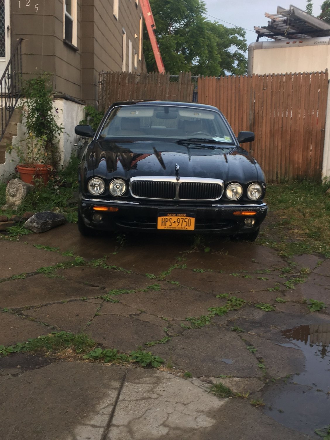

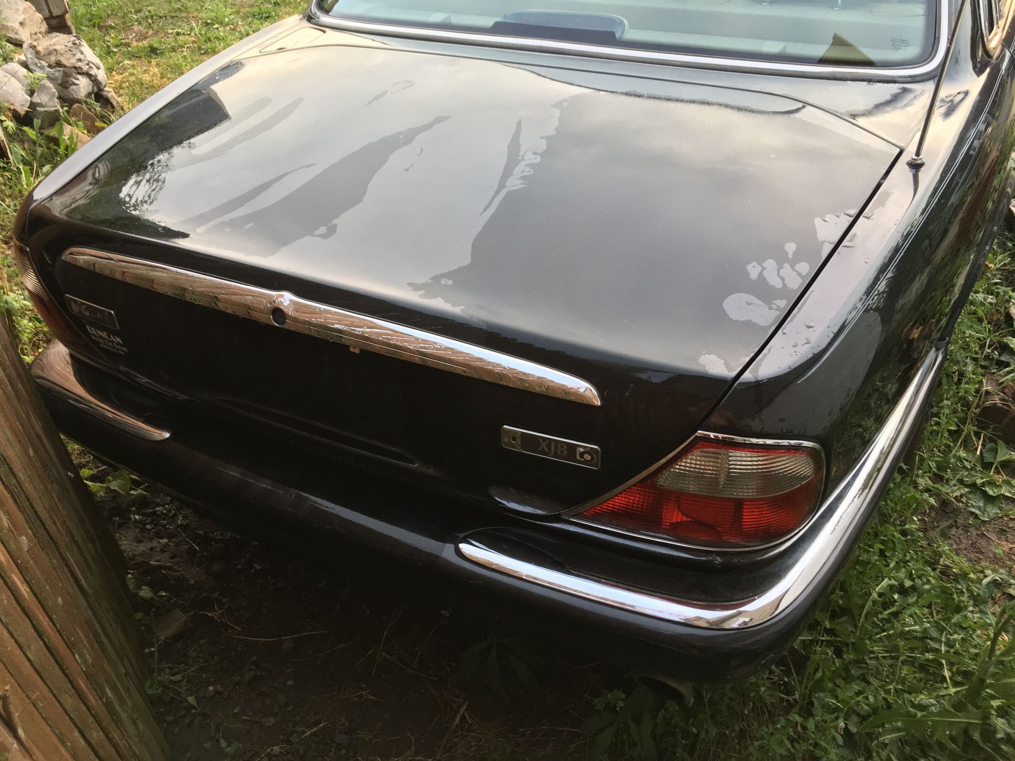

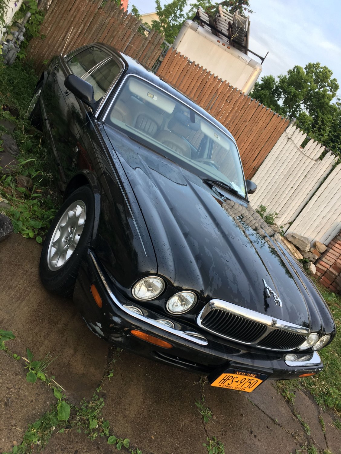

I have purchased a 2001 jaguar xj8L (127,000 miles) for basically free. My isssue with my car is that it cranks but wont start.

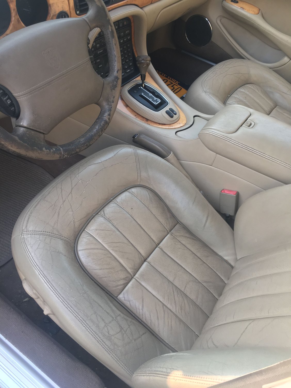

Since it was a free car there has to be a few problems but i was looking at the car and all the leather was in near perfect shape / the wood was OK with some cranks in the doors.
One of my doors dont open from the outside and another dont open from the inisde. Another small thing is the inside trunk release button dont work. And it has a traction and abs fault light. But the reason im here is because i love Jaguars and especially with model x308. Where i live buffalo NY i never see any of these cars driving around. Ive looked into bringing her into a certified Jaguar mechanic but the there extremely far and cost thousands.
The car is definitely a fixer upper but willing to put love into her.
I dont know if i did this right but i guess its required.

And I'm 80% sure the ABS and Traction Control light are on because the solder joints on two wire terminals on the circuit board in the ABS control unit have broken. If you can operate a soldering iron, you can fix it with a nickels worth of solder. I won't try to describe the repair here, but you can search for it on this forum and there's even a video on youtube where some guy shows you how. If you can operate an airbrush, your creased leather seats can be doctored to look at least a whole lot better with less than $50 worth of materials. Again, there's posts on this forum describing how and where to get the leather refinishing supplies and help you decipher the interior color code to order. The "no start" issue could be any number of things, but begin with the "cheapest/simplest" problem first and work your way toward the more expensive/complicated, never the other way around. The cheapest/simplest is to search for posts on something called "bore wash" or "cylinder wash". Try that first. If no luck, then post back and someone will suggest what to try next.
