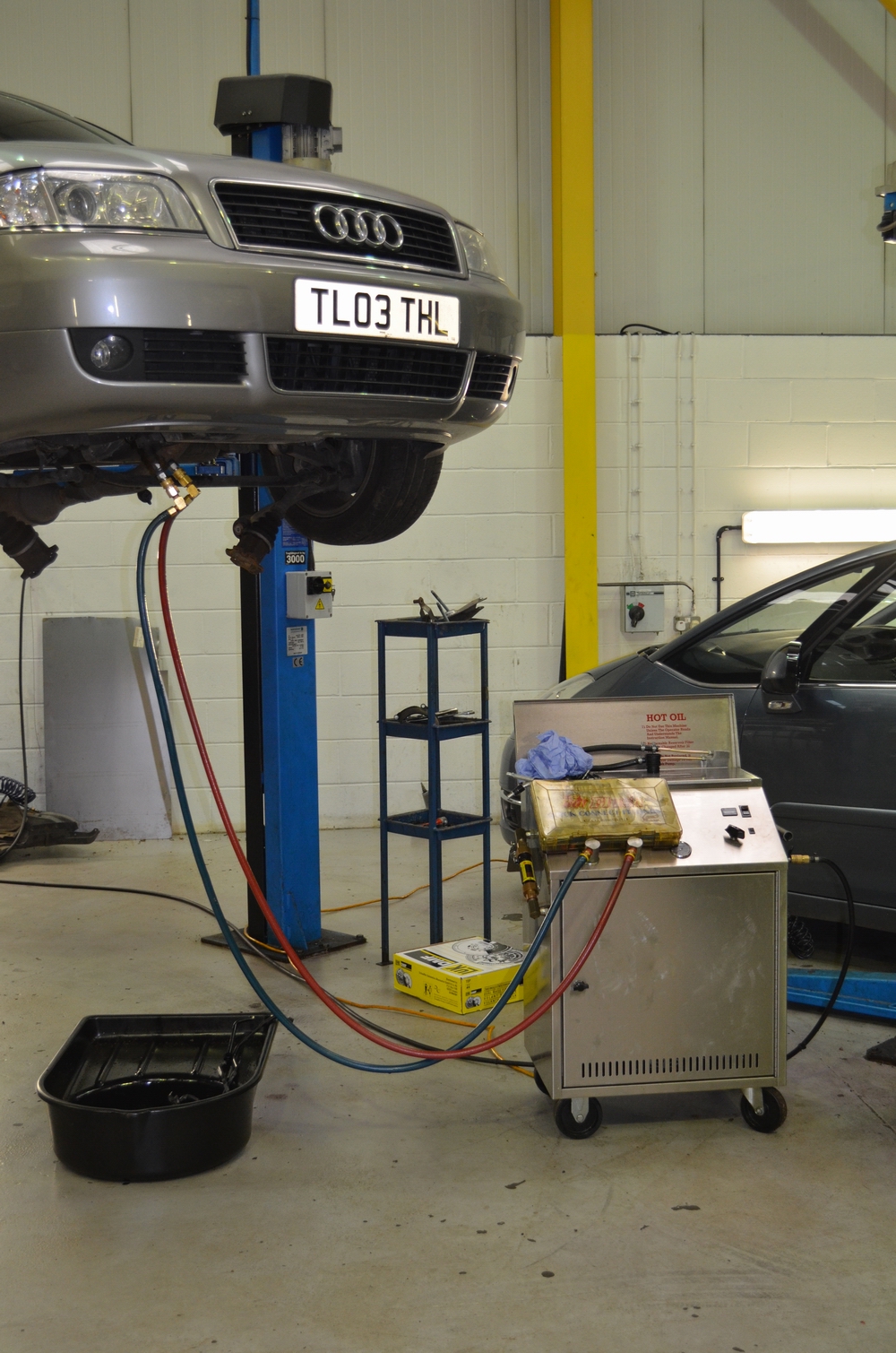

As far as transmission flush, I have heard there is a way with proper equipment, to power flush all of the fluid before filling with new. Can anyone confirm that?

We had a forum visit to a transmission specialist in Glasgow (Mackie Automatic Transmissions Ltd) and saw this procedure being carried out.
The old fluid is drained and the system flushed with new fluid until clean before filling to correct level. The advantage of this is it flushes the torque convertor which 'drain and fill' alone cannot do.
There must be similar facilities in the US.

It is great news. It seems like the proper way to replenish the fluid. Did they have to go through an engine running procedure during this process too? I suspect they would have at some point to ensure it is properly filled.
I must find someone that can do this in the Midwest. Perhaps the Chicago area.

YES - although it was a Jaguar Forums visit, the model on their lift on the day happened to be an Audi!
The procedure was a drain, flush, fill and run up to temperature whilst monitoring with a scan tool.
Several UK members have used this service since the meeting with nothing but good reports.
I recall them explaining the process was developed in the US so you have to be able to find an equivalent in your region.
