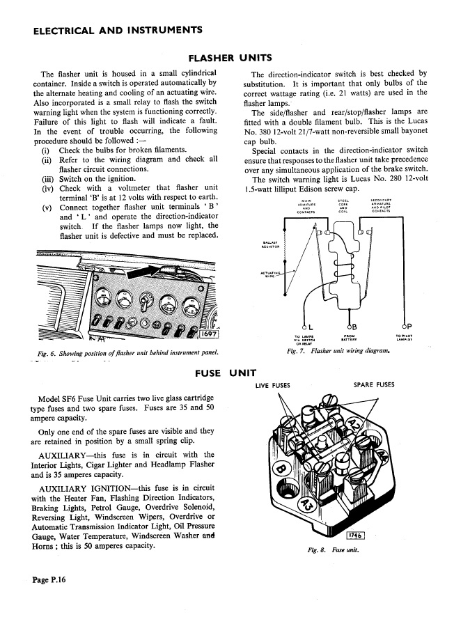

1) Where is the flasher located on my MK2 Jag, it sounds as if it is behind the dash. If so how do i get at it.

Here's the flasher location:
(double click on the image to enlarge it)

Originally Posted by GGG
Welcome to the forum Gary,
Attachment 214642
I'll leave it to current owners in the model forum to tackle the wiper question.

Yep. my S Type flasher is behind the drop down centre panel.
