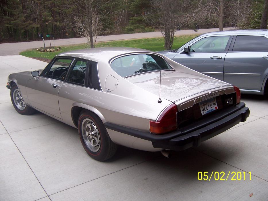

Working on a 76 Jag XJS I found in a warehouse in North Minneapolis last summer. It's been sitting since 1980, not running, not stored correctly. I have it running now but having problems with the manifold pressure sensor, and, can't find one...I really would love to drive it more then a mile or two before it starts acting up. Only has 39,000 miles on it but I'm beginning to think I may have to convert to a Chev 350 if I can't find a MAP sensor or find someway to get around it.Working on a Jag-100_0205.jpg any suggestions would be welcome.
