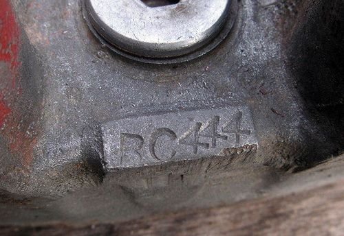

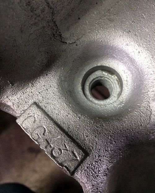

Is this BH272 definitely the engine number and not a casting number? A (2-Alpha + 3-Numeric) casting reference is quite common on the XK engine.
