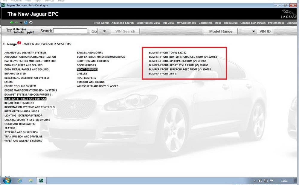

There's four different lower grilles listed for the XFS:
Follow this link https://www.jaguarforums.com/forum/xf-xfr-x250-44/ to the X250 forum for help, advice and information. The 'HOW TO' thread at the top is a good place to start for information on regular issues. You can also use the UK & Eire Region forum by following this link https://www.jaguarforums.com/forum/uk-eire-68/ to find other members in your region.

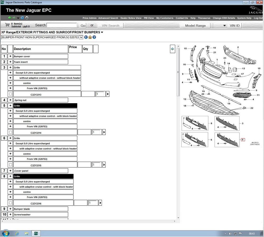

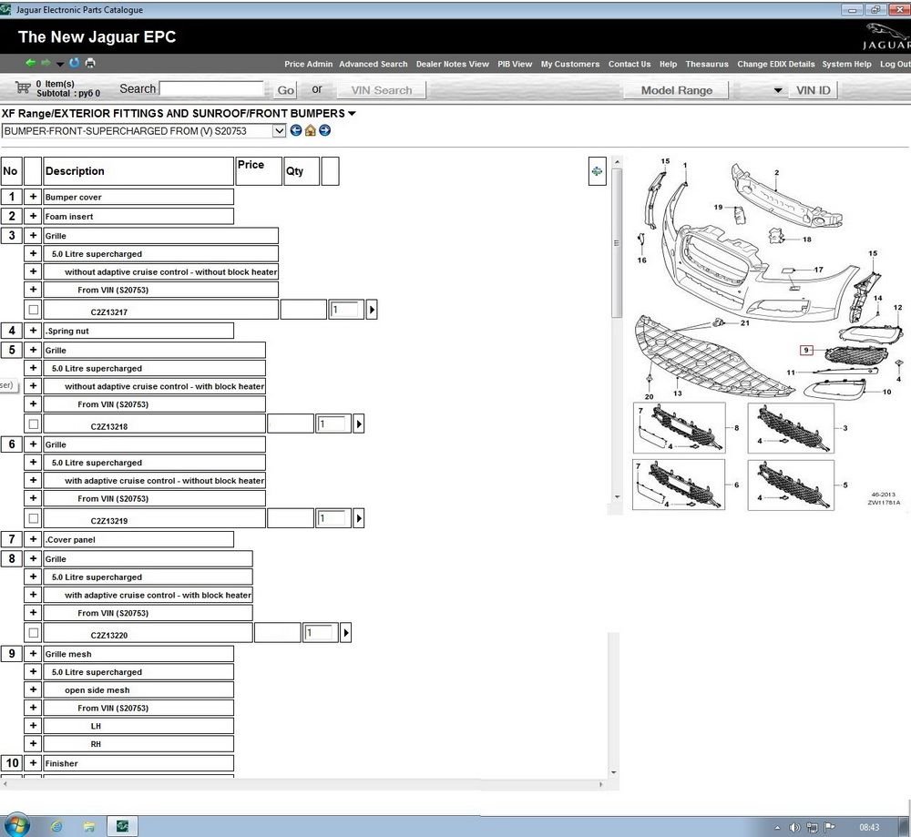

The P/N's are shown on the graphic. Either C2Z13217, C2Z13218, C2Z13219 or C2Z13220 depending on the specification of your vehicle.
Block heaters are generally only fitted in Canada so it will be C2Z13217 or C2Z13219 depending on whether the vehicle has Adaptive Cruise Control or not.

YES it does. There's a lot of different front bumper and grille combinations.
If your VIN is after S20752, these are the relevant P/N's:
If it's earlier, there's yet more listed.

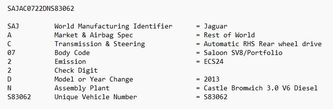

The Vin is SAJAC0722DNS83062 🤷‍♂️
Old Aug 5, 2022 | 12:35 PM
Likes: 17,005
Your VIN decodes as follows:
As a 3.0 V6 with a Vehicle Number above S20753 without adaptive cruise control and without block heater, the relevant P/N is C2Z13213. However, remember the original buyer could have requested options or a previous owner could also have fitted alternative parts so check before your buy.
