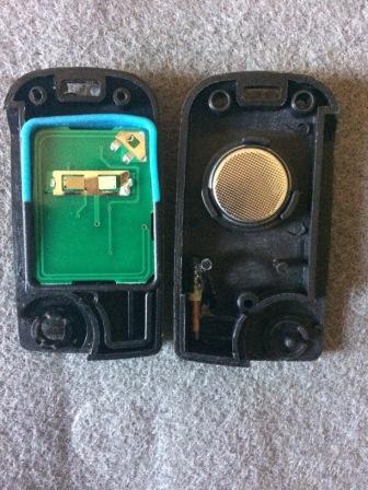

I hooked up the trusty mongoose and programmed it in. so far so good. but I noticed that while the unlock and boot buttons worked, I couldn't get it to lock the car.
So I took a closer look at the circuit board and noticed one of the solder traces not going anywhere from the lock button. Thinking I've got nothing to lose I soldered a small bit of wire to bridge the gap. voila! the lock button now works!
here's a pic of where to solder the wire :
For the price of a new shell and rubber pad I've now got another remote. it doesn't have the fancy jaguar logo on it but it works! But if your remote is faulty it will fit your original remote shell.

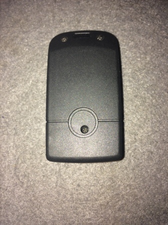

Hey all, just a bit of an update I upgraded dad's S-Type keys to these late model ones available on eBay for less than $20 delivered!
They don't come with the transponder chip but DO come with the remote circuit board and battery! I popped the old transponder in and programmed it up to his X200!
They are available on eBay, I'm not associated with the seller just a happy customer. Quality wise the plastic is a bit shiner than a genuine key and the rubber pad feels thinner. Also unfortunately they don't come with the Jaguar logo.
