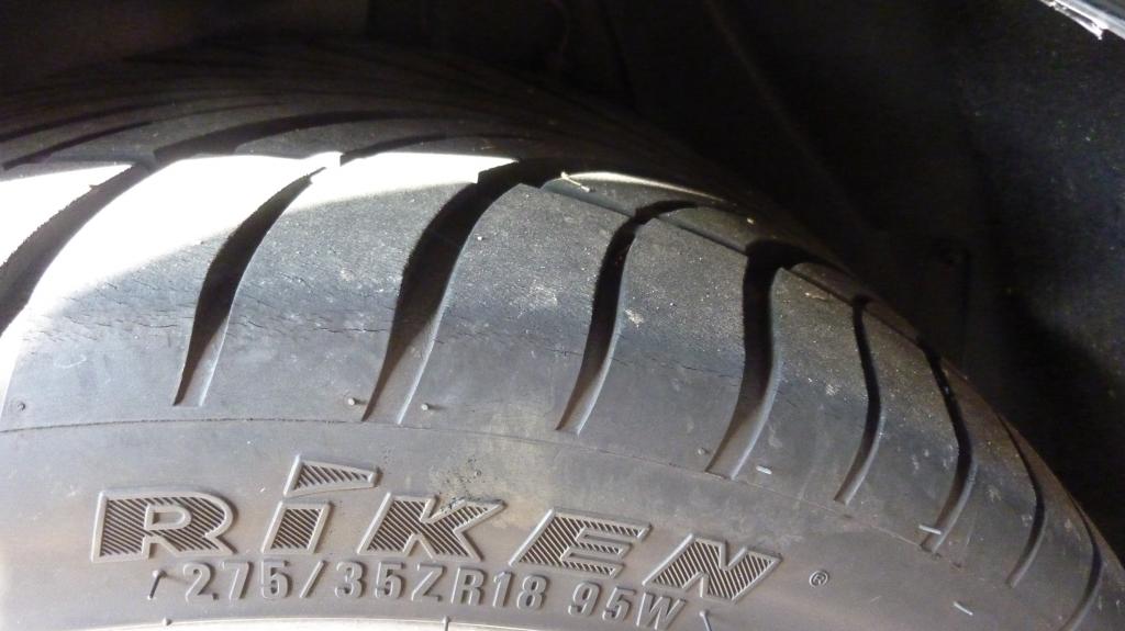

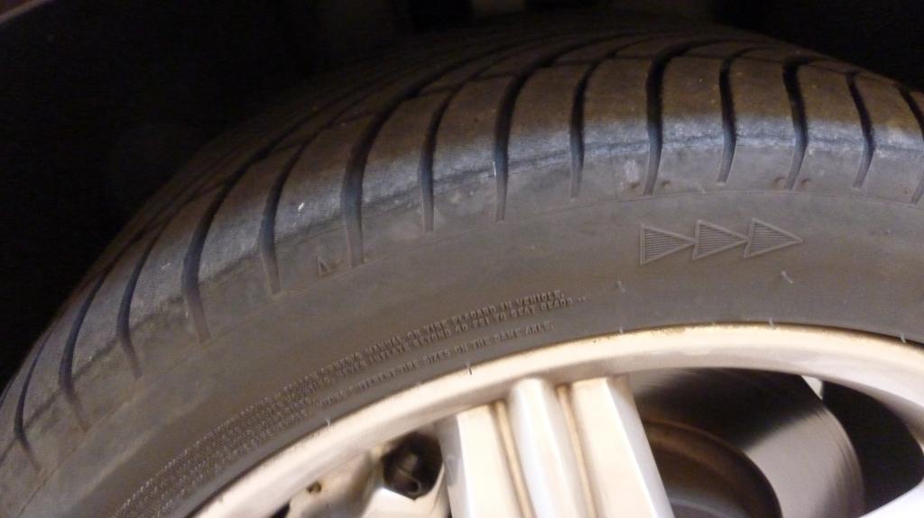

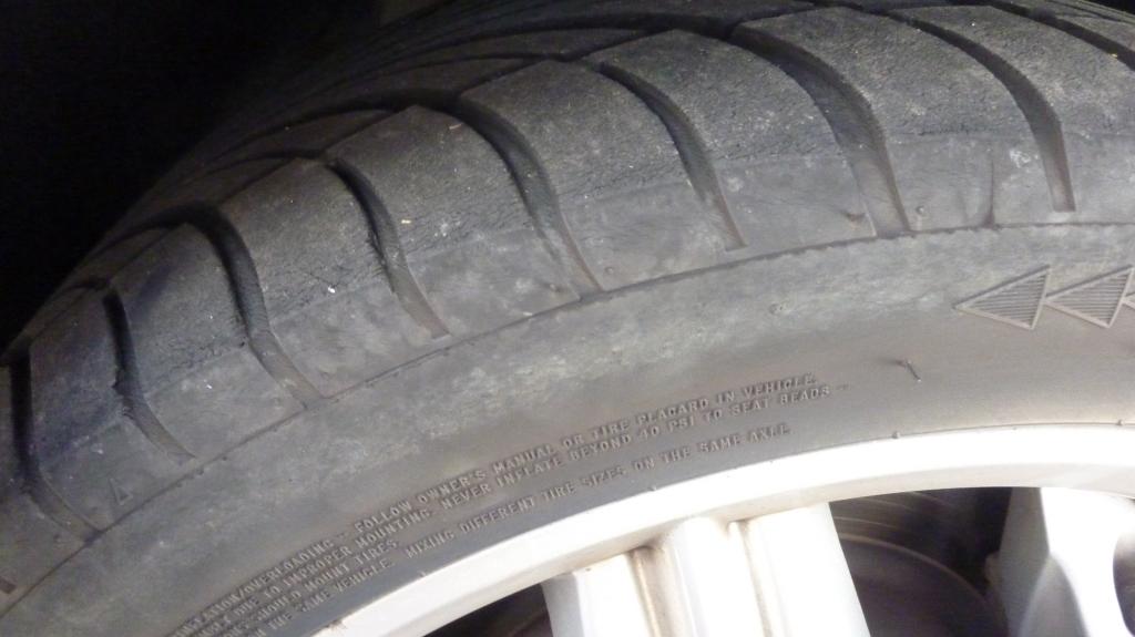

2003 STR 61K miles
The tires were put on the previous owner, and since buying the car, I have put approx 12K on them. I am religious about keeping them at 35 PSI.
Long story short, after getting my new oem struts installed today the mechanic called me up and said you need new tires ASAP. Flabbergasted, he explained to me that because they are low profile they need to be at a higher PSI than the current 35. Since I have been running them at 35PSI, he said that the sidewall is shot and they are almost not safe to drive on. I respect his opinion because he does good work but nonetheless would like a second opinion. Also his shop does not install tires, so I feel better knowing he is not trying to upsell me on parts I dont need.
I can definitely see the wear, especially on the front two tires, but am confused if it really is the end of the world as he said it is. thanks

Ask him to explain why I see no need but I cannot see the inner side of the tire.

I see a little scrubbing on the tread edge, nothing much beyond that (?)

+1. We need to see the inner edges as that's where the tire is most likely to wear down to nothing if that is the case.

I agree, what do the inside edges look like?

Read the date code on the sidewall and figure out how old those tires are. They look kind of dried out.

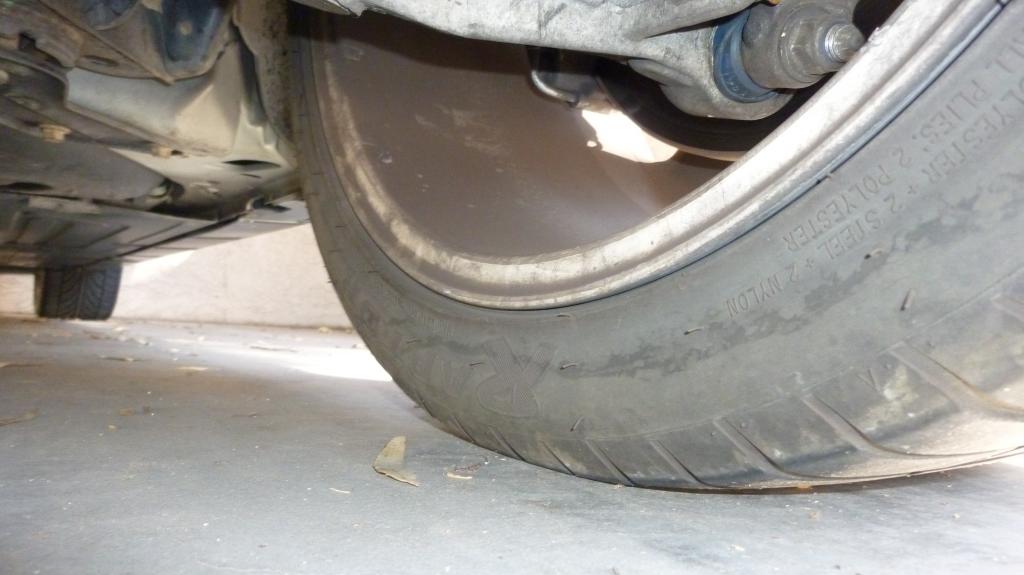

I appreciate all the responses and thank you for verifying that the factory calls for 36/38 front/rear psi as confirmed by the sticker in the door jam.
Here are the pics of the insides. I skipped the fourth tire because it only has a few thousand miles on it from someone forgetting to pick up their nail they left on the freeway. Car has been aligned since the first week I got it (49.5K miles) to the "Brutal Specs."
I am going to Discount Tire tomorrow to get another opinion. Thanks

Get a second opinion from another shop!

I had tires on another car that were not safe to drive because of the sidewalls but I could feel it in the steering. It felt like tie rod ends were worn with play in the wheel. They also gave a very unstable feeling if you accelerated from a stop with the wheels already turned. The sidewalls would flex and feel very unstable. You didn't mention any of this so it might be interesting what info. you got from Discount Tire.

I can't tell from the pictures but sidewall damage is sometimes hard to see until the tire is dismounted.
But the guy is completely wrong about ruining the sidewall by running them at 35 psi. That is just plain wrong and I would be suspicious of any other statements this tire expert makes.
