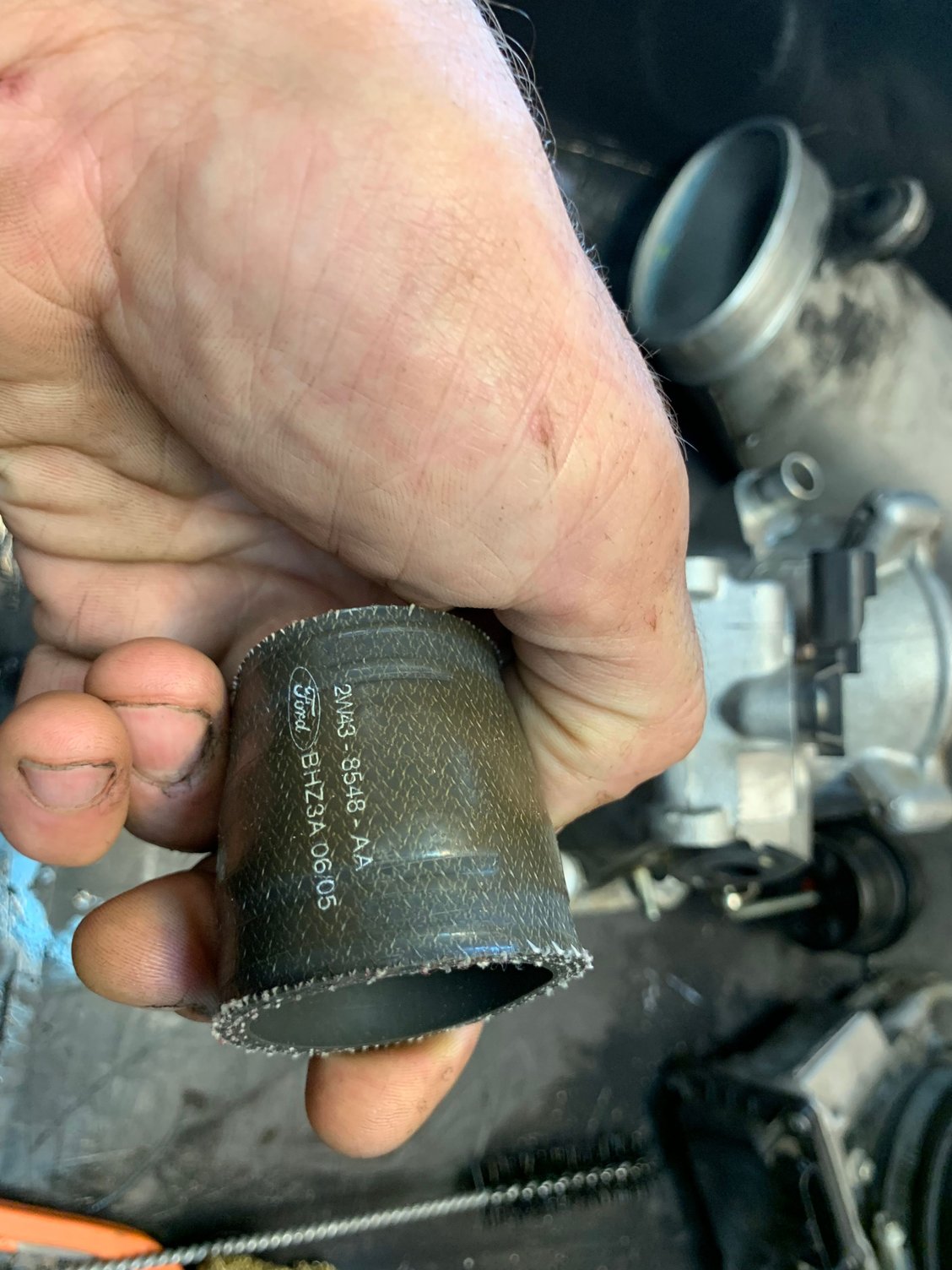

Saw this label.
Ford 2W43-8548-AA
BHZ3A 06/05

I saw that too. Imagine all the money you'll save getting it from Ford. Why it might finance the entire repair! LOL

Aarcuda did you manage to get the hose?
Not sure if I should reuse mine as it was covered in oil.. And I suspect that this must have been the leak/source of where the surrounding oil spots came from.
Cleaned up all right, must have been weeping through the clamps.

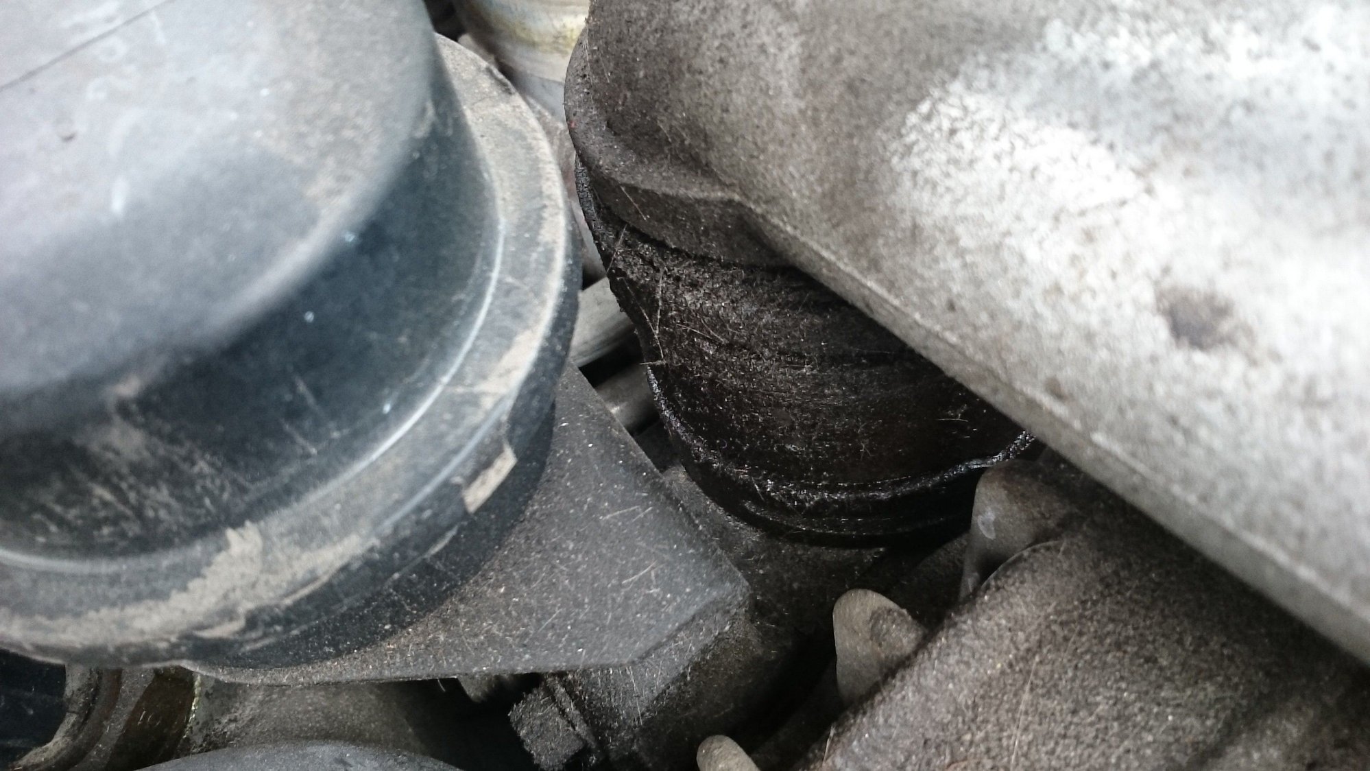

I did clean and reinstalled this hose but after a few miles its starting to weep oil again.
It appears that its leaking from the body of the hose and not from the clips.
So new it needs to be; can't reuse.
This old thread didn't mention a Jaguar part number; AJ82756 for those that need to replace.
Not sure if anyone has successfully tried an alternative to the ridiculous 30 pounds asking price; for a short bit of reinforced silicone hose, with a Ford part number on it!
I tried, but nothing's coming up on those Ford part numbers.
Car's running okay with the old hose, with no error messages.
