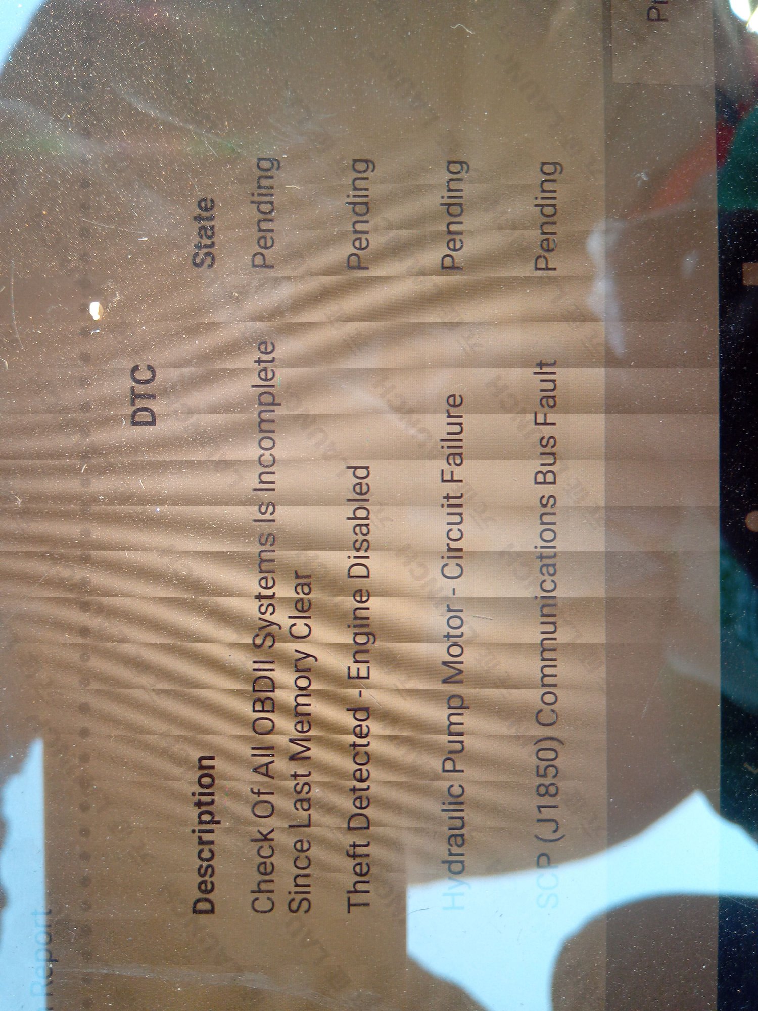

I jave just purchased a non start 1999 S-Type 3.0L with No Crank.
what could be the possible issued to fix for the car to start or where and what to look at?
I need your help please.
VIN : SAJAA01E2XFL16374
attached scan codes for support.

P1000 is no surprise
P1260 is a big worry
C code - another day
U code - hmm
If they're all just pending then back to basics to start any petrol engine
Though the P1260 may be it. If it is, I'd expect a flash code on the PATS light. Be patient with ignition on, but if no flashing it's just a puzzle for me.
Ooh, I didn’t see those screenshots when I initially replied. I’m no expert on the anti-theft system, but with P1260, I would also expect a flashing code on the indicator light. Not sure what to suggest next.
i added the screenshots after you have replied.

Try searching online for "Ford P1260" or similar. PATS was a Ford system, so many other vehicles of that era have had that code, not just Jaguar. I noticed a common theme of PATS being triggered after excessive cranking of the starter. Some unspecified fault (not security related) would keep the engine from starting. Then, in the process of cranking and cranking the starter, the battery would get run down and PATS interpreted this new pattern as a theft attempt. In addition to setting P1260, power would be removed from the injectors and often (but not always) the starter would be inhibited.
Sound familiar? If you have another known-good battery, it might be worth trying that. At a very minimum, measure the battery voltage while you try to start. I've seen batteries test fine at rest but drop off dramatically under load.
Originally Posted by mikega
injectors gets no power to spray fuel
See my comments above. This is not a root cause. It's a normal response by PATS when it thinks there's been a theft attempt.
