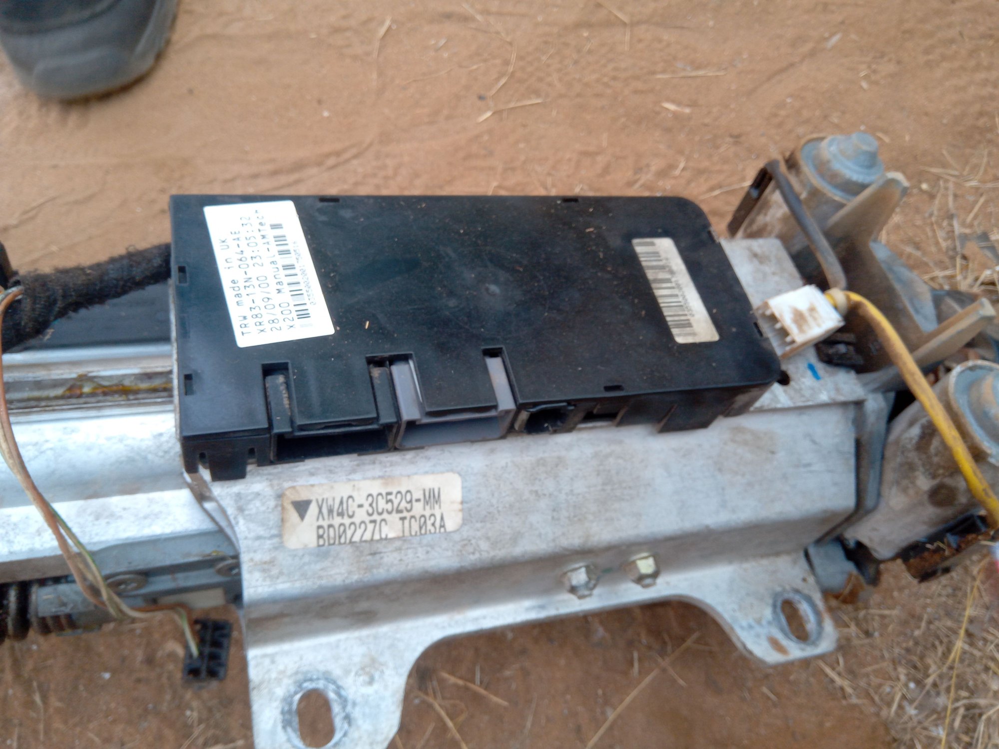

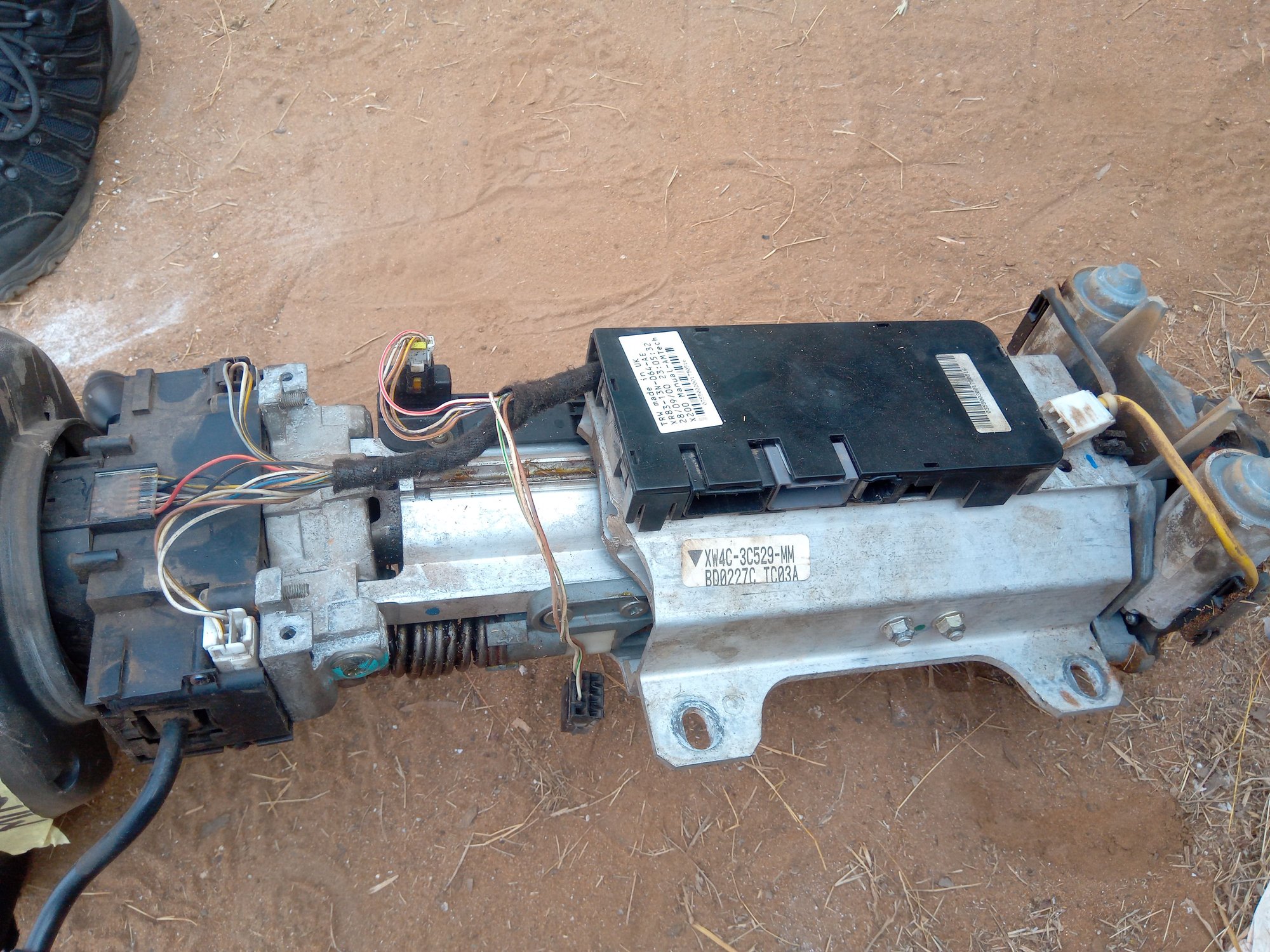

Here is the steering column I have dismantled but I can't locate the barcode, please show me.

That's a blow, take a look for the VCATS label in the trunk, but I'm not sure those numbers will help, worth a try though.

there is no steering column code.

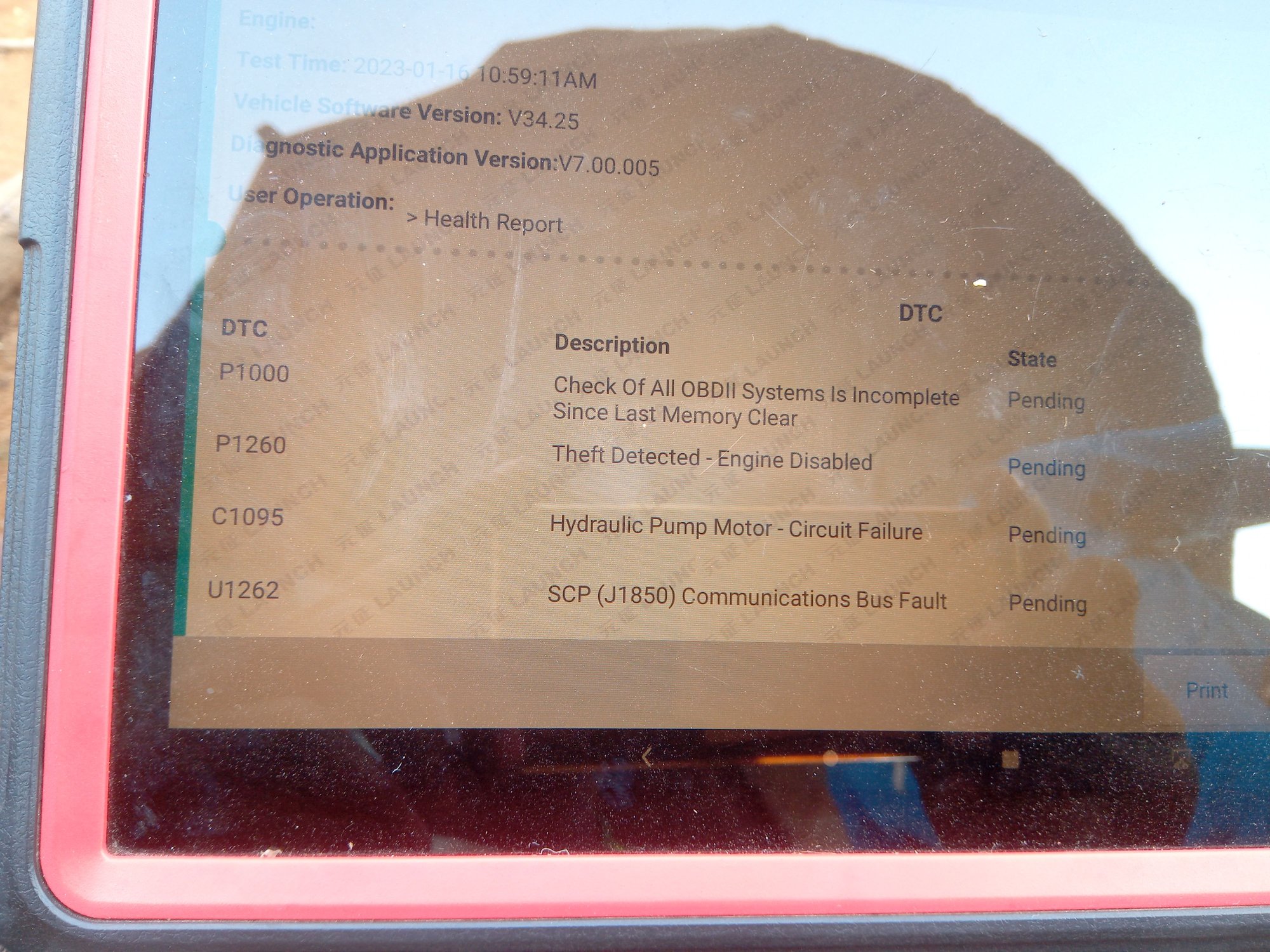

Attach is the code we got.

xalty's Avatar
Joined: Dec 2019
Posts: 3,695
Likes: 1,222
check scp wire harness. if it’s all good replace pcm and ic together
