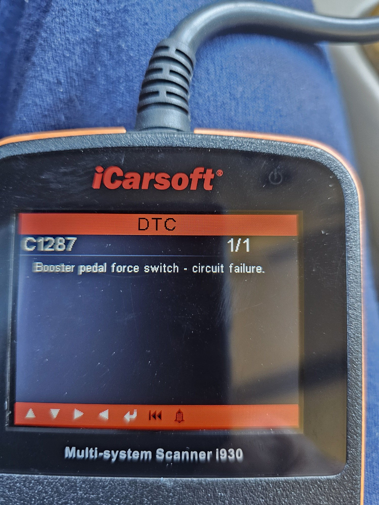

2000 Jaguar S-Type 4.0 Booster Pedal Force Switch
Old May 2, 2026 | 06:19 PM
Choptank61's Avatar
Joined: May 2022
Posts: 2
From: Pensacola, FL
Default 2000 Jaguar S-Type 4.0 Booster Pedal Force Switch
I have no clue what this alludes to. Is this the actual switch or the booster, which I did not know it even had? Could it have anything to do with DSC failure?

C1287 DSCCM Dynamic stability control Active brake booster release switch circuit fault
DSCCM to release switch reference voltage circuit (FH51-40):
open circuit, short circuit to ground, short circuit to B+ voltage, high resistance
Active brake booster release switch failure
NOTE: Control module calibration using PDU is required when the fault is
repaired and the DTC is cleared. MIL will flash to indicate that
configuration is required
