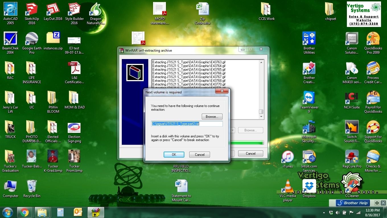

Although I'd love to have all of the JTIS files... I've spent over 4 hours trying to follow the process and have no suceeded. I've attached a screenshot of the message that keeps popping up. Even if I change the location... the same message pops up. For now all I really need is section 211-00 (how to bleeding the power steering system). So, if anyone has a pdf of that section... I would GREATLY appreciate it.
Thanks again to all who've offered assistance but I'm not the most computer savvy person.

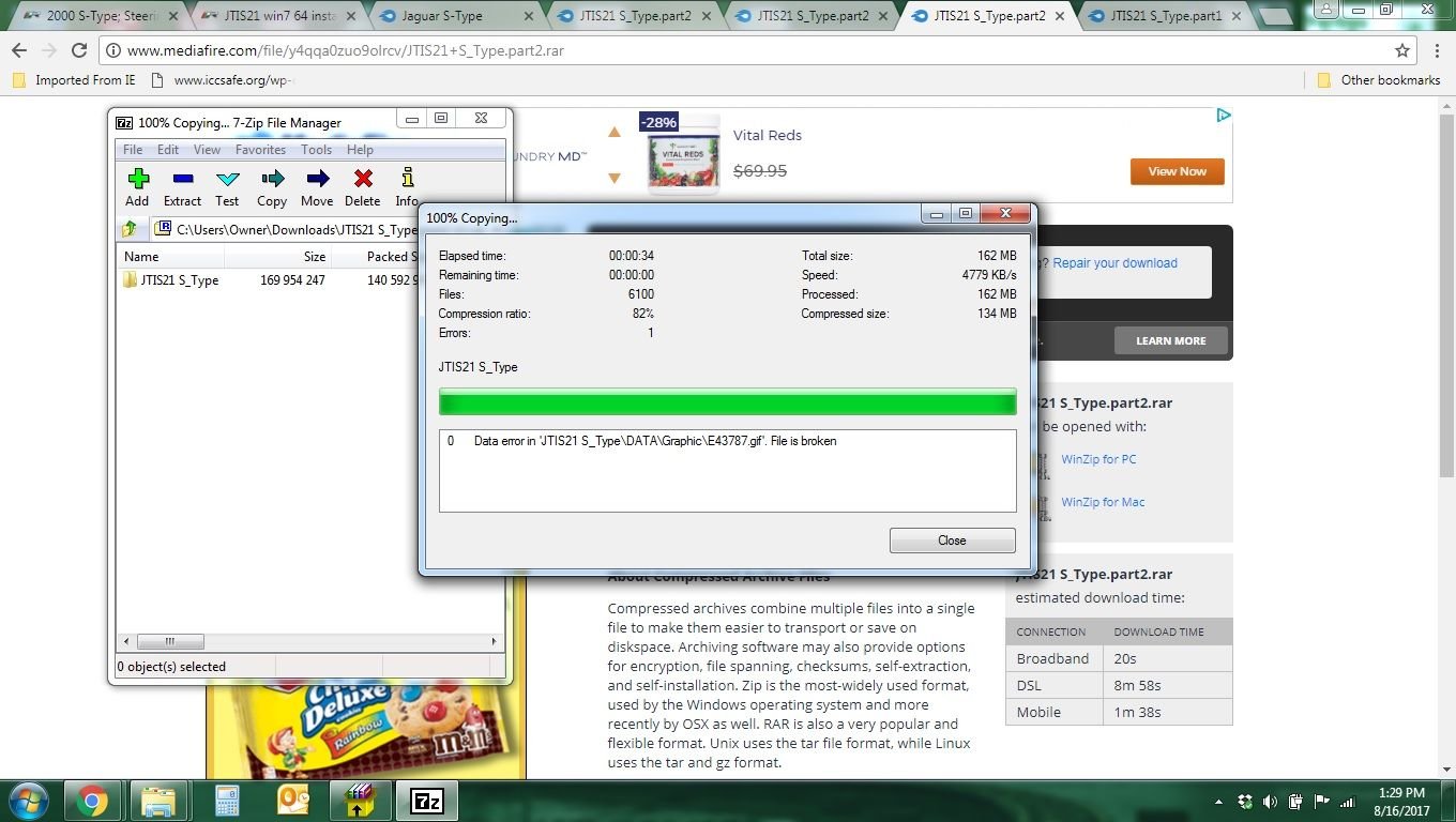

Thanks Norri... I think the problem is that I can not successfully download the JTIS 21 S_type.part2.rar file. Everytime that I try it, I am informed that one "broken file" and therefore the entire file will not install on my computer which of course foils the whole attempt. I've attached a screen shot of that error (in case you, or anyone else has any insight).
