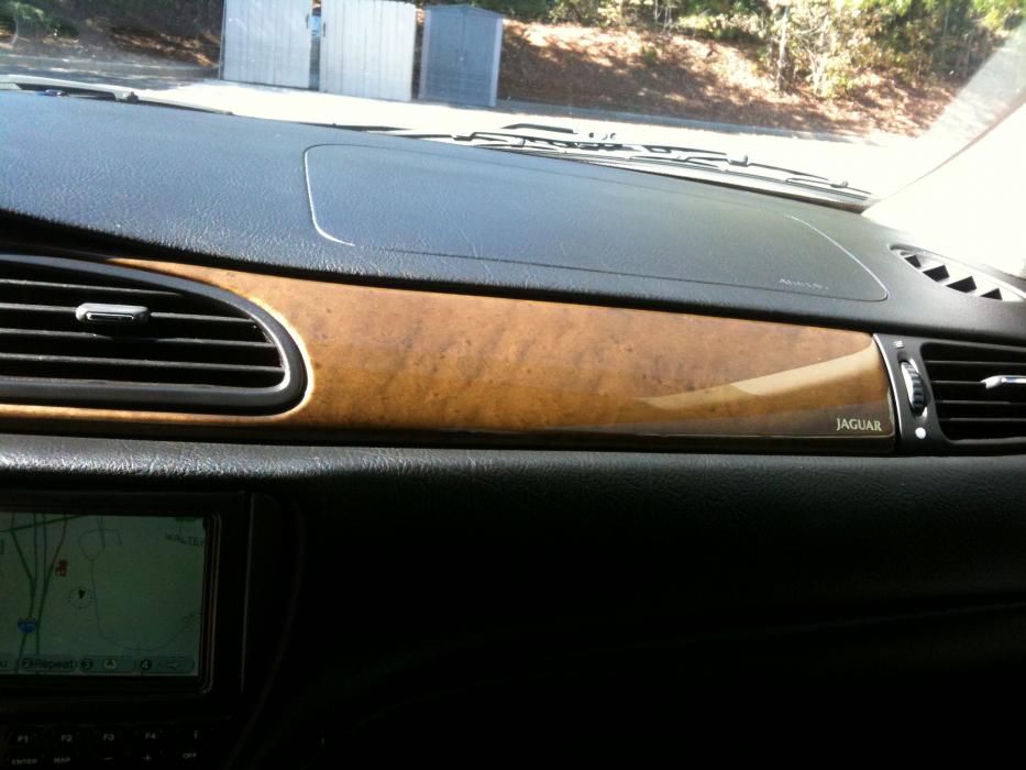

I received my dash wood back a week or 2 ago, and its gorgeous!
I had them do a special stain job to match another piece I sent them.
I'm waiting on felt tape I ordered from the UK, thats why I haven't installed it yet.
I think in a charcoal interior the wood needed to be darker than that honey color anyway.
I'll post pic's when I get it installed, for now, here are some of the wood off-car.
First Pic being "before"...

I managed to extract the vents today (see my thread on the vents).
And installed the new wood.
Pic 1 is Old below, New above.
Pic 3 is lower light, and I moved during exposure, thats why the Jaguar logo is deformed.
I may have the steering wheel refinished too, Madera quoted me $244.
Attached Thumbnails 2000 S-Type Dash Wood restoration info-img_0013.jpg   2000 S-Type Dash Wood restoration info-img_0015.jpg   2000 S-Type Dash Wood restoration info-img_0016.jpg   2000 S-Type Dash Wood restoration info-img_0019.jpg   2000 S-Type Dash Wood restoration info-img_0018.jpg
Last edited by DittoGlen; Oct 31, 2010 at 04:38 PM. Reason: Added comments about pics

Nicely done, new stain color is definate upgrade from stock.

Glen, that definetly looks awesome!! I would have the steering wheel done as well to finish the look.
