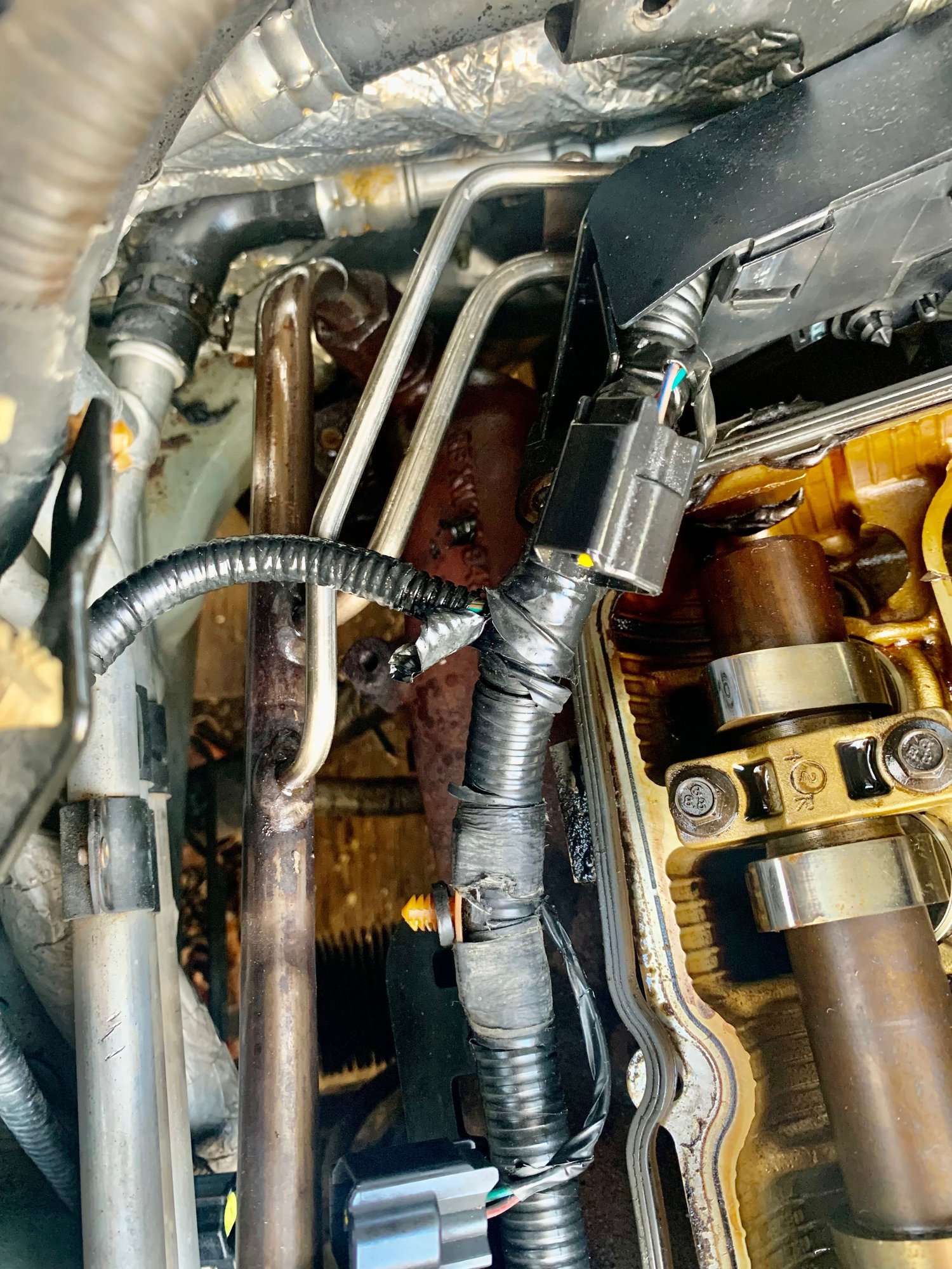

While removing the passenger side valve cover, I barely hit the EGR tube and it cracked above the manifold. Can I bypass the EGR? The tube is no longer available from Jaguar. I would hate for this to be the end of my wife's Cat. She is in a depressed state, and I would like to cheer her up a bit.

Please provide photos of the EGR tube layout so a workable solution can be suggested.

I believe from the photos above I need to remove the cabin filter assembly and maybe some other stuff to gain more direct access to the bolt.

It's difficult to tell from the photos where the EGR tube broke.

Is the tube cracked just above that large nut that attaches to the exhaust manifold? If you brought the tube to a welding shop, I bet it's a piece of cake to repair.

Yes, I have up to 22mm crows foot set and extension, thank you. I believe the 22mm will work but I think I need to remove the cabin filter box in order to get a proper angle on it. Been hitting it with PB Blaster for two days. Hope I don’t need a torch to heat it up to get it freed up. The crack is visible just above the bend in the pipe.
