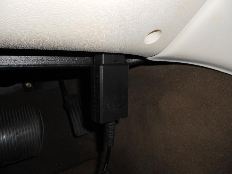

OK. Prior to buying an OBD Scanner, can you tell me where the scanner plugs into the car?? I have looked around the steering column, the fuse boxes, the glove box>>> Cannot find the recepticle for the OBD. Help??

Mack look right around here:
And yes a vacuum leak would throw off your MPGs as many posts here would reveal. A VERY common vacuum leak for your MY (Model Year) is located in this link:
JagRepair.com - Jaguar Repair Information Resource <--Thank you Gus!!!
Go to any BIG box auto parts store and have the codes read for free and post back.
