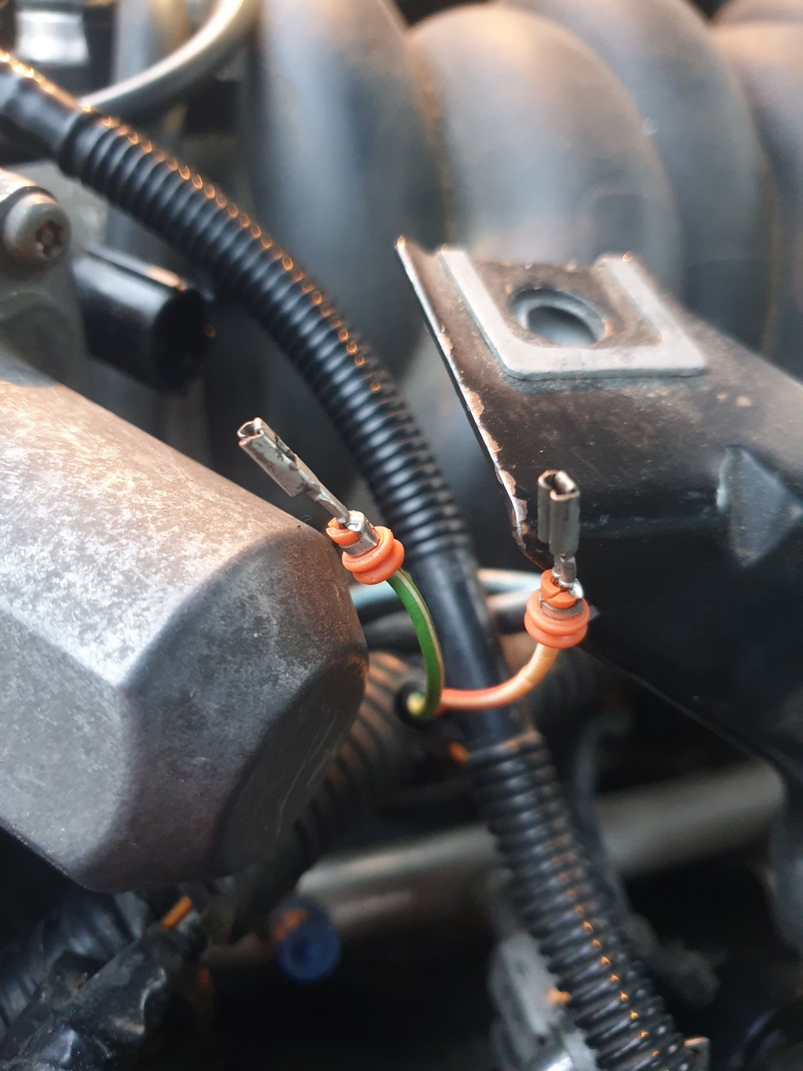

Hi everyone was doing some maintenance on the wifes 4.2
when I noticed the connector plug at back of the throttle body the 2 wire one was broken as I went to remove it the fell apart
Dose anyone know what way the wires go have a spare plug ti fit
Have added a photo
Thanking you
Darrol

red-white is the upper, green-white is the lower.
I just spent quite some time looking for an old thread of mine - it was somehow not easy to find with a browser and I went thru all my old comments on everything:
https://www.jaguarforums.com/forum/s...nector-288221/
I had the same issue and solved it. I added a new inline connector.
