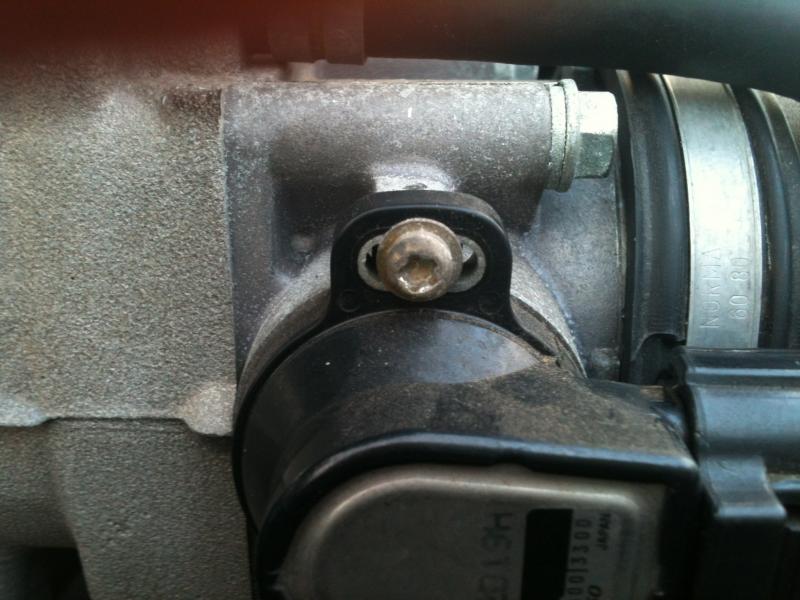

Dear Guys, is this a MAF and if so how do I undo that strange five pointed nut?
The nut you are referring to is a star or "torx" screw/bolt. You will need a star bit head to remove it. The sizes range from T8 - T60
The smaller sizes like the one you are dealing with can be purchased as part of a screwdriver tool kit - the size bit you need is more than likely T10 or T15 - or you can get an assorted set that are attached to a 3/8" drive ratchet, which makes life much easier, especially re-tightening these screws to "spec" - you can get these in one of the big box stores (Home Depot/Lowes) or an auto store.
I recommend you get an assorted set if you plan on working on your vehicle. You will come across these star/torx screws quite a bit.
