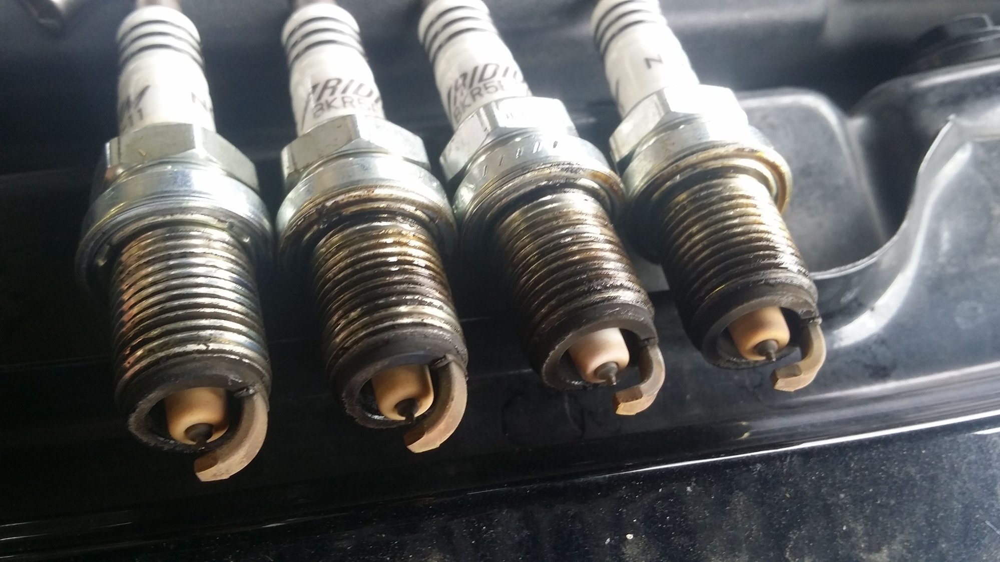

Spark plugs drivers side (us)

Passenger side. Second from the right looks kind of weird. I also noticed on the previous picture that the second from the right looks like it has not been firing as much.

Those plugs don't look too bad to me, if they are less than a year old then that explains why they look so new.

They are probably right around a year old. Just called the shop and they said that the original equipment was double platinum and said autolite, Delco and one other brand made them. Price range from high 4s up to like 7 I think. I have the ngk iridium which is listed in their computer for this car but aren't the same double platinum that oe was. Think this could be a problem. I know some cars (jeep wj) from past experience NEED specific plugs.
