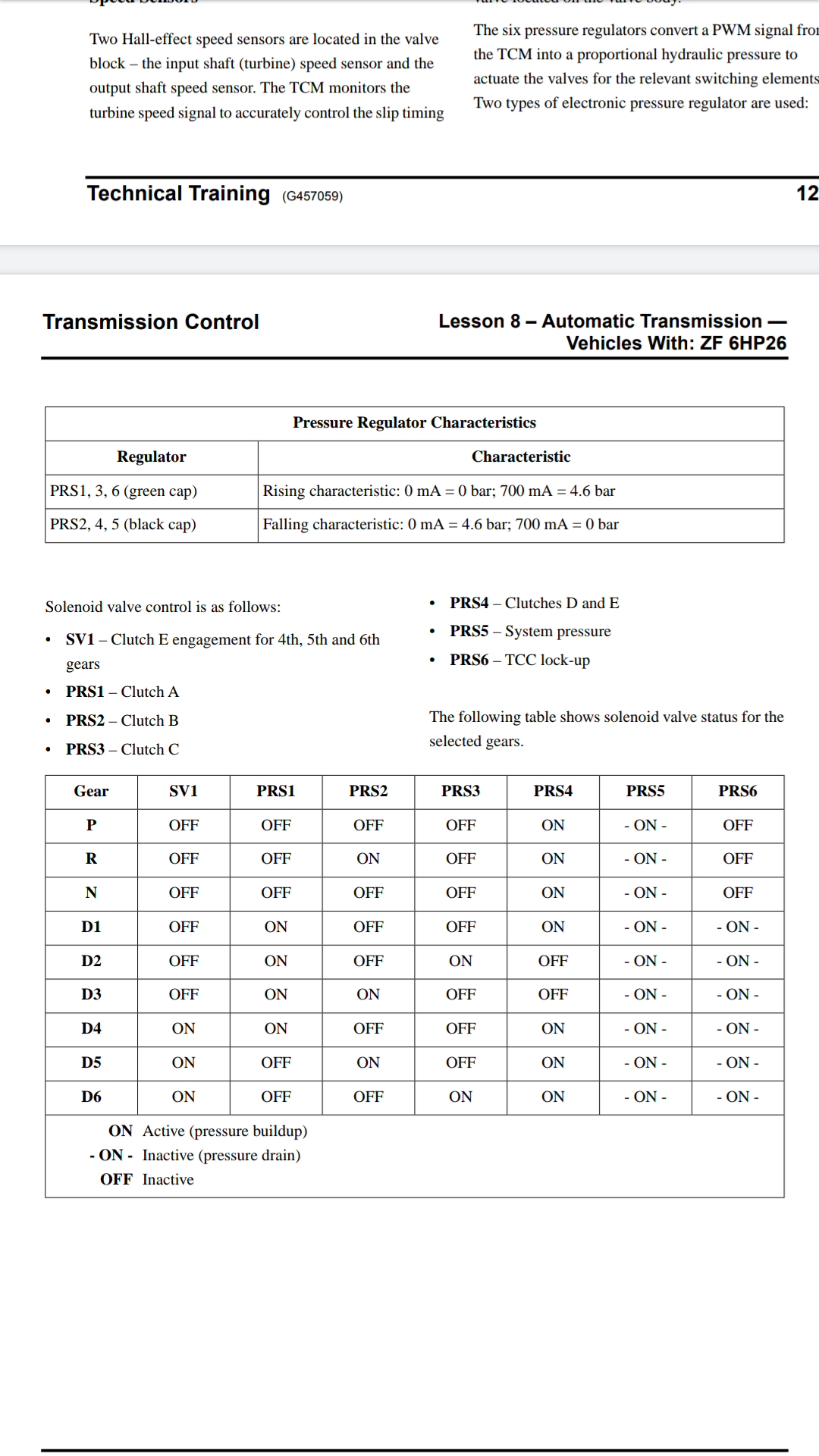

The attached PDF may help in case you've not seen it.
Also, see this at about page 141-on
There's more somewhere I dimly recall but you my have to search hard if you need any more.
So, I'm looking at this excerpt... Maybe there is more or better info between p141 and the beginning of the manual trans section, but I didn't see it.
It's not easy for me to make the connection, with the data given, and which clutch pack and I assume, related solenoid, with the "code" they are using here...
Is this saying that when in GEAR D2 (is this 2-3?) that PRS1, 3, 5 and 6 are involved all at the same time? If that's the case it would be tricky to figure out WHICH it is that gone south...!
