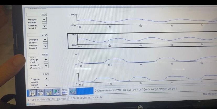

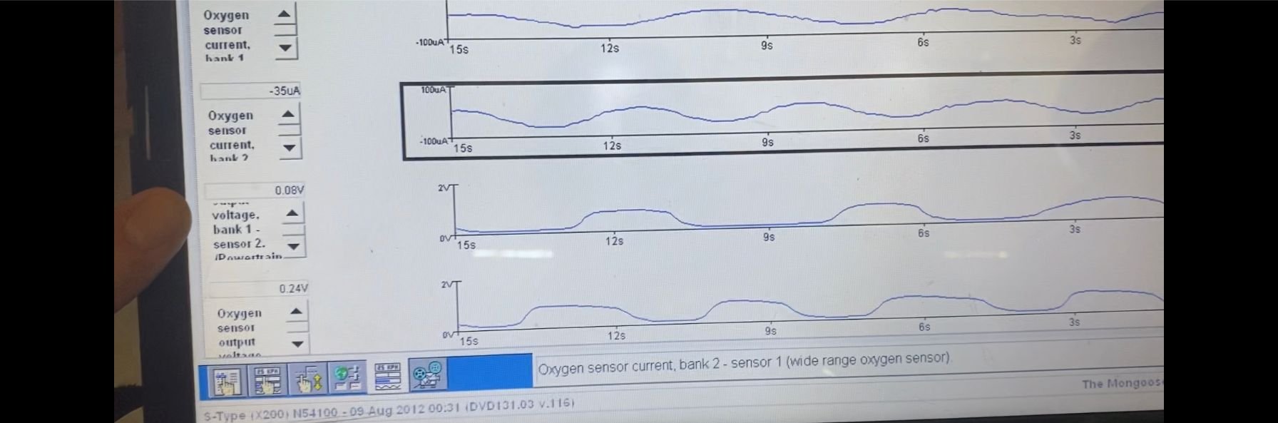

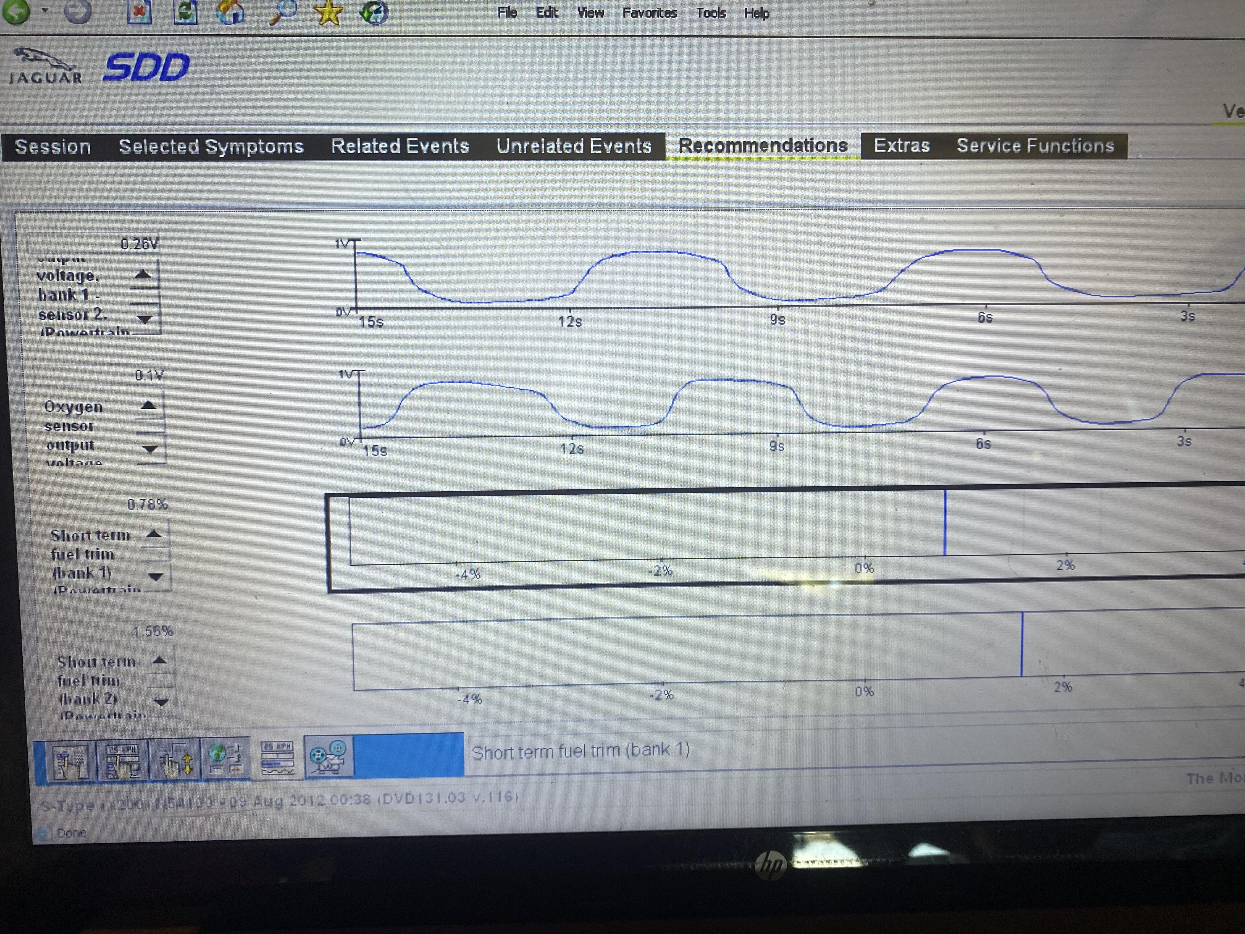

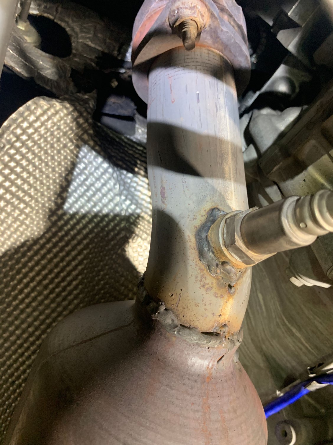

Trust me. you do. Its very tiny so the car doesnt seem to run bad. but its slowly changing your stft and then it thinks the cats are not work right and flags the code. I have NEW CATS on my car. I still get the code once a month and then it goes away. This past week I went at it full bore and found my bank one o2 sensors are slightly biased negative meaning its slightly lean. It never throws a code for STFT. I only get the P0420 code. Today I may have found it. I put the Bank 1 and Bank 2 Sensor 1 and sensor 2 signals up on SDD and tried spraying carb cleaner in various places and yup, its at leak. I foubnd the injector orings for two ports register a leak when i hit them so i kinda pressed the injectors back into place and gave em a lil twist and it seems to have fixed it. I will know in the next few weeks.

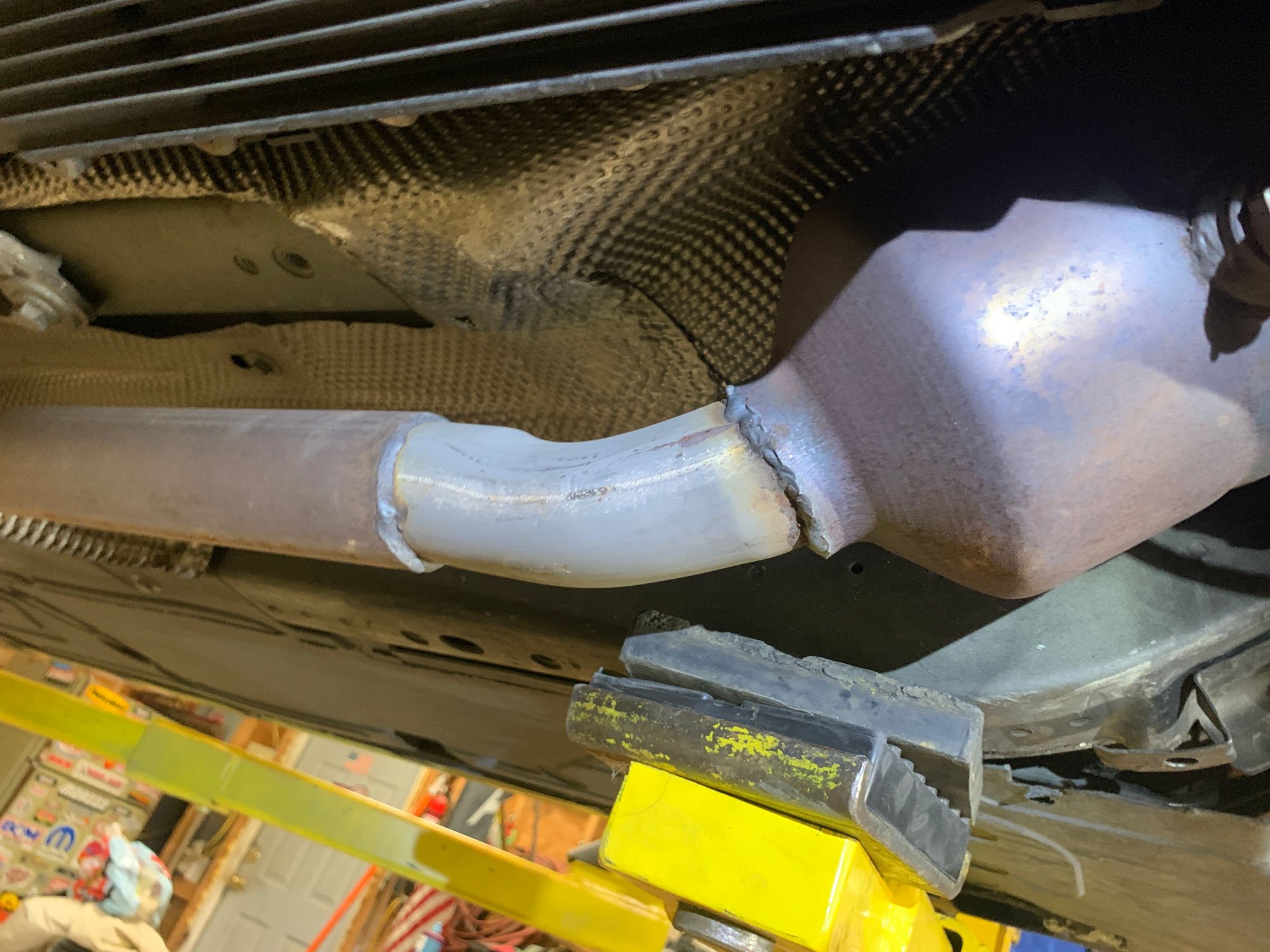

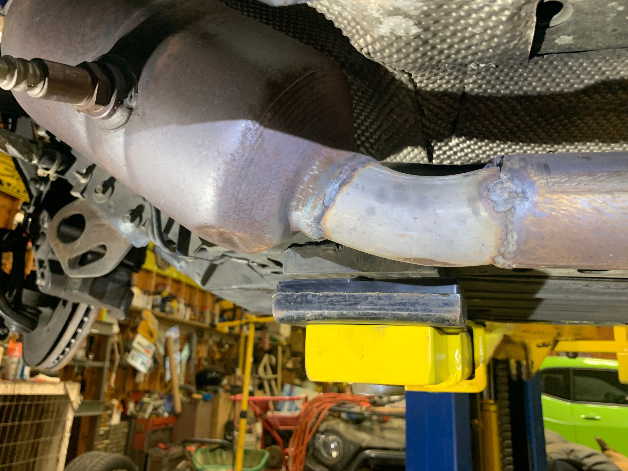

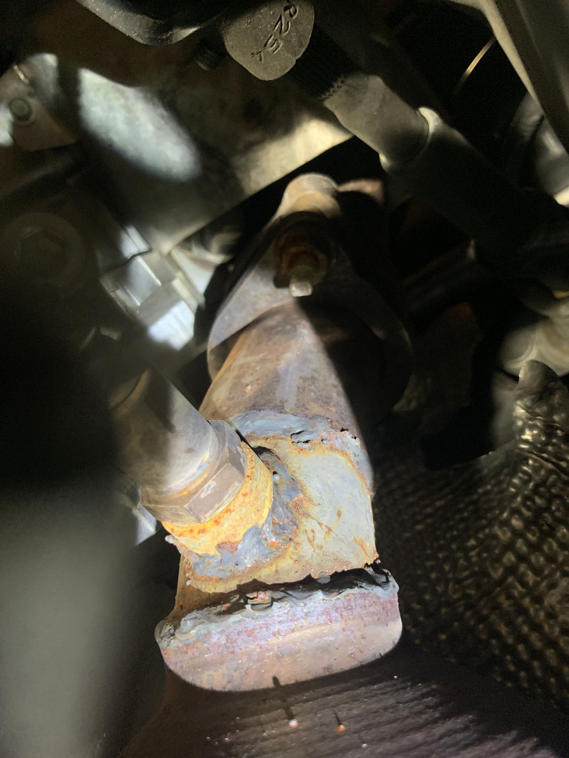

I know the cat pipes I got from rock auto were only $200 each but they arent as nice as the stock pieces. UNFORTUNATELY a previous owner jacked up the stock pieces by welding in new cats using a much small inlet and outlet tube so i had reason to change them anyways.
Heres some pics

Pics.

Heres what I saw on my o2 sensors
Attached Thumbnails 2005 Jaguar stype 3.0 v6 catalyic convetors swap with magnaflow-babef419-3d1e-4a69-9709-7af5b90bdb6e.jpeg

and i only have a foxwell 520pro. i can pull a o2 data log on it and review from when i drive but what is it have to look for? what ranges seem to indicate a vacuum leak? and due that weld job looks horrible lol!

what I noticed was my bank 1 graph was switching as it should as you can see but when I narrowed down the Y axis to get more resolution, I could see bank 1 was averaging lower than bank 2 as if it were offset very slightly. I dfont really have pics of it because I was taking video at the time and they look like crap.
But heres the thing, I would never have thought htere was problem because my numbers were all reasonable and in the correct range. It was only when you compared bank 1 to bank 2 that the offset was seen, Had I not had a Bank 1 P0420 code, I wouldnt have though tanything of it but i was specifically ;looking for a difference between banks 1 and 2 and the switching frequency and offests were the only things I could see.
So today I went back in with carb cleaner and started spraying tiny bits here and there to see when the STFT or the O2 sensor voltages and currents WIGGLED slightly telling me it sensed the carb cleaner.
You really need a runtime plot to see it
