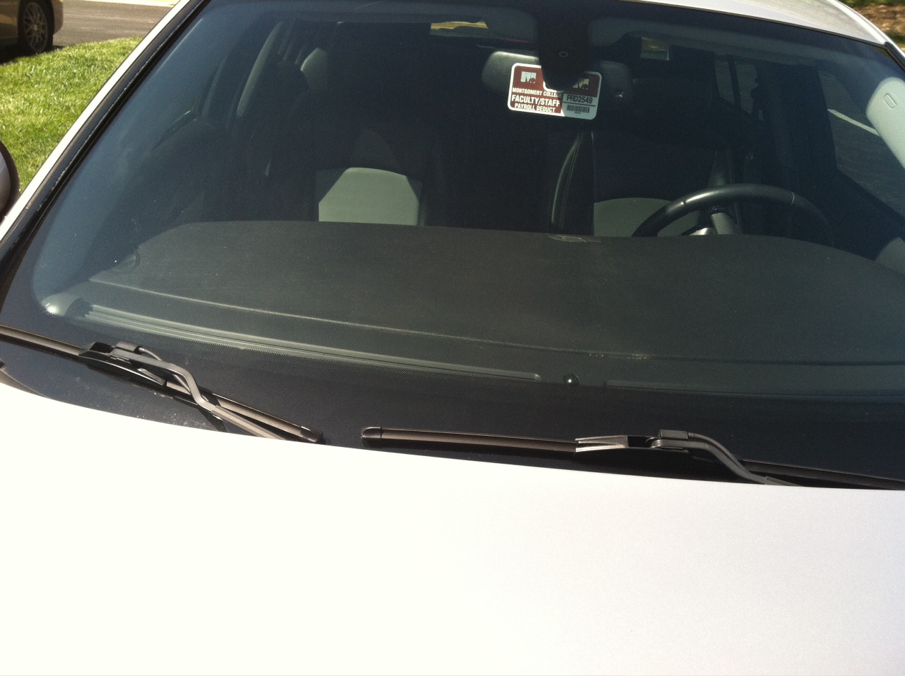

I cannot speak for the majority of individuals. I came across this post because someone needed help. I have "proven" items that work and have offered that information in complete confidence that should someone order the product numbers I've offered, they will have success. The cost is minimal. 7 dollars plus for the 19" and a little more than 10 for the 24".
If you would like to use nappa products, help yourself. I have never used the Nappa product but can tell you for sure, rain-x does not work. There is another part from Trico that work and I have them on my 2005 STR right now. I'm posting pictures of additional trico blades that I have on my 2005 STR right now. Its a free world. You're free to take this advice or keep searching and discussing..... possibilities. I wish you well no matter your choice.

Oh and by the way, the blades I posted pictures of are not listed anywhere as 2005 Jaguar S-Type R compatible, but I have them on my car now and they're a Perfect Fit. Here's pictures.
Oh, and these cost more than the ones in the thread that I have attached with the prior Trico part numbers. I don't know how long these last as I've just put them on two days ago. The others lasted close to a 7 months, that the 7 dollar plus and 10 dollar plus ones. Price was more around 37 to 40 for the pair

For the record also, neither of the Trico's I've mentioned are "INSERTS". They are entire blades with rubbers attached to them that mount directly to the 2005 STR with the "rare" window washer nozzle. I never mentioned Trico and refill in the same sentence. If you look up the part numbers I've provided, you'll see they're not inserts.
