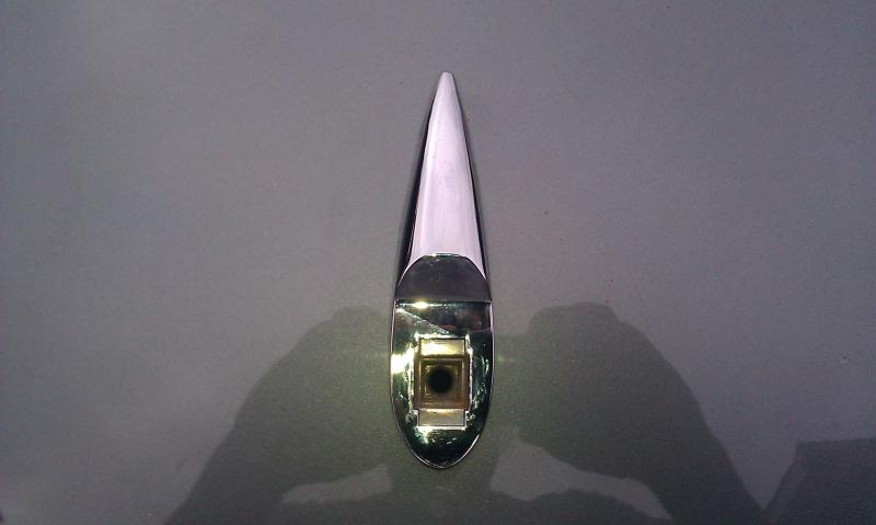

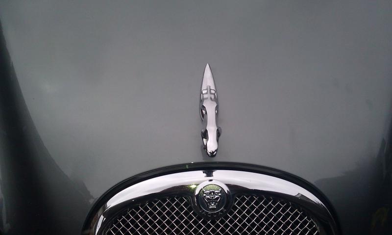

Good afternoon everyone. Ok....so today - roads are clear, dry...and I thought...gonna take my car for a wash and clean her up! Get home...start to polish the lights...then I start to polish the Jaguar Cat...all I did was move it left to right...and it felt really loose...them BAM....it fell off!! I hope there is an easy fix to this....
I have attached photos...and all I could see is that the wire rusted itself in half causing my CAT to fall off! I guess I am lucky it didn't just fall off on the highway...or something....
Thank you once again for all the help here....much appreciated!!

Mine did the same thing last summer, I also felt fortunate that it came off in my hand and not hurtling through the windshield while at highway speed. It seems that the OEM wire is not corrosion resistant, a silly oversight on their part.
I used stainless steel braided picture wire and aluminum (yes, I know galvanic action) sleeves crushed tight with pliers. All found at the local hardware. The only fiddly bit was holding the wire tight to compress the spring while crushing the sleeve. An extra hand came in handy, SWMBOs were well suited. Just for belts and suspenders/braces I put a second, slightly looser loop of wire just incase the first ever comes loose.

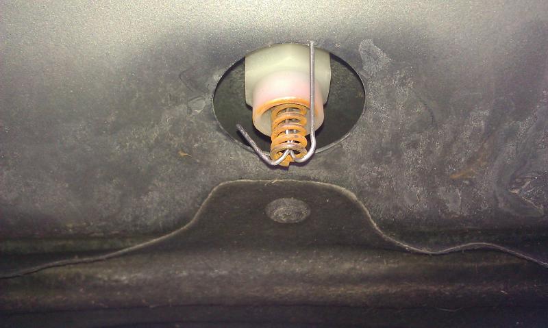

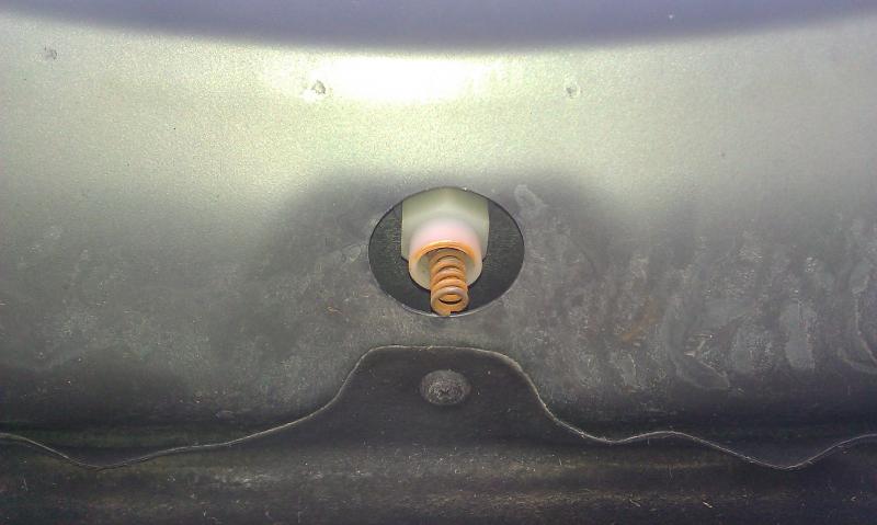

Thanks! I was reading some other people that had this issue when i searched - and I used a large paper clip!
I have attached some images....it seems to be holding pretty good for now....?

Very resourceful! Looks like you might have lost the cup like thingy that fits at the lower end of the spring. Might be in the engine bay or sitting on the driveway.

Hello! That cup thingy you are talking about....isn't that the thing in my first post which is around the wire? I took off the paper clip....Didn't feel safe with it....
What a pain....I can't seem to figure this thing out....would the dealer sell something to fix this cheap? With my luck the whole thing has to be ordered...
Any other ideas to fix this?

looks rusted out big time.....

Your paper clip deal seemed to be fine.
If you don't feel safe, how about two paper clips?
Or, a paper clip and a backup made from fishing line?
