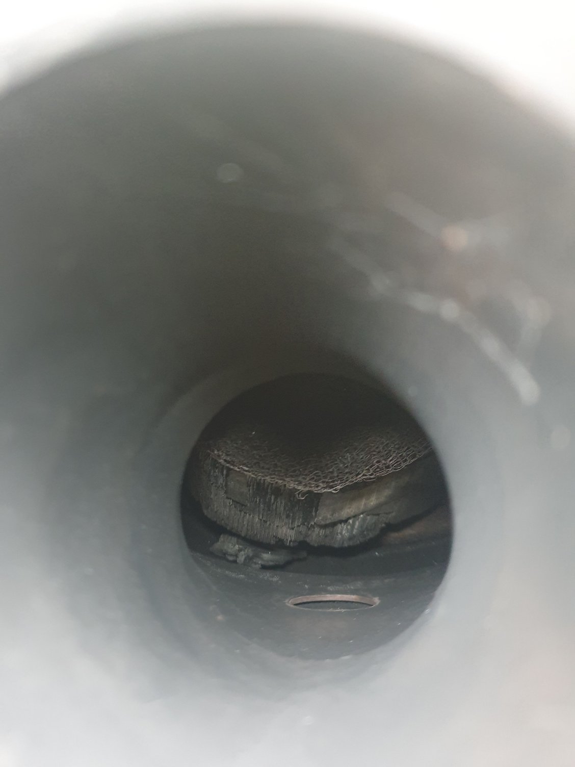

well after getting restricted Performance light
And the following codes
P1647 02 sensor pre cat
P0302 MISFIRE CYLINDER 2
P0306 MISFIRE CYLINDER 6
​​And found all plugs on bank 2 black and stooy
after replacing all four 02 sensors at over 3k
Still had restricted Performance
So I bit the bullet and decided to remove downpipes
And found i have a stuffed catalytic converter
My question is
Part number for my vehicle is vin m45255
Xr845111 none available in New Zealand
just wondering if
One from vin n52048 part number xr845979 will fifit
Thanking you
Darrol
