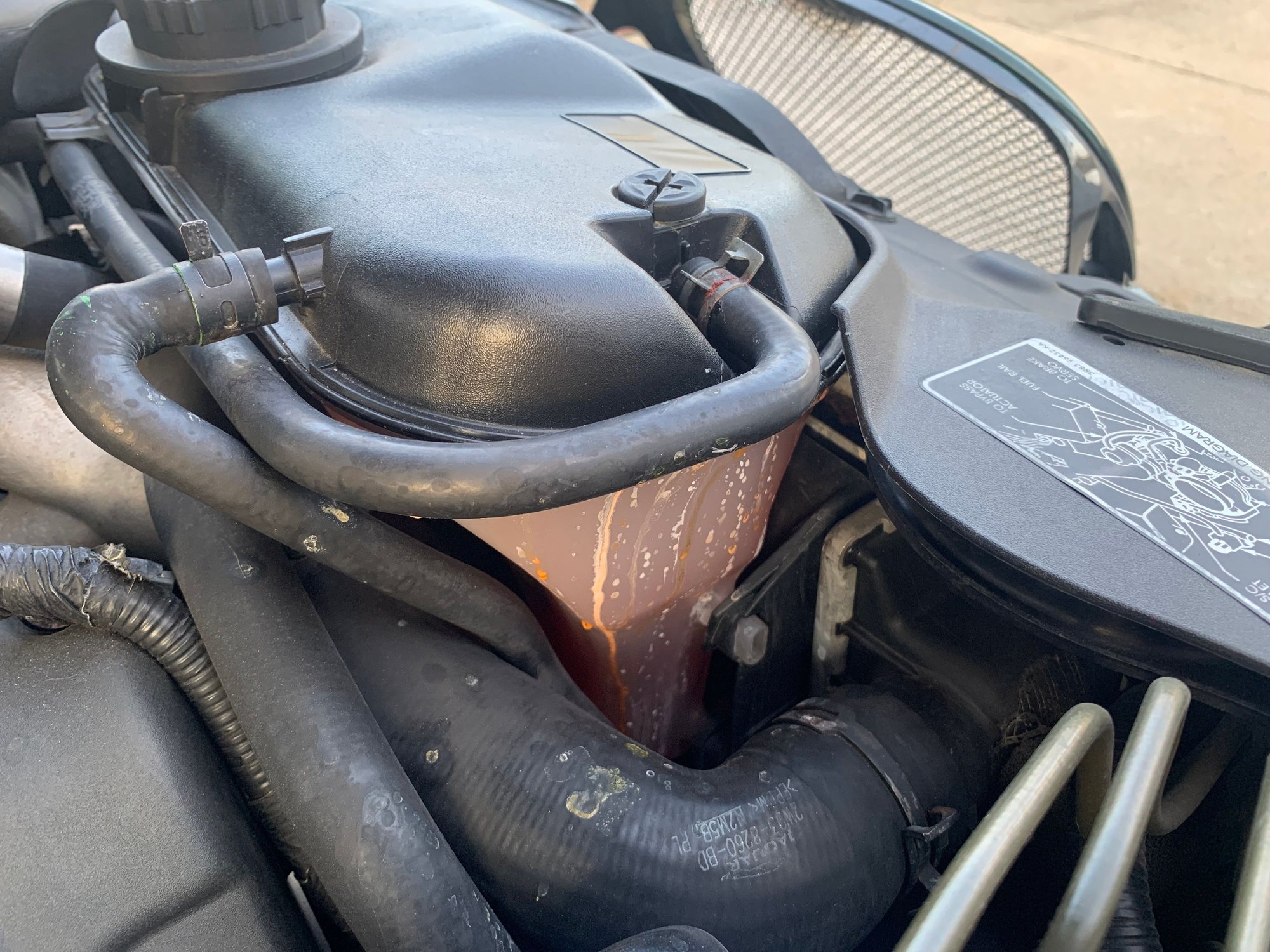

I was looking into coolant reservoirs for S-Type R's (and S-types in general) and have read the multitude of threads regarding issues with them cracking/leaking. There are symptoms of that on mine, but not near severe enough to bother with yet. I did come across this though, has anyone on the forum tried one? Seems like the way to go given the issues of the factory unit.

I've looked at a couple of these aluminum tank ads and I think what might be a problem is no provision for the level sensor. I took a closer look at mine today after work as its been getting pretty hot outside this weekend/week. The car temp is good but the coolant smell is present. I can go a couple hundred miles without a low coolant notification. After looking closer I might actually replace sooner rather than a potential catastrophic later.... I do not think I'm going to take a chance on one of these aluminum ones yet.

Also, ordered up a genuine replacement tank in lieu of the aluminum one specifically because of the level sensor provision.
