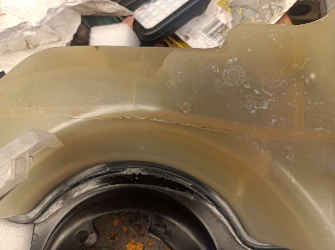

An example of Peter's suggestion (Suspect No.1) is a photo of the bottom of my coolant tank that I recently replaced, taken looking at the bottom of the tank. That crack cannot be seen from above the tank and, to me, is terminal. I wouldn't trust a repaired tank. New tanks are available on Aliexpress for sensible prices.

Yes, my X-Type tank has similar cracks, also underneath.
I also would normally not have considered trying to fix this.
But the PO (previous owner) of my X-Type fixed it - with what exactly I cannot be sure.
It seemed to last. Just to be sure, I put anopther layer of liquid metal over it.

A weak point is the plastic coolant reservoir - I had a slow coolant leak and we traced it to small hairline cracks on the underside of the coolant reservoir which allowed coolant to slowly leak. Check it out - it's the most likely culprit if you're having issues tracing the leak source.
