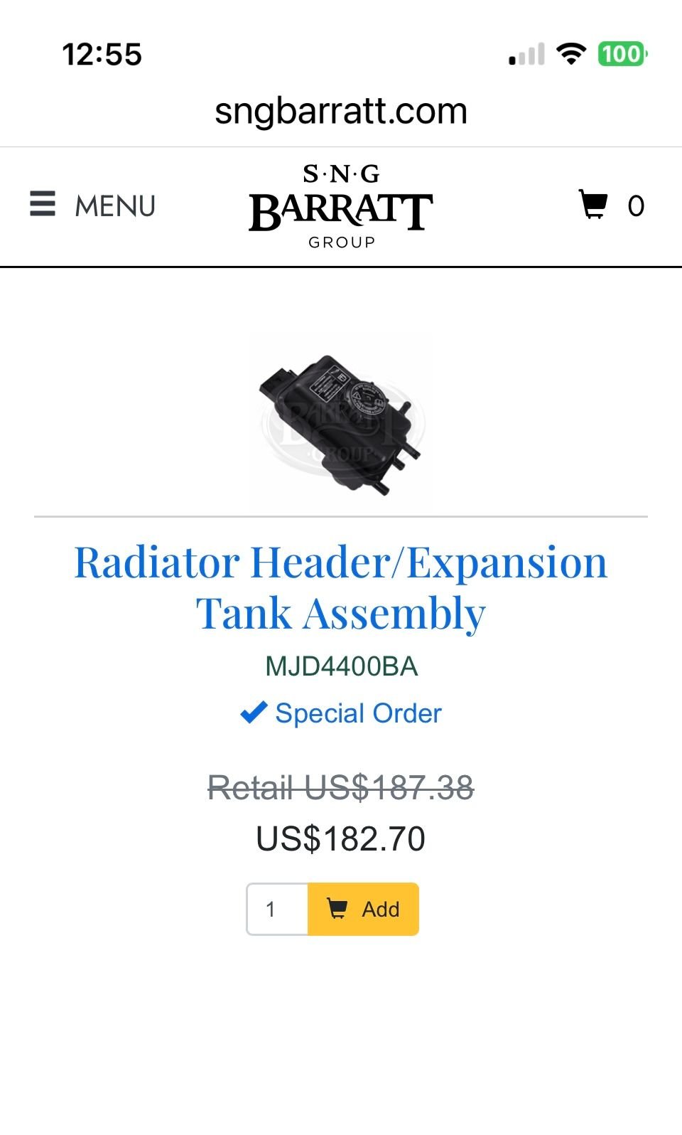

I just use the terminology that SNG Barratt does in their parts catalog. If they don’t know then who does, out side of the manufacturer.

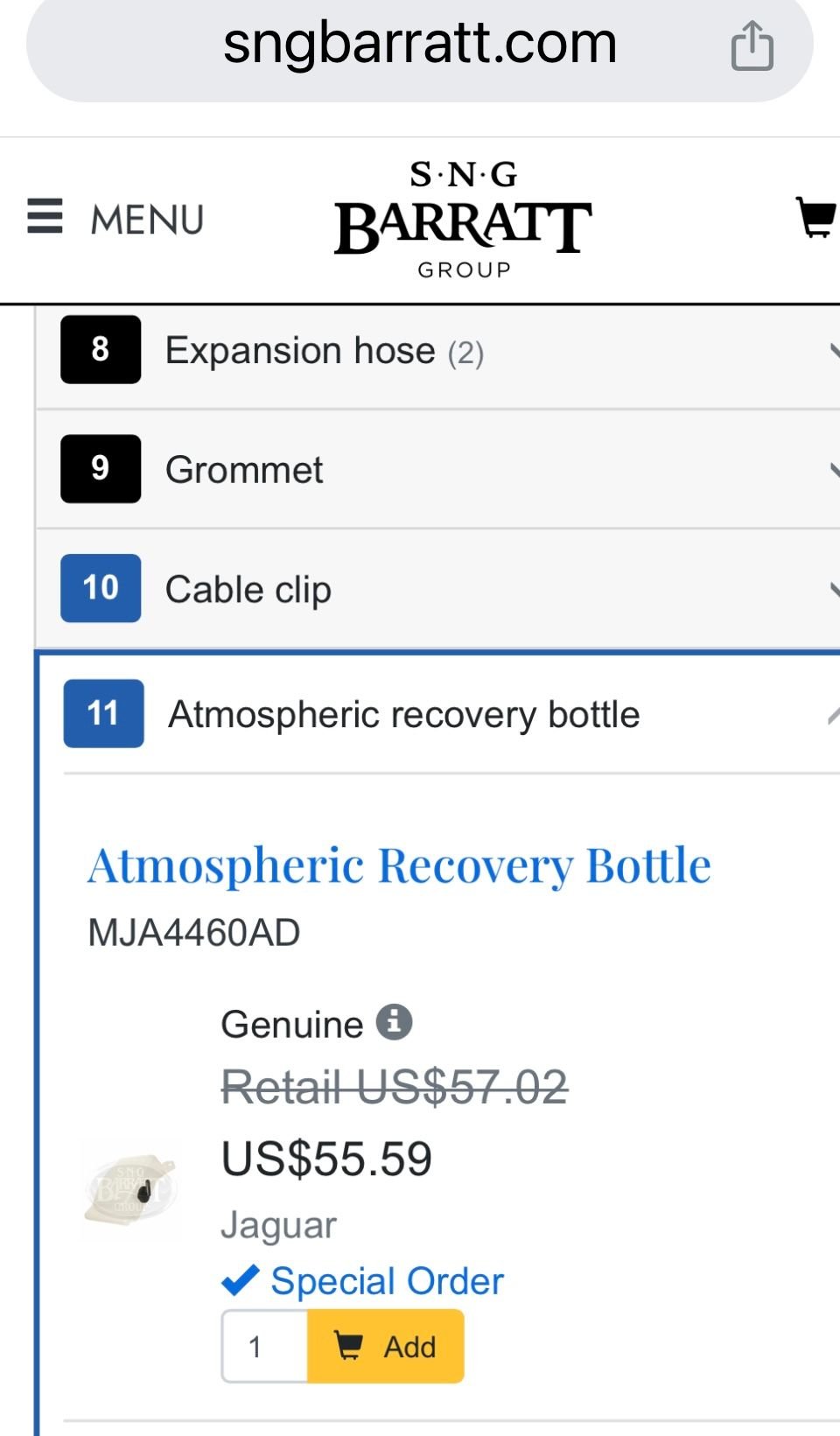

Old Jan 18, 2024 | 05:36 AM
michaelh's Avatar
Posts: 4,778
Likes: 2,993
From: Jersey, Channel Islands
Attached to inner wing/firewall on LHS = "Coolant reservoir"
Under front wheel arch = "Atmospheric recovery bottle"
...says JEPC / SNG Barratt.

Old Jan 18, 2024 | 02:02 PM

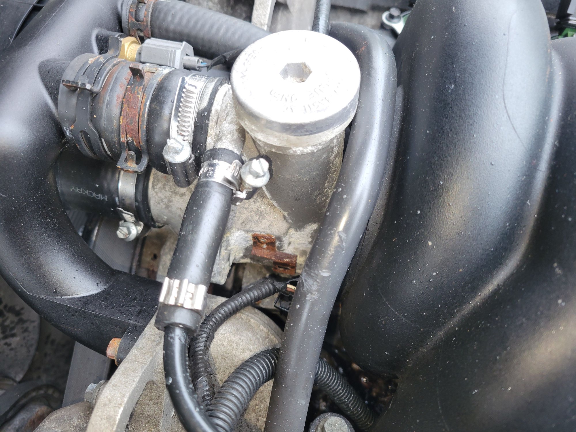

From: FL
The ATMOSPHERIC CATCHMENT TANK needs to be blocked off when performing the pressure test!!!!!!!!!!!!!!!!!
Thank you for that advise. I blocked off the overflow and found the leak. Its under the unit in the picture. It looks like some kind of water distribution unit.
In the middle of the unit in the rusted area its spraying water.

Took it apart and it looks like the thermostat housing gasket went bad.
