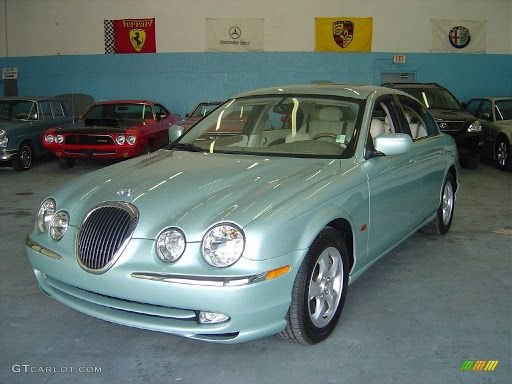

As it turns out, I'm going to need the Jagdroid! I was looking at non-Nav unts but a car came up with super low miles in Seafrost, which is one of my favorite colors so I jumped on it and worked out a trade for my car. The car I swapped was an MR2 Spyder and it's dollar for dollar the most fun car I ever owned. There is something about the high reving engine sitting right behind your head urging you to break the speed limit combined with go kart like handling that is just a riot. (Sadly, I need two new knees and a shoulder surgery so an automatic will suit me better in the long run.) Its loud and its has no luxury. The ride home was, as you guys know, completely different. SOOOO freaking comfortable and quiet! I'm not used to sitting in a sea of leather and burl wood, About the only luxury missing (other than an up to date info sysem) was the car opening a secret panel in the dash and offering me a fresh espresso!

Glad you like it!!
I agree very different to an MR2 Spyder!!
What year is that car? If you look at the VIN number the 10th digit will give you the model year of your car.

That looks like a MK1 S-Type looking at the alloys and grill, if so, Jagdroid won't fit ?

A nice looking car. Even nicer if it has the V8.
Looking at he mirrors and the grill it appears to be an x200.
The S Type looks good in the 'Seafrost' colour.
Don't think the aftermarket Jagdroid would work on the x200 Sat Nav.

it is a V8. Now I need some throatier pipes and the Mina Gallery cold air intake for sound. 😀. I’m going to reach out to them to find out what will work. I have an FM Transmitter in there is the mean time but I’d love their Apple version if it will work
