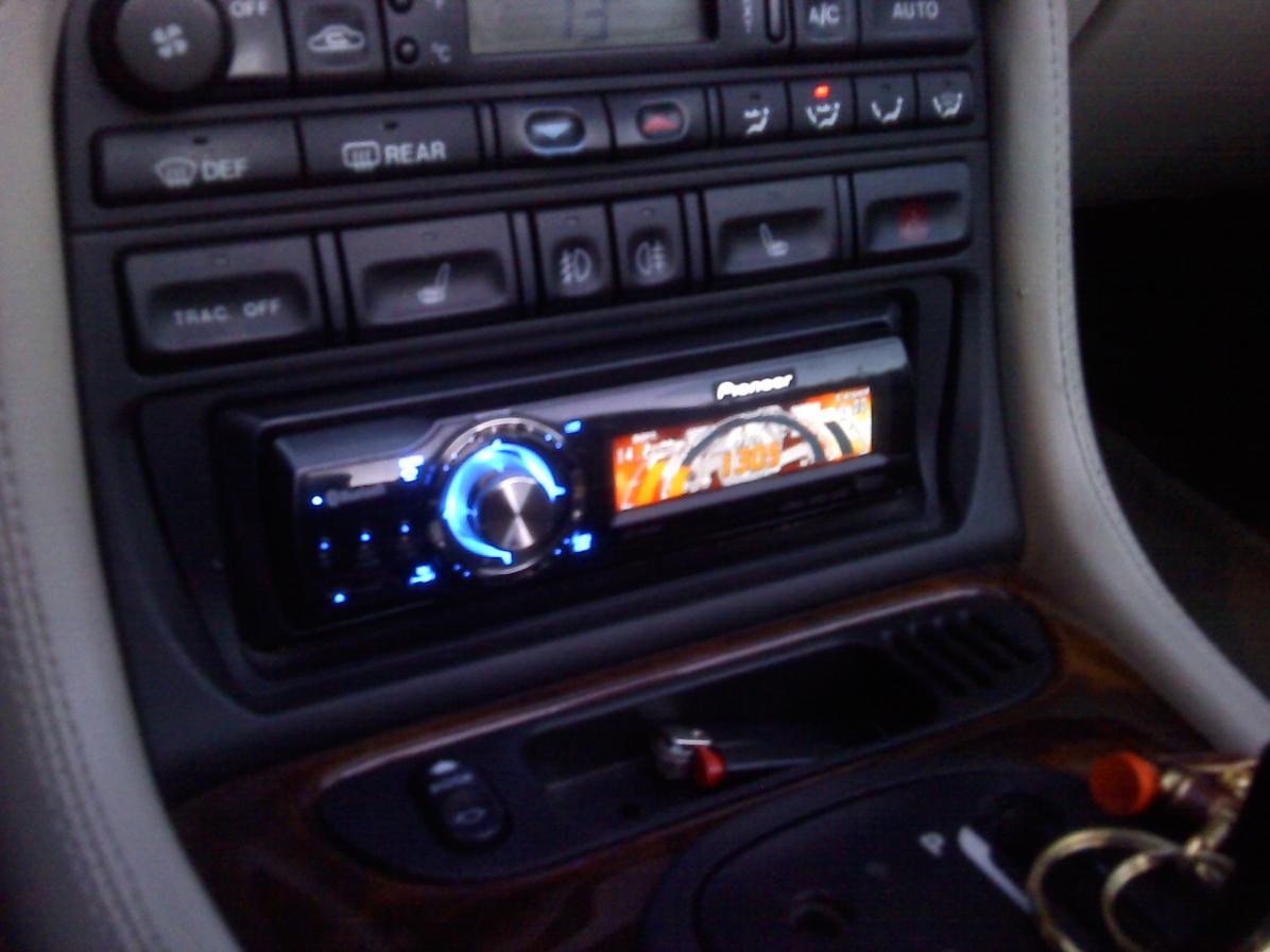

Crutchfield has connection adapters available for jaguar XK8 because that's where I got my pioneer from. And I got the adapter from them, I had to send them the schematic to make sure they had the proper one. I thinks it also worked for Fords. I made a special adapter for the 1.5 din opening so I could get it to fit but you can use pretty much any stereo you want.

Do mean the connection harness..that allows you to connect the aftermarket head unit to the factory wiring?....you got that from Crutchfield ? What about steering wheel control adaptors, that allow you to control the aftermarket head unit from the steering wheel controls...any luck finding one those ?
I'm now seriously considering the new JBL MS-8 that was just released or the Alpine PXE-H660. They are both factory integration units that allow you to maintain the factory head unit and also retailor the audio system. Leaning more towards the new JBL unit.....looks real good from what I've read...

Yes, the harness connects from to the main unit and uses the 4-channels output side of the stereo as signals into the factory amp. I believe I did have to cut the factory harness off and make the connections to the main harness. It also has level adjustments built in to each of the channels so you can limit the max volume. They also have adapters for the steering wheel controls but I never installed one, the knob isn't that far away.
I did mine a while ago so I hope everything is accurate. Don't have any of the new usb stuff but mine has the bluetooth phone and audio. So my phone actually connects via bluetooth and my music on the phone plays through the stereo, much better than IPOD in my opinion. It's awesome, no wires and all hands free. I kept the original stereo in case I sold it and they wanted the original. Use to drive me nuts with the auto volume correction. Stereo constantly changed volumes based on speed not noise and no way to disable it.
