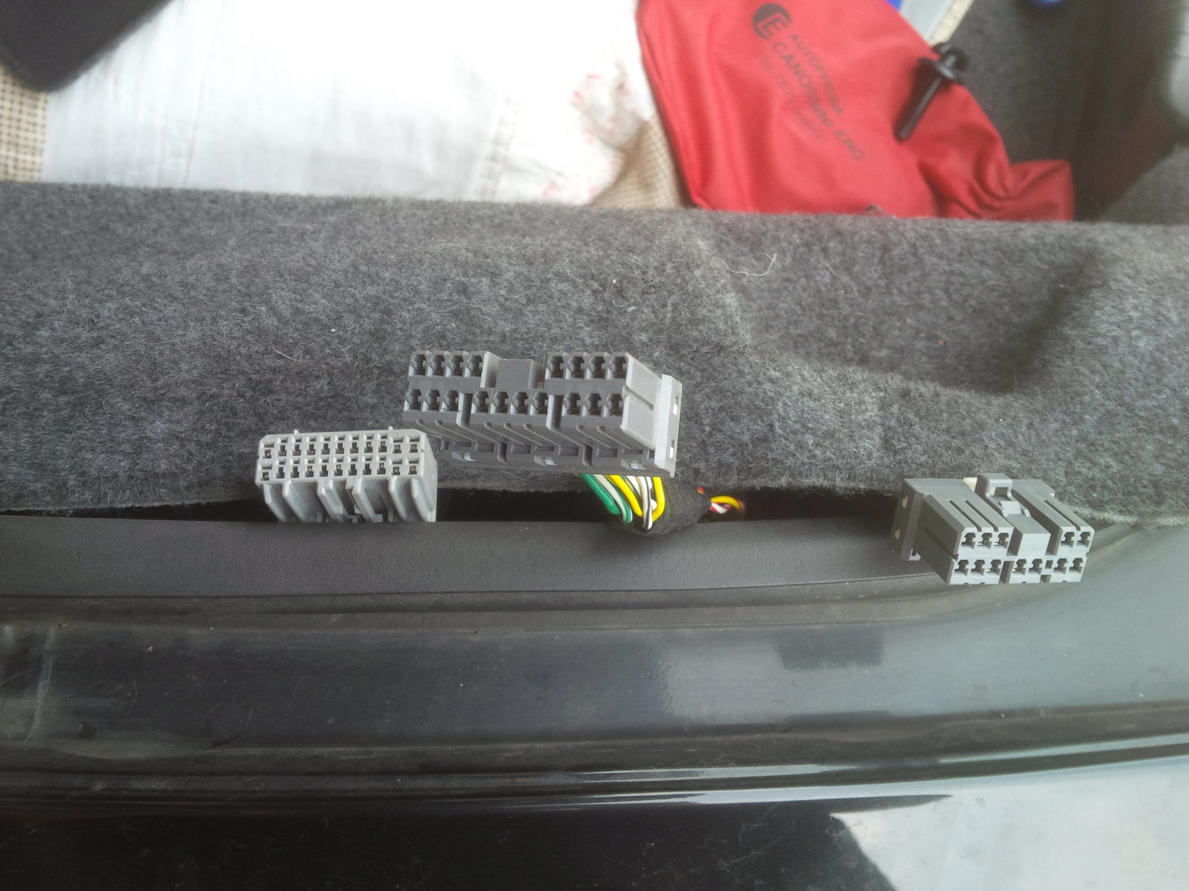

I have a S-Type year 2004 with Navigation System (please see attached picture).
I really would like to add an AUX input maybe cheating the CD-Changer connection, but I don't want to unmount all the cockpit to reach rear connectors of the Navigation unit.
I saw in the truck near the DVD reader of navigation system some connectors (please see attached picture); hopefully one of them is for the CD-Changer.
Is there around any adaptro that has compatibility with those connectors, so it can be installed in the truck and provides an AUX Input?

Thank you so much for this "decisive" answer.
(I wrote that I looked around, also with IPOD key, but honestly I didn't find any thread were I was able to match exactly my NAV system, since afaik the year my car belongs is a transitional one between two systems, so that's why I preferred to post the picture)
Out of curiosity: what are the connectors I shooted used for, then?
Frankly I don't know.
But read up on the Jaguar ACM interface on here. There's even a link to a copy of the installation manual and operation guide as well I think.

I don't think it is. Not at all. There was no transition. You either have 2002.5MY+ with fibre optic etc or you have earlier. You have 2004 so that is that.
JTIS has the Electrical Guide, which includes the connectors. It also shows the fibre optic items.
