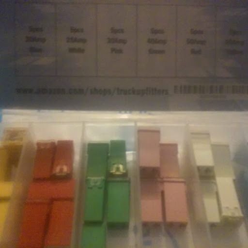

Thank you,very helpful video,easier than trying to understand the manual. this is the fuse assortment that i got from amazon for $34.95,30 pc.not oem but better than a blown one.
