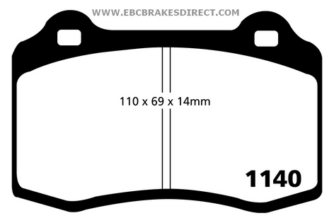

Rear Pads
OEM, from Jaguar
Mintex, (OEM supplier?) MDB2221
EBC, Redstuff or Yellowstuff
Ferodo, Premier FDB1949
Akebono, Euro Ultra Premium Ceramic
R1 Concepts, offers OEM, Posi-Quiet and Stoptech
Centric/Posi-Quiet, Ceramic, or Metallic
Centric/StopTech, "Street Performance"
Brakeperformance, "own-brand" Semi-Metallic (prob. Centric)
Brembo, HP2000
Hawk, HPS, HP Plus, Perf. Ceramic
Pagid, RS, RSL, RST
Raybestos, ST-41, ST-43, ST-45, ST-47
Porterfield, R4, R4-1, R4-E, R4-S
Apparently the rear caliper is shared with various Ferrari's, Lotus', Volvo's and the Brembo A, C, or F Caliper Family Gran Turismo Kit, hence the greater selection of pads available. No rear pads from Pagid.
So that's all I could find, if there are any i've missed let me know...
