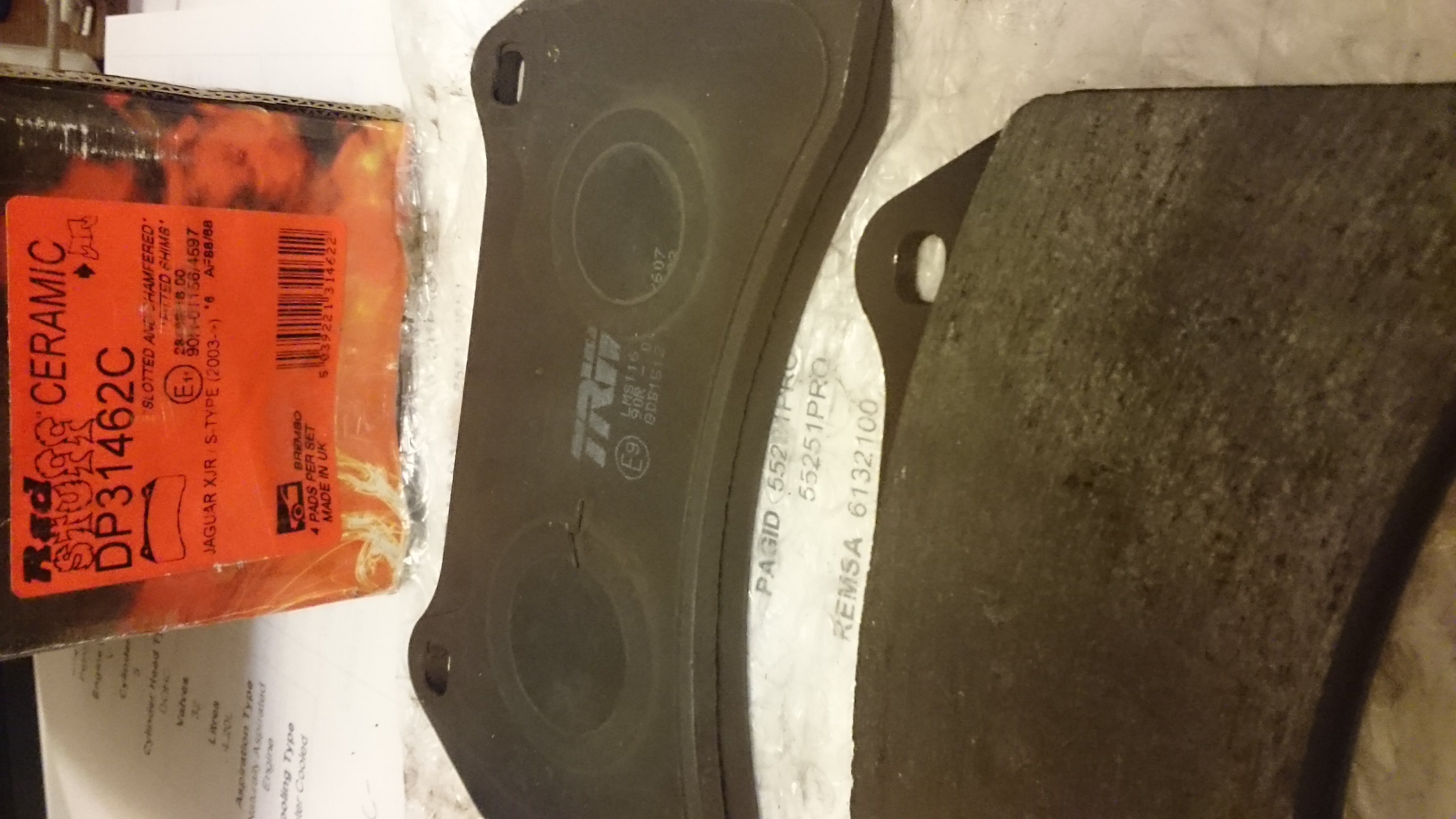

Originally Posted by jya
I came across this vehicle parts data base that I am sure many you know about, very interesting and worth a look:
JAGUAR S-TYPE Saloon Parts
I was looking to buy an original Brembo part pad which is available and I assume was never made by Jaguar. Still a bit on the pricey side on Ebay but I am now reluctant to use anything else.
The problem is I have had very bad rotor run out using the R1 Concepts rotors but unfortunately with a pad (English made) that seems to be too hard for the rotor which I sourced from Rimmer Brothers UK - an excellent parts supplier but the combo of that pad and rotor was disastrous!
I will now be on the 3rd machining..I assume the pads being too hard and causing the run out but cannot be sure. Maybe a higher friction pad? How can I tell as most of them claim they are high friction and hence the need to try a genuine Brembo pad. Another issue I can see is they are not Brembo rotors anymore and I cannot be certain that combination will be correct as well??
Here Is the Rimmer Brothers link:
http://www.rimmerbros.co.uk/Item--i-GRID300004
I finally removed the 'standard' spec TRW front pads I had installed in combination with the R1 Concept (slotted) rotors I ordered; from California I think. After a few smooth months of driving I started to get very annoying steering wheel shudder. Very odd and as per photo these TRW pads had really had very little use. So lightly machined the rotors again and tried another brand - this time EBC Red Stuff pads. Seemed okay for a couple of weeks but the wheel shudder is back..Only light now but still annoying and if last time is anything to go by it may get worse.
Not sure if it just build up or if the pads are causing run out/warping on the rotors? These mechanics I used never bothered to measure if any runout; just machine and back in..
The vehicle has low kms and this was my first rotor replacement. This was never an issue of course with the factory original rotors and pads.
Dont know if these R1 rotors will take any more machining as I did not manage to measure the front rotors to see if they were on the '30mm worn brake discard thickness'.
So not sure what to do from here? There seems to be no rotors to buy in Australia that are locally stocked/off the shelf, everything needs to be ordered from OS. Unless of course if I go to the local dealers! Its been expensive just ordering 2 lots of brake pad sets..We are not as lucky as you lads in the USA with lots of local options available.
Any input welcome!

Old May 3, 2018 | 06:14 AM
  #31
Cambo's Avatar
Joined: Jan 2011
Posts: 8,637
Likes: 4,526
From: Sydney, Australia
I've had R1 Concepts slotted rotors and EBC Yellowstuff pads on my Brembo equipped XJR for 45'000kms now, no shuddering, no issues at all actually.
So I don't know what to tell you.
Old May 3, 2018 | 06:55 AM
  #32
jya's Avatar
jya
Joined: Aug 2008
Posts: 629
Likes: 175
From: Melbourne Australia
Thanks for the reply Cambo. You are lucky. That's a pretty good run.
Options I suppose are to try another rotor if I could get one cheap enough locally (preferably European or US made) or try another pad. Some of the higher quality pads seem to be dearer than some of the rotors! Hard to find a 365mm rotor locally. Will try the mechanic first see if they have any answers.
